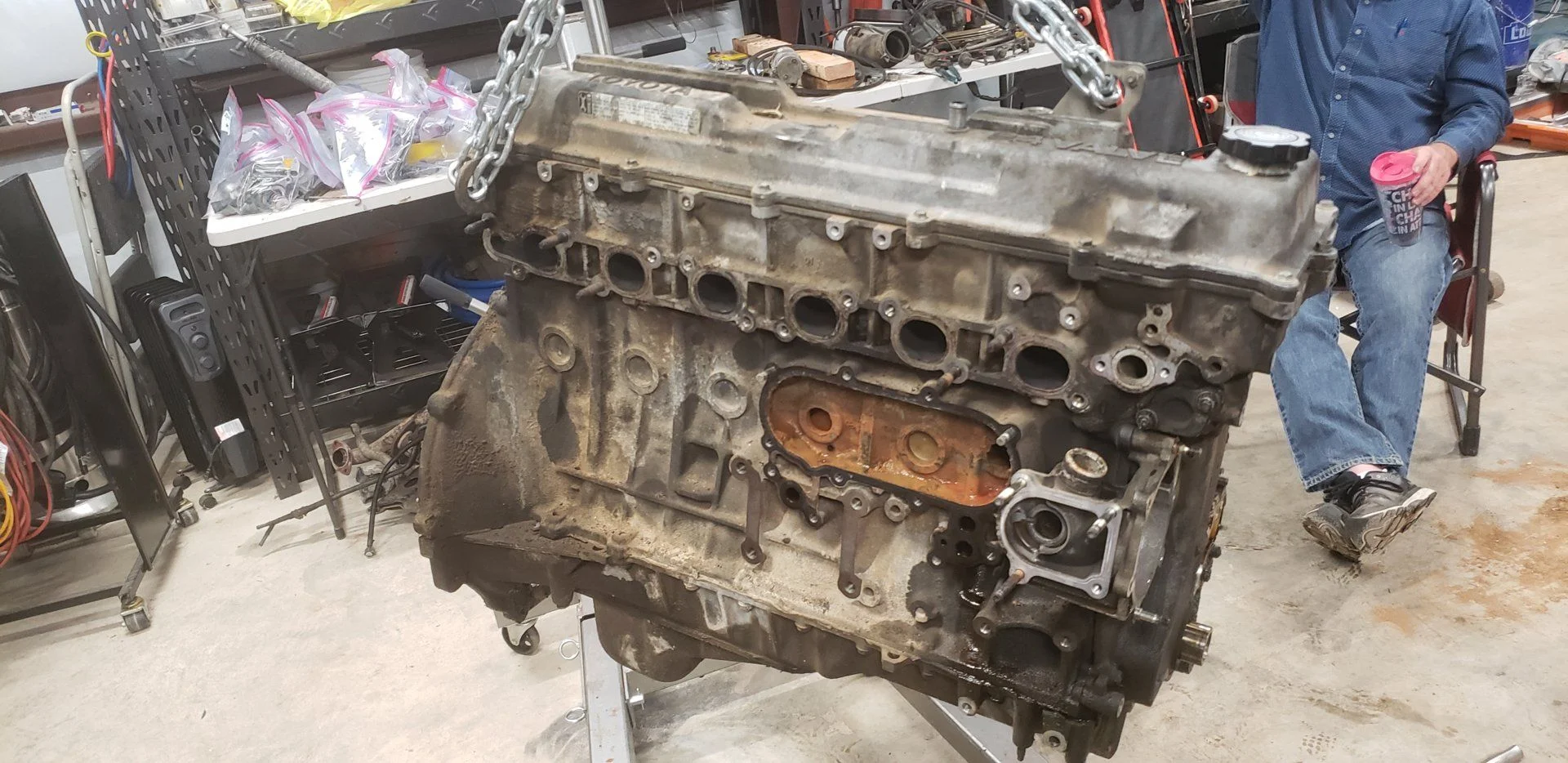

Got everything stripped off of the engine. Off to the machine shop next week.

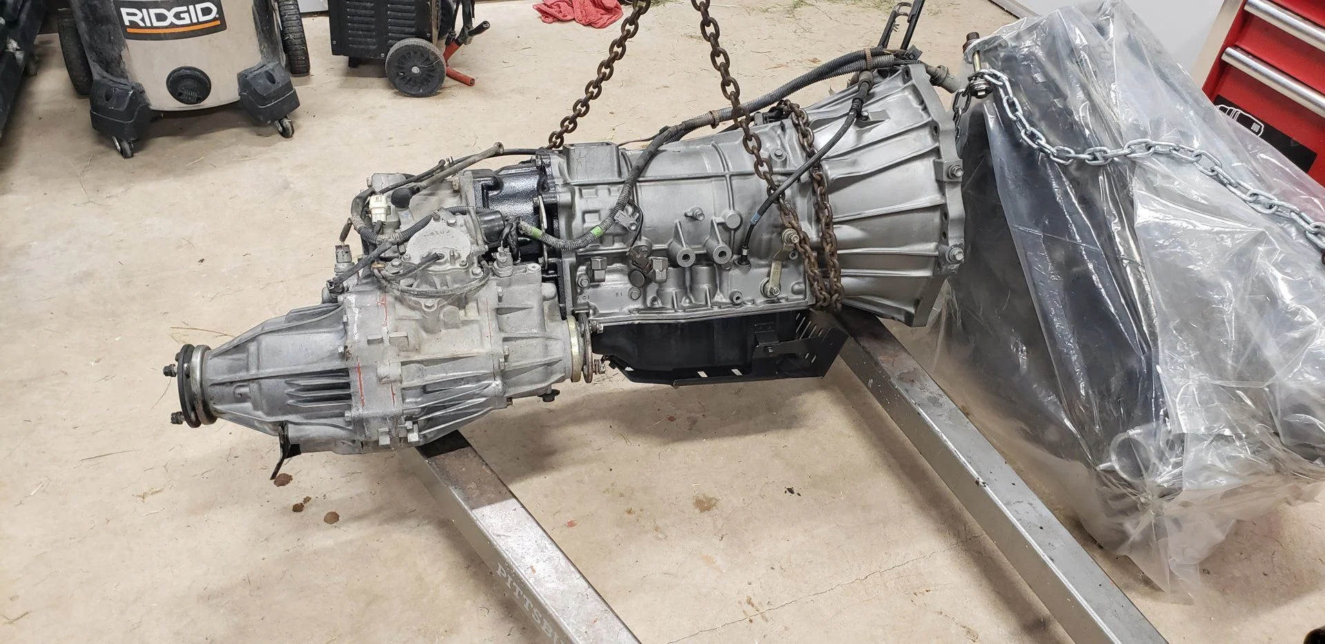

I'm really excited to get the engine and transmission back. It hopefully will last another 20 years.

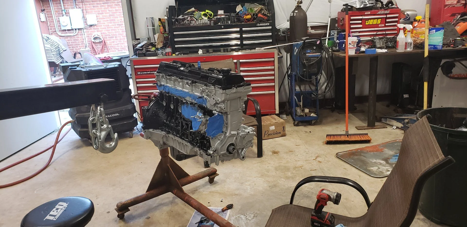

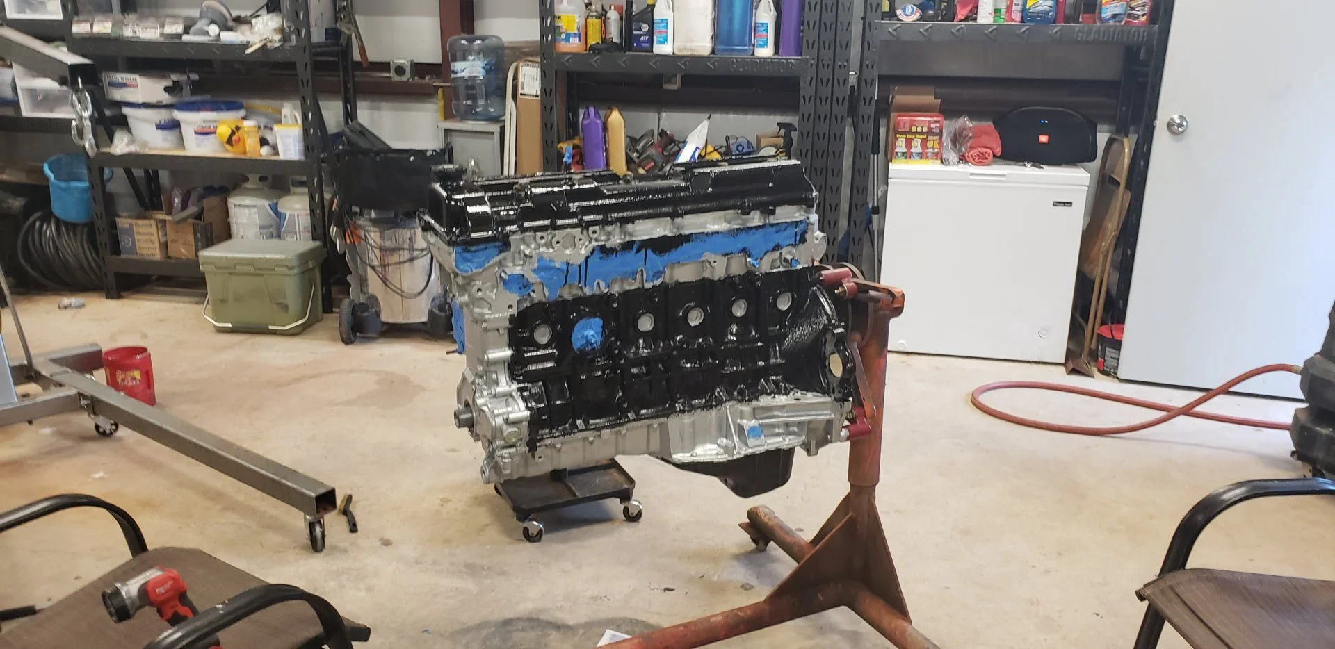

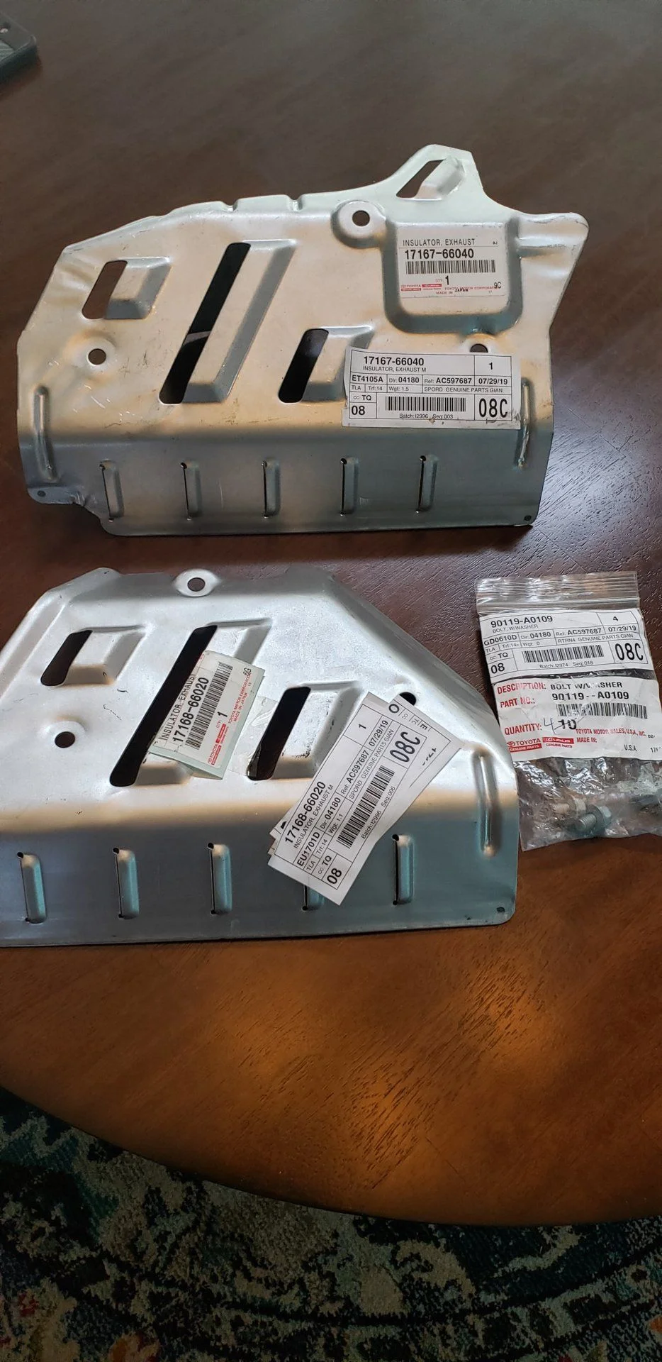

Engine is back from the machine shop. Should have the transmission back in a few weeks. Already cleaned up the intake and throttle body, replaced all vacuum lines, replaced injectors. Waiting on fuel pressure regulator, fuel vsv, evap vsv, tvv then I will paint, replace injector clips, repair harness and reassemble.
Parts are trickling in.
Very nice.

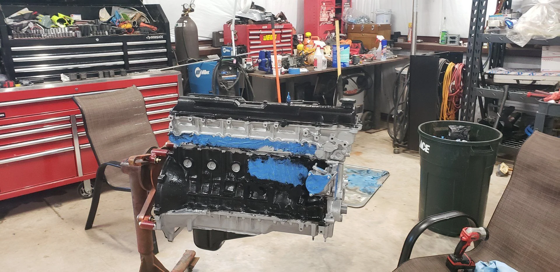

Paint is 95% done. Will touch up seams with a fine brush in the AM.
That Portacool....is probably the most important 'tool' in the garage right now. Getting pretty hot out in West Texas by now I would think.
It's sweltering here....and I'm on the opposite end of the State.
Mighty fine job you are doing there.
It was 105 today and the portacool was well worth it. I used the por 15 engine enamel which was a first for me. It's a little strange because you brush it on but it went on pretty nice. I have to touch up some spots in the morning but overall it's way better than when it came out. Lol
