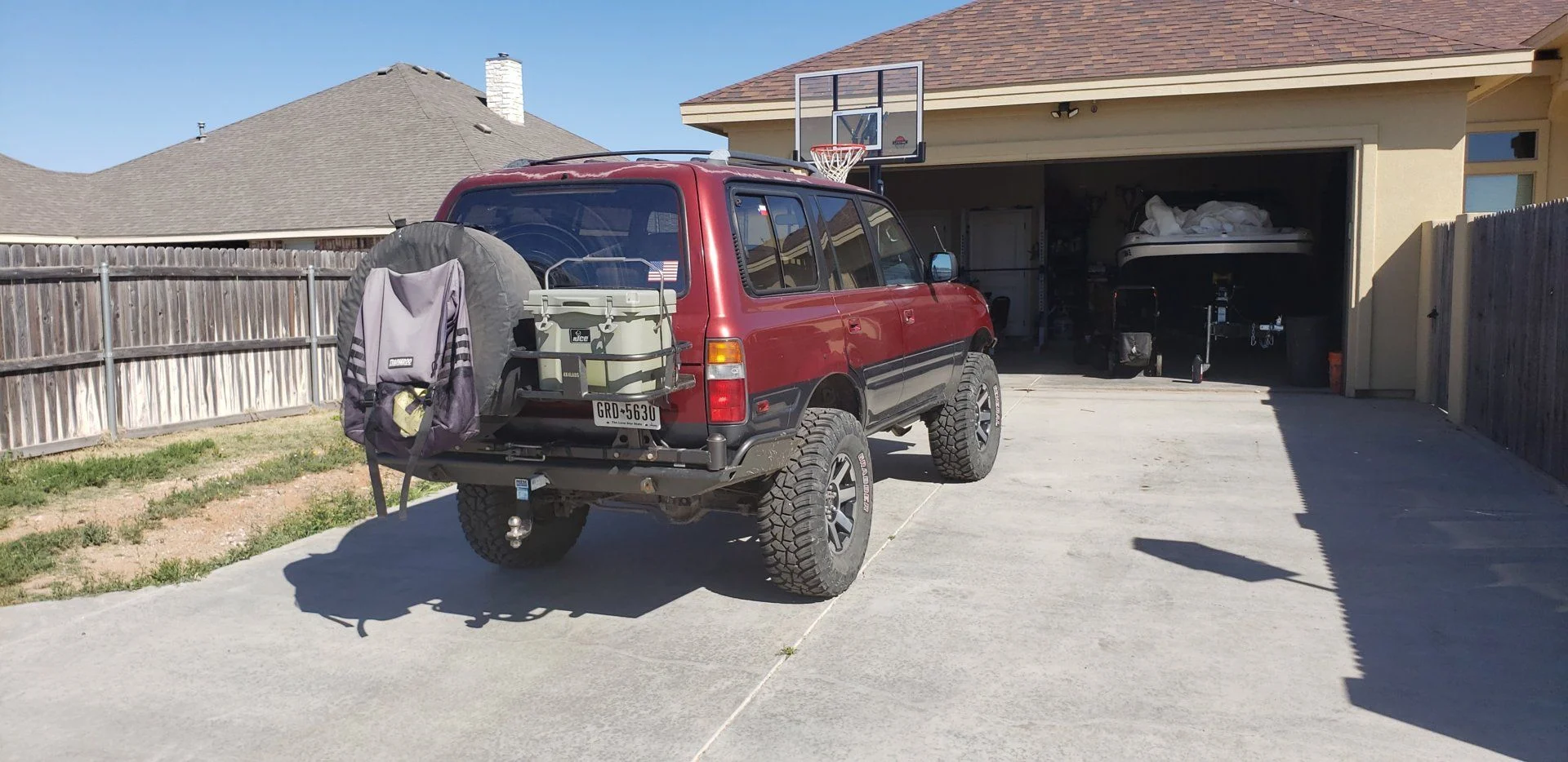

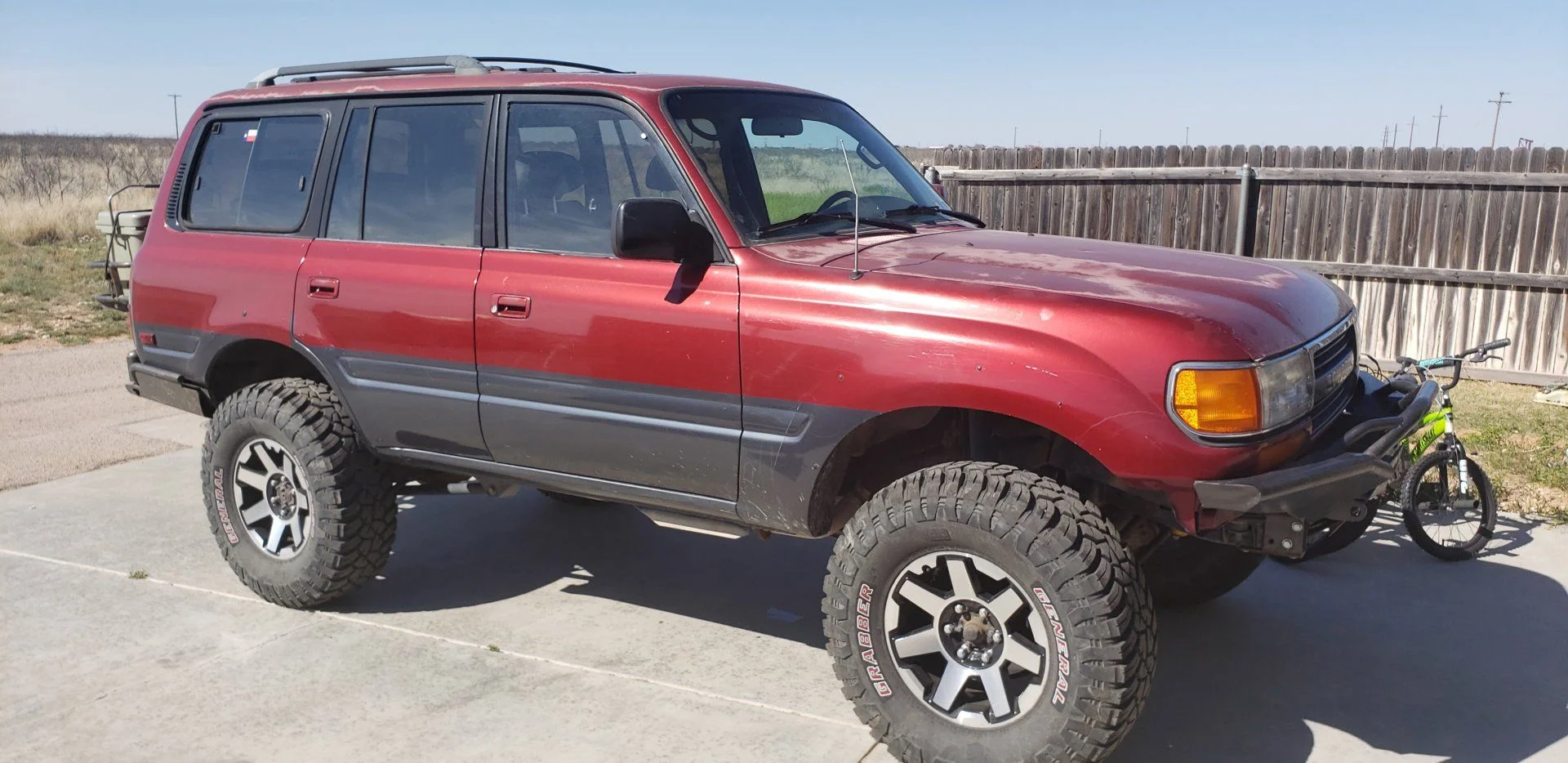

So, I have confirmed that I have a coolant leak coming from the back of the head on my 94. So now I need to decide if I want to rebuild or sell the truck as is. Honestly I am leaning towards selling as is and trying to recoup my money spent on bumpers and tires. So I am thinking maybe $3500 is the most I can get for a non locked (except Spartan rear) with 4x4 labs front bumper and rear bumper with duel swing outs, and new ( 6 month old) 35x12.5 r 17 general grabber x3s. Also have Cooper sst spare that is brand new. But part of me really wants to rebuild it. So pull head and replace gasket, pull engine and rebuild or just sell and move on to another project.
