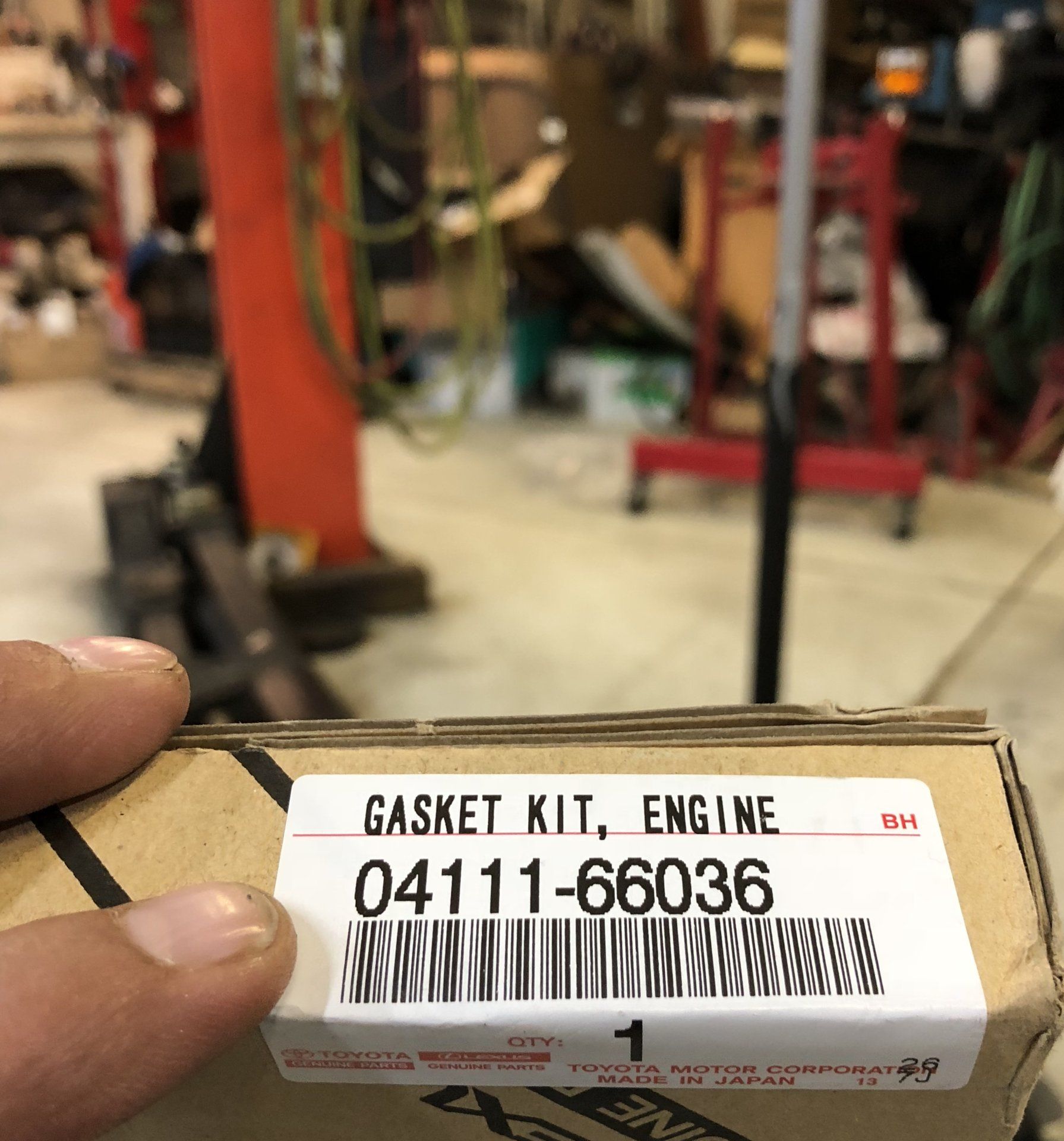

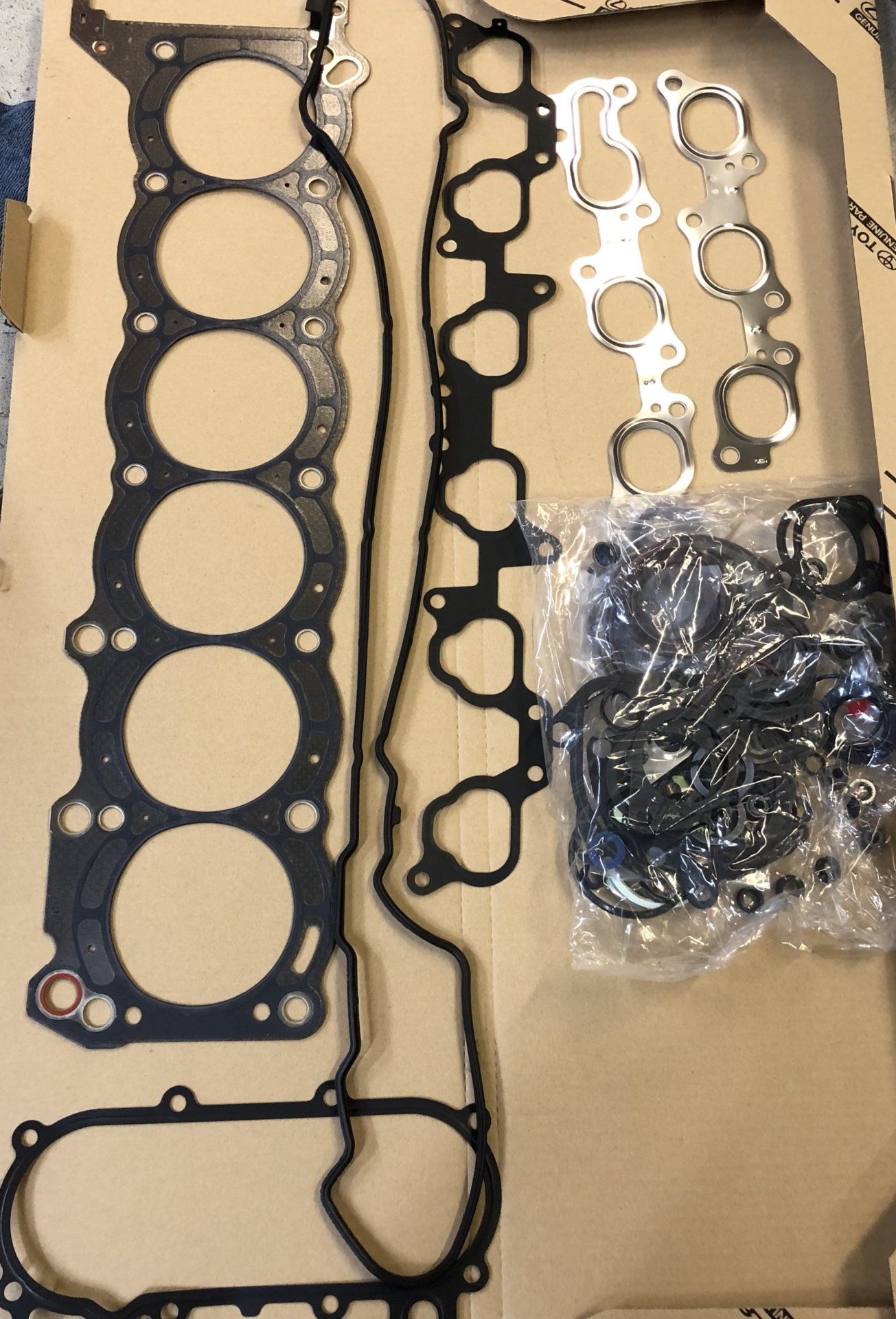

My initial thought was to go buy a rebuild kit, pull the motor, have all the normal machining done and what not and put it back together again. The rebuild kit, I can get for $679 and it includes all new gaskets, water pump, and pistons, etc, however it does not include top end things like valve springs or anything like that. However, I dont really know if or when I should change the valve springs anyway. After talking with a friend, he told me that machining costs could run me a grand or two depending on what it all looked like. So now I am somewhere near $3000 to rebuild the existing engine...all with the same (well maybe a few more) HP after all is said and done...and more than likely, not much increase in resale value (if I ever decide to sell it).
