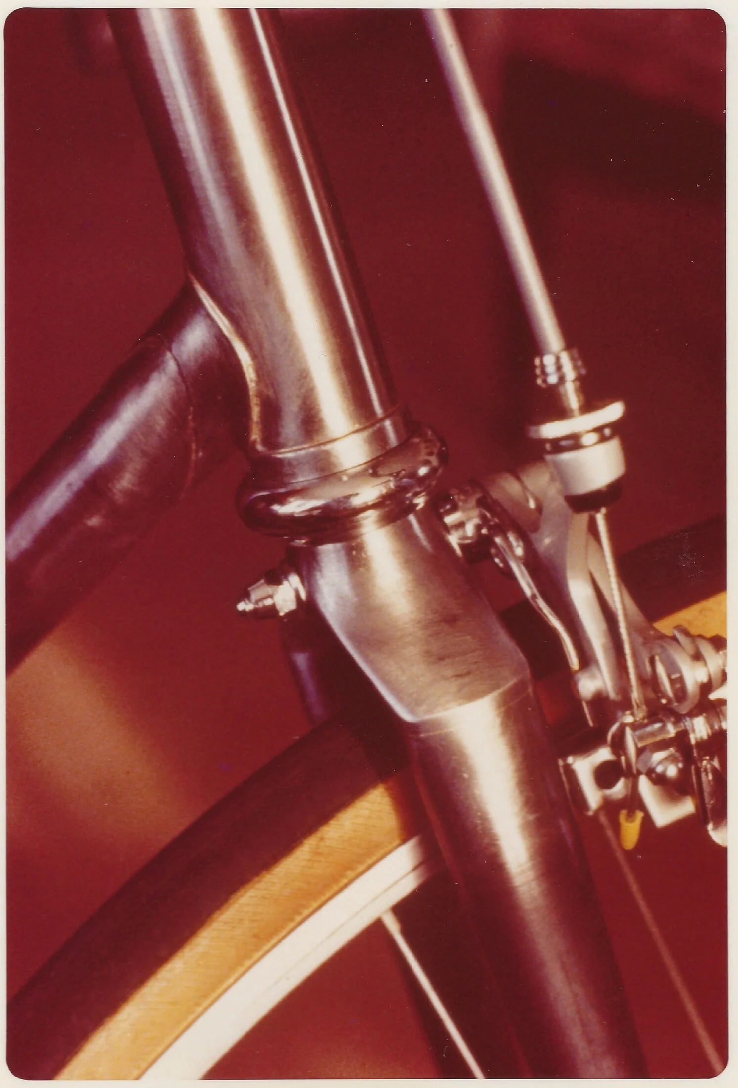

Unfortunately I only have one photo of the unpainted frame, these are scans of the actual photos:

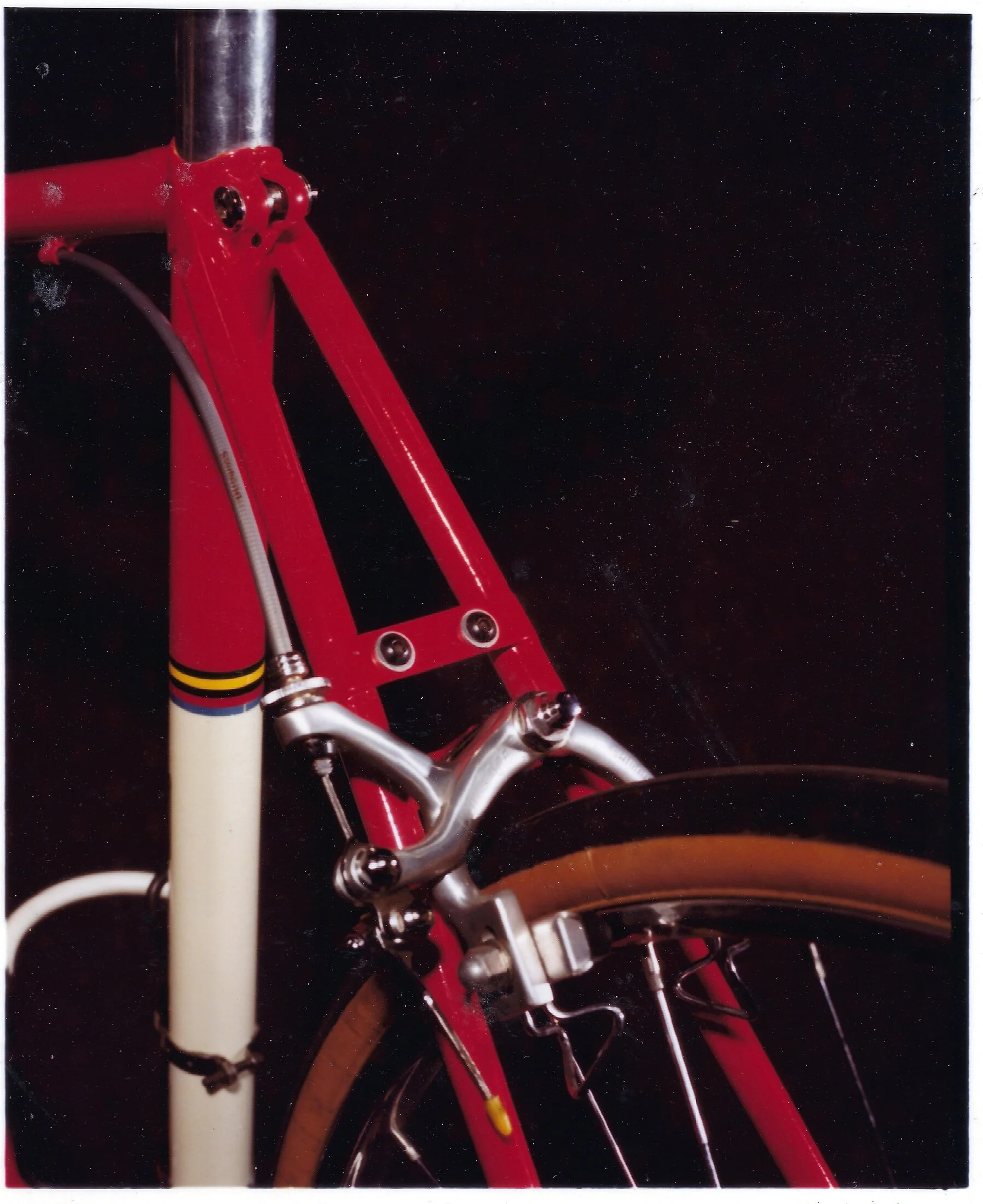

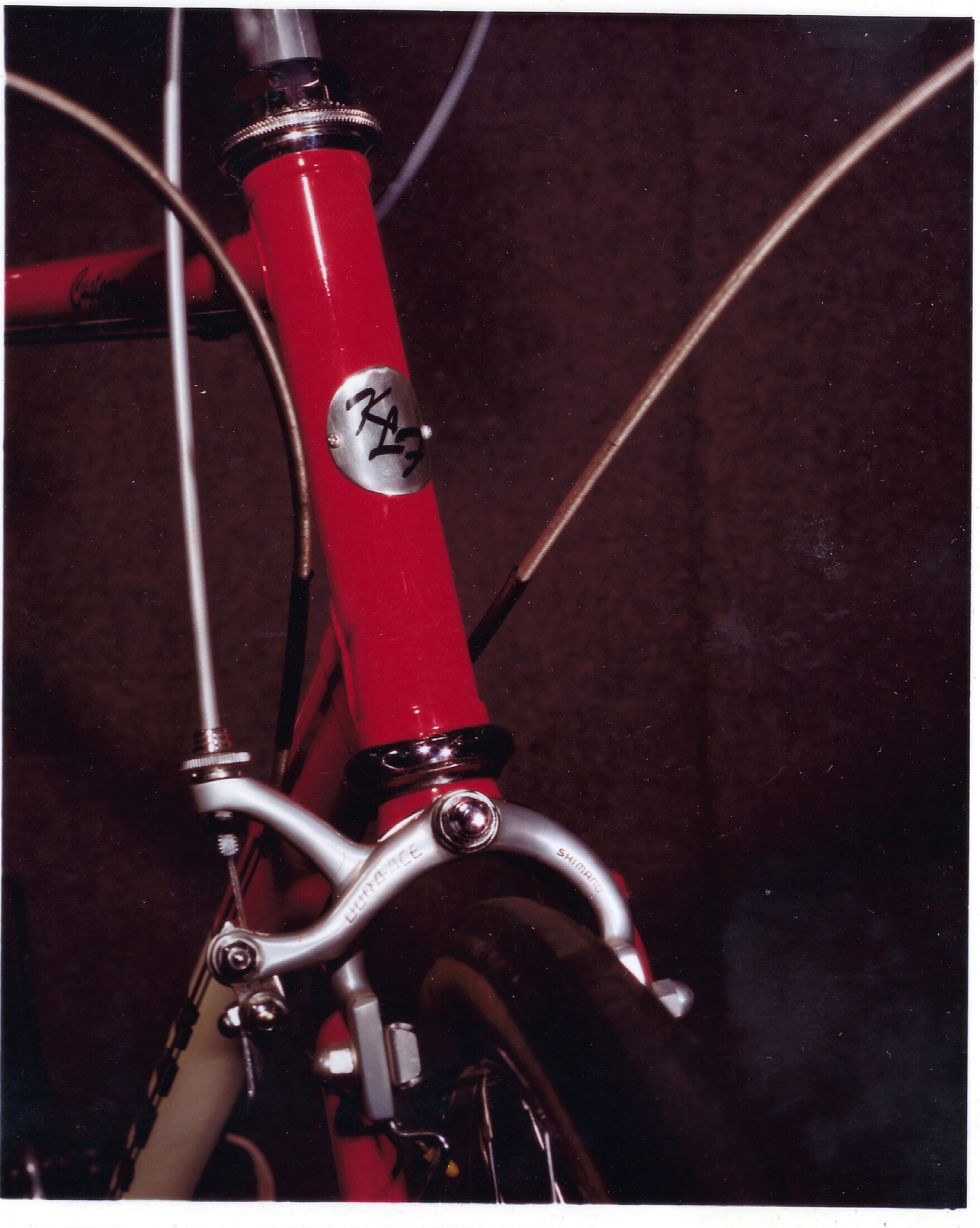

Photos of after painting:
Yup, that is a "badge" that we made for the head tube, with my initials on it.
The flat cross bar thing above the brake caliper is the mount for the rear rack. Kinda hard to see how we did the seat stays attachment, I'll try to get the bike down and get some better photos.

Amazing work. Love the sloping fork crown too. I really appreciate the photos.
