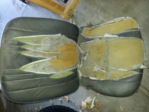

My driver's seat vinyl is totally shredded. It looks like re-upholstering just the bottom part of my seat will cost a fortune so I'm looking at other options.
The option I'm most considering is taking a different seat.. Something like an early 90s 4Runner base model (non-bucket) seat and swapping the cushion sections on to the stock bases in my BJ42. Has anyone done something like this with these trucks?
I bought a couple passenger seats for my old 4Runner and swapped the power leather passenger cushions (normally less wear than driver's cushions) on to my manual driver's side base.. But this landcruiser is a totally different animal! Any help would be greatly appreciated.

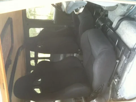

Here's what we're dealing with:
I took the original seat brackets and bolted on thick steel cross members. On to the cross pieces I bolted the aftermarket seats.
Four hours later - new seats.
Sorry about the orientation :
Your cushion doesn't look so bad... I'd see if you can just recover it, or find a passenger side cover & cushion.
I've rebuilt my stock cushions, but never used a different one.
I put seats from a 1995 pontiac firebird. Took a little creativity to mount on the stock frame but works.
i dont know what expensive is but by the time you screw around and try to mount something in there you will probably spend more money trying to save money.i used complete audi seats before and they were the best fitting seat i ever fit to a cruiser .

Those seats look to be in good shape other than the cover. There are a couple venders that sell replacement covers. I just did some seats with Cruiser Corps covers that came out nice. Maybe contact one of them to see if they would just sell the bottoms.
I also made brackets to mount some seats out of a Saab that I picked up in a parts truck. I put those in my 74 with a fiberglass Mallotte body. Had to be careful on the leg clearance above the knees to the Steering wheel. Took a lot of test fitting to get right.
The replacement covers were by far the easiest to do, and that's with me never having done it before. The brackets were made using the OEM mounts.
Definitely don't get rid of those seats. You can get good money for seats in that condition.

Thanks a lot for the insight there. My passenger seat is in excellent condition (basically mint) and the damage to the driver's seat is completely isolated to the base for sure. I'm going to do as you suggested and get in touch with Cruiser Corps. You never know until you ask that's for sure. In the mean time, I've also put posts in on different local forums asking if anyone has a spare seat.
I am a HUGE fan of the look of the stock seats. But I'm a musician....... That's my job... My only income... So... If that's not an indication as to what my budget is like, I don't know what is, haha. I have a good relationship with a local auto wrecker who'll sell me other seats for around $30. So the other option I was leaning towards was installing other (more comfortable and untorn) seats until I could afford to recover the stock ones.

I used Hyundai scoupe seats in the front and a Dodge raider rear bench (fold and tumble).
The scoupe seats are a little too reclined for my back so i shimed them.
Just got Hyundai Accent seats in now, got rid of the brackets and made new holes (i have an aqualu tub) for them but looks good.
the audi seats welded to the stock brackets and bolted tight in wish the hell i could remember s***
