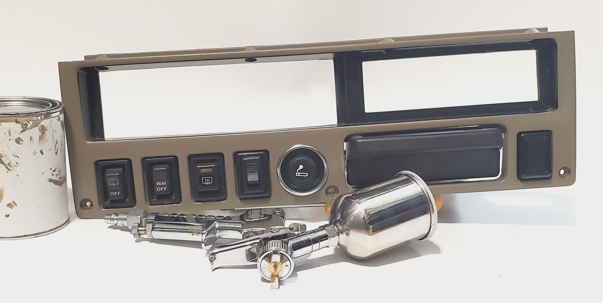

I could make an FJ62 ash tray switch panel, but not without cutting into the bezel as the Carling switches and Toyota switches are just too tall. It would be possible to do with smaller pin switches or those small toggle switches.
And yes I am selling ashtray replacement panels for the FJ60 at : FJ60 Solutions by FJ60Solutions on Etsy - https://www.etsy.com/shop/FJ60Solutions
-Chase
