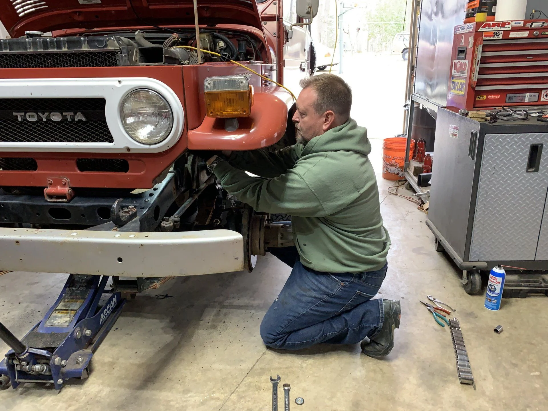

More to come but here are a few of the work crew hard at it and our well-earned feast.

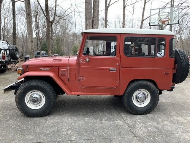

Here is a before picture with the 40 loaded down with the new lift kit and some tools.

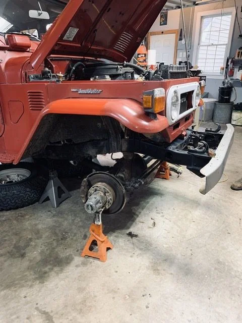

I arrived early and Dave and I jumped right on it. If I recall correctly, we had mostly disassembled the front when @forrest5000 arrived. We needed Dave’s air chisel to get to the u-bolt nuts as the plate evidenced my poor off-roading skills. We only broke one bolt when removing a pin and we only used the saws-all on one pin.
With Eric’s help we got the front end wrapped up. Eric joked it had the perfect Carolina Stance (aka Carolina Squat) like we see far too often on trucks. Then it was time to order dinner. We were thankful to have set up in the garage as it began raining at some point.

Once the new shocks were installed, we put the tires back on, Dave tightened everything down, we lubed the greaseable shackle pins and called it a day. As hoped for, it sits a good bit higher.

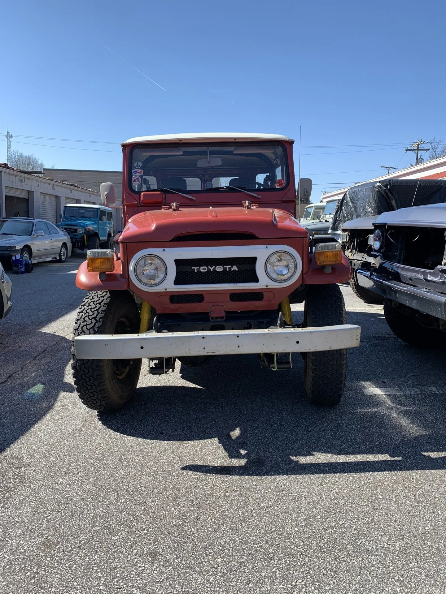

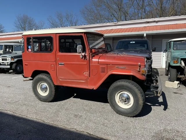

It drove well on the way home and this morning I drove it mostly highway and interstate miles to @Trollhole’s shop for the electric assist steering upgrade, new tie rod ends and the installation of the new steering stabilizer.
It handled well in my opinion and I didn’t think the ride was terribly stiff or bouncy. Below are pics from when I dropped it off where you can hopefully better see the new stance.
