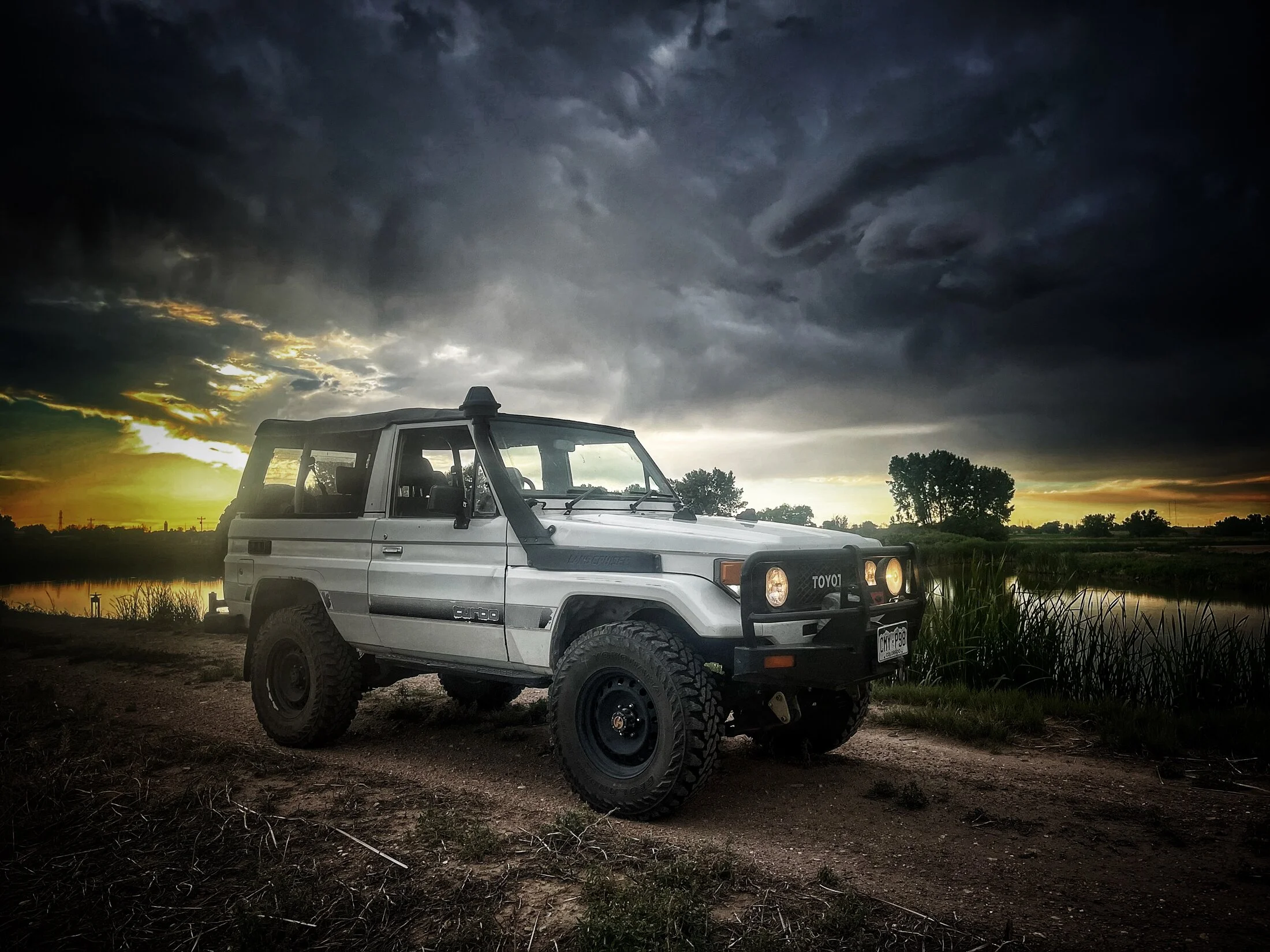

Pictures because everyone likes pictures.
