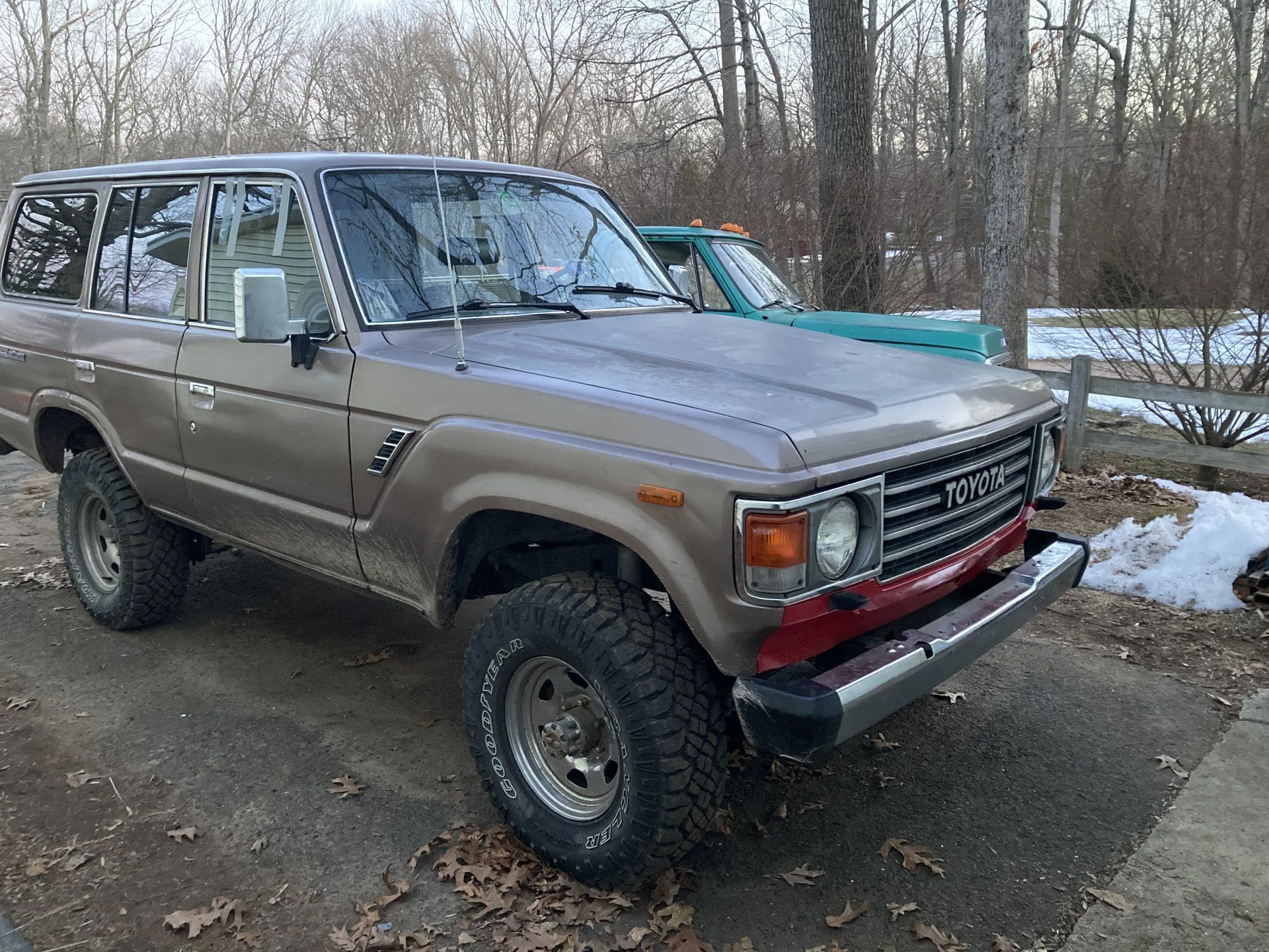

that’s too bad the duratrack is being phased out. i really liked them. i use them studded as winter tires and they’ve been great. i actually found them quieter than my old BFG ATs. i use dick cepek fun country tires for my summer tires and they’re really nice too. way better traction than the ATs were but nicer highway manners than a mud tire.
first photo goodyear
second dick cepek
