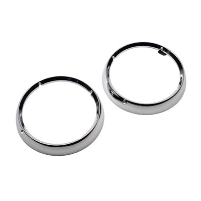

If your FJ25 is missing it's chrome light rings or the ones you have are just a ring of rusted metal, here's a good replacement. The original FJ25 ring is no longer avaliable, so I started checking into old Ford, Chevy, etc. rings to see if there was one that was close. The winner is the 1972-86 Jeep CJ7 Headlamp Bezel. It is the same diameter, and has exactly the same outter curve. The main differences are the inside of the Jeep ring has a sharper and slightly longer beveled edge, where the 25 ring has a more rounded edge. The Jeep ring is missing the clamp style tightening screw at the bottom and is fastenened with a machine screw going directly into the bib. To use these rings, you will have to drill 1- 1/16 hole into the bib at the bottom of the light ring and secure it with a #6 sheet metal screw.
