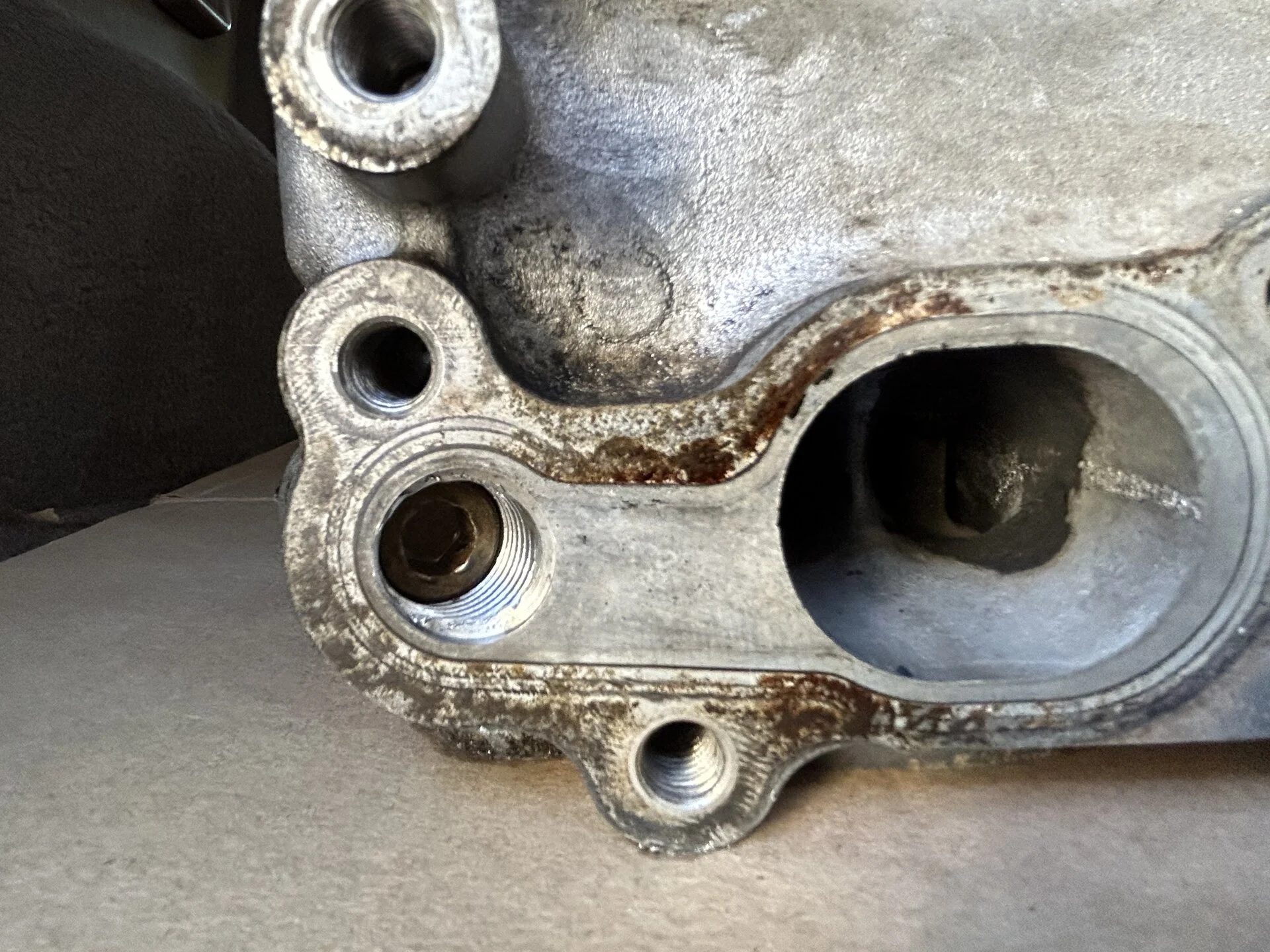

I did it all to mt 94 too long ago to remember the specifics. But you can remove the pair system. Plug the airfilter hole with a freezeout plug. Plug the holes in the exhaust manifold by moving your O2 sensors there. Keeps them dry and fixed some codes my system was throwing. There is a oem Toyota plate for another vehicles that will bolt on to where the O2 sensors were and block that right off.
EGR i used the block off on the head but i had mine off doing a head gasket as PM. I think partof the system is hard to remove with the head still on but i cant remember.
