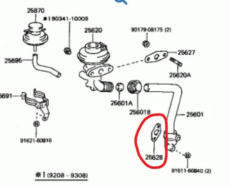

Anyone know the gasket part number? Is it possibly 25628-66010 "Gasket, EGR Inlet"?
Looks similar...
I ordered what I thought it was (17376-66010), but that turned out to be the one that goes on the exhaust manifold PAIR pipe instead.

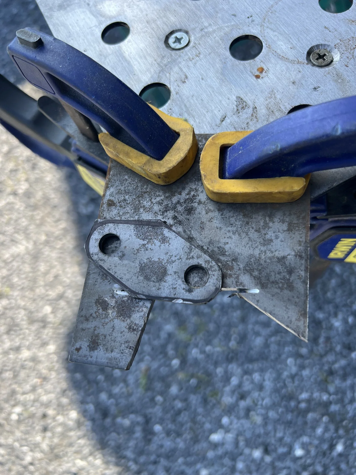

Maybe you're already aware, but I've been looking into removing this pipe too and I read that you need shorter bolts since the stock ones will now bottom out in the head due to the much thinner block off plate.
Definitely. The ones that came out were really long. I imagine a 16 or 20mm m8x1.25 jis flange bolt will work great.
As you mentioned above, 25628-66010 (Gasket, EGR Inlet) is the correct gasket for the EGR pipe (or block off plate) where it bolts to the head.
Okay, I'll do it the better way and order a gasket.

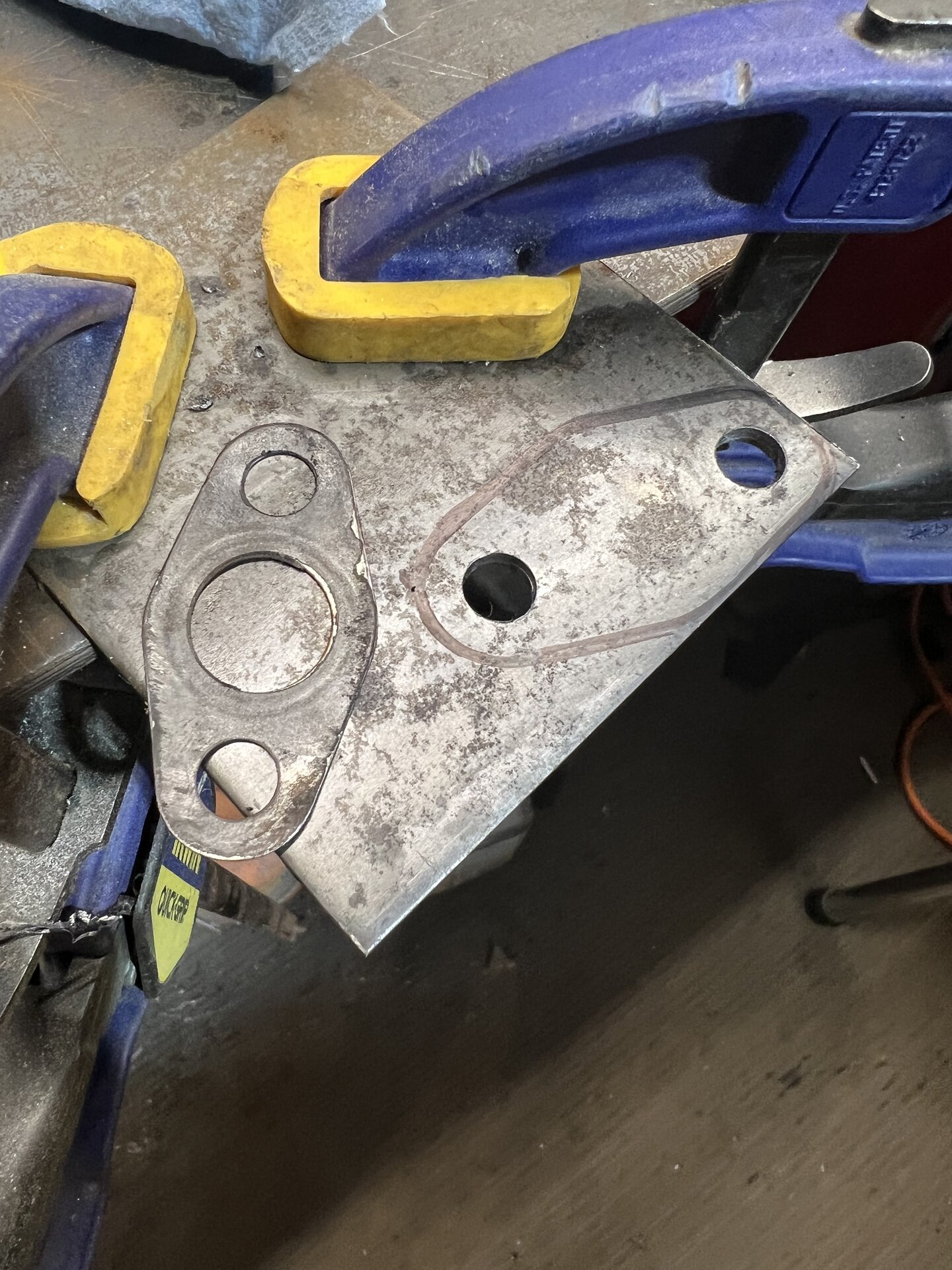

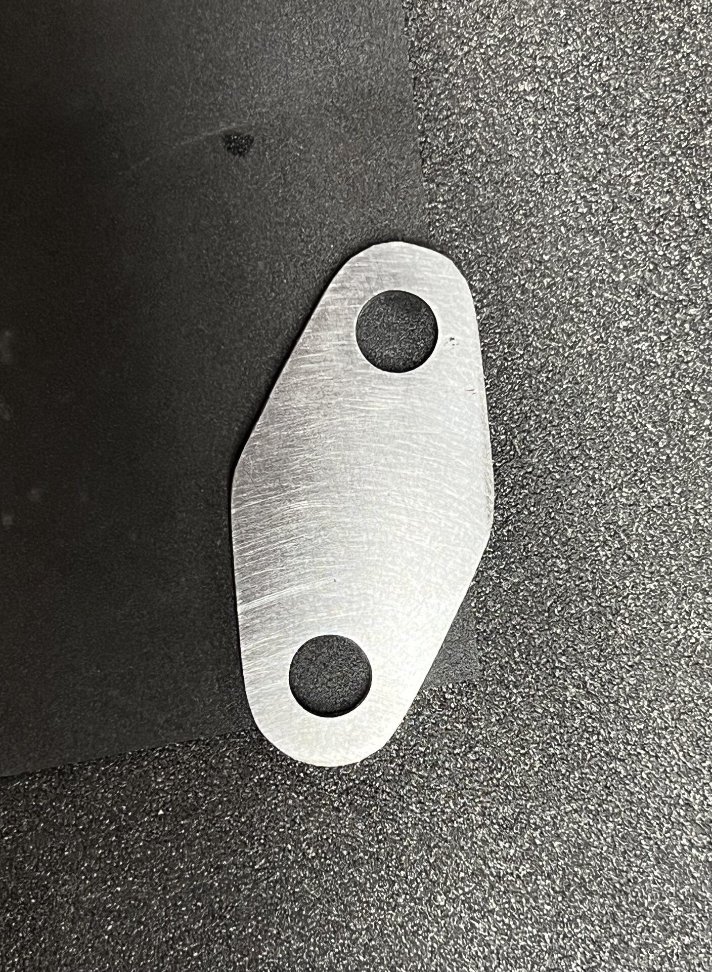

A little time with the cutoff wheel, grinder, flap wheel and sandpaper and I think we have a serviceable plate.
I could probably sand some more, but am stopping for now.

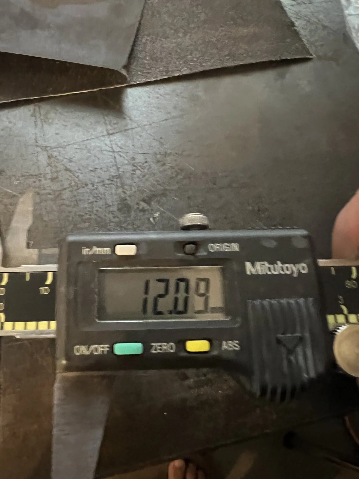

I measured the amount the stock bolts extended past the EGR pipe into the head (~12mm) and added for my (~3mm) plate. 16mm would be ideal with plate. I haven't measured the holes to see what they have available for depth. I keep 12, 16 and 20 mm on hand, so will use the 16mm.
