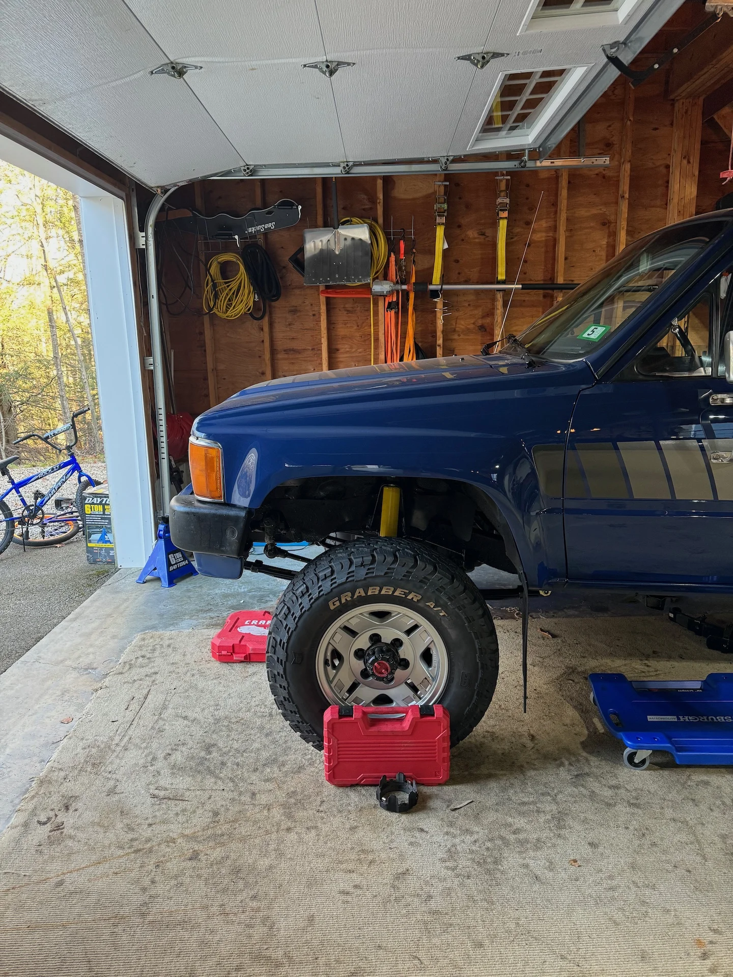

So, I received the shipment from Dobinson, and of course FedEx jacked one of the spring packs up during shipping. I have 3 of 4 springs installed, but have kept the rear end on jack stand until the last spring pack is shipped out. Going from stock (heavily sagging) springs, I'm noticing an initial 3" lift.
I was a little frustrated that they just assume you know what part number goes where. Specifically the U-Bolts. I called Dobinson and voiced my concern that a simple 1 page instruction sheet would save a ton of phone calls or frustrated consumers.
As for the installation, it turns out that having the truck oil undercoated really helped with no bolt being an issue loosening. What I thought was going to take me 45 min per corner, took 15 min for all 4 corners. I'm thinking I'll take a page out of @Manhattan playbook and go with FJ40 wheels and a nice new set of 33's.

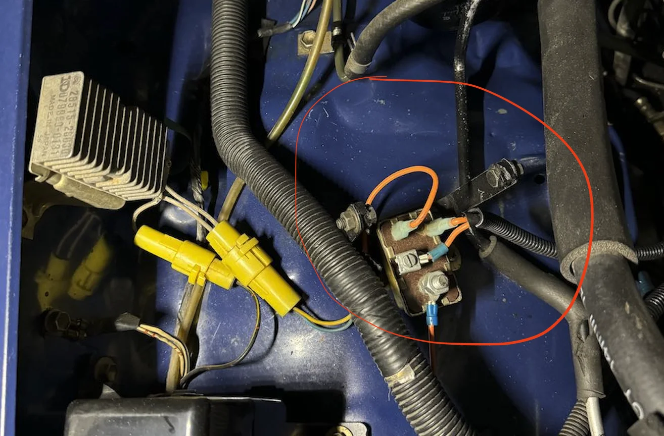

ok, so can anyone tell me what this is? I know it isn't factory and would like to put it back the way it is suppose to be. Starter Relay?
Follow the wires. Where do they go?

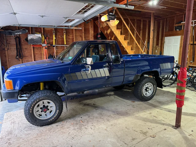

Man it's been a busy month. Between Thanksgiving and now coaching Basketball, I finally received all the correct and undamaged parts from Dobinson. After receiving a damaged spring pack that FedEx jacked up, it took Dobinson 10 days of waiting for FedEx to accept a claim for shipping damage. Apparently they were not going to ship a replacement until that was approved by FedEx, but after being persistent and having Trail Tailor bug them, I received a new spring pack.
My honest review of the lift is it appears sturdy and well built. My largest gripe other than having to wait for the replacement spring pack is that there isn't a single sheet for directions. Now, I know how to turn a wrench and replacing a spring for a spring doesn't take an education to figure out, but it would have been nice to get a document providing the torque specs. The only response I got from Dobinson was to use the factory torque specs.
The 2" lift is actually more like 3" since my OE springs were in pretty warn shape.
What size tires are you running in this picture?
I'm thinking I'll take a page out of Manhattan playbook and go with FJ40 wheels and a nice new set of 33's.
I love FJ40 rims with 33x9.5s on them (see mine below), but you have a sweet, perfect, uncorroded set of SR5 rims on that truck that are terribly appropriate. In your case, I'd leave them. But, if you choose FJ40 rims, be sure to use the stock 70s hubcaps on them.
