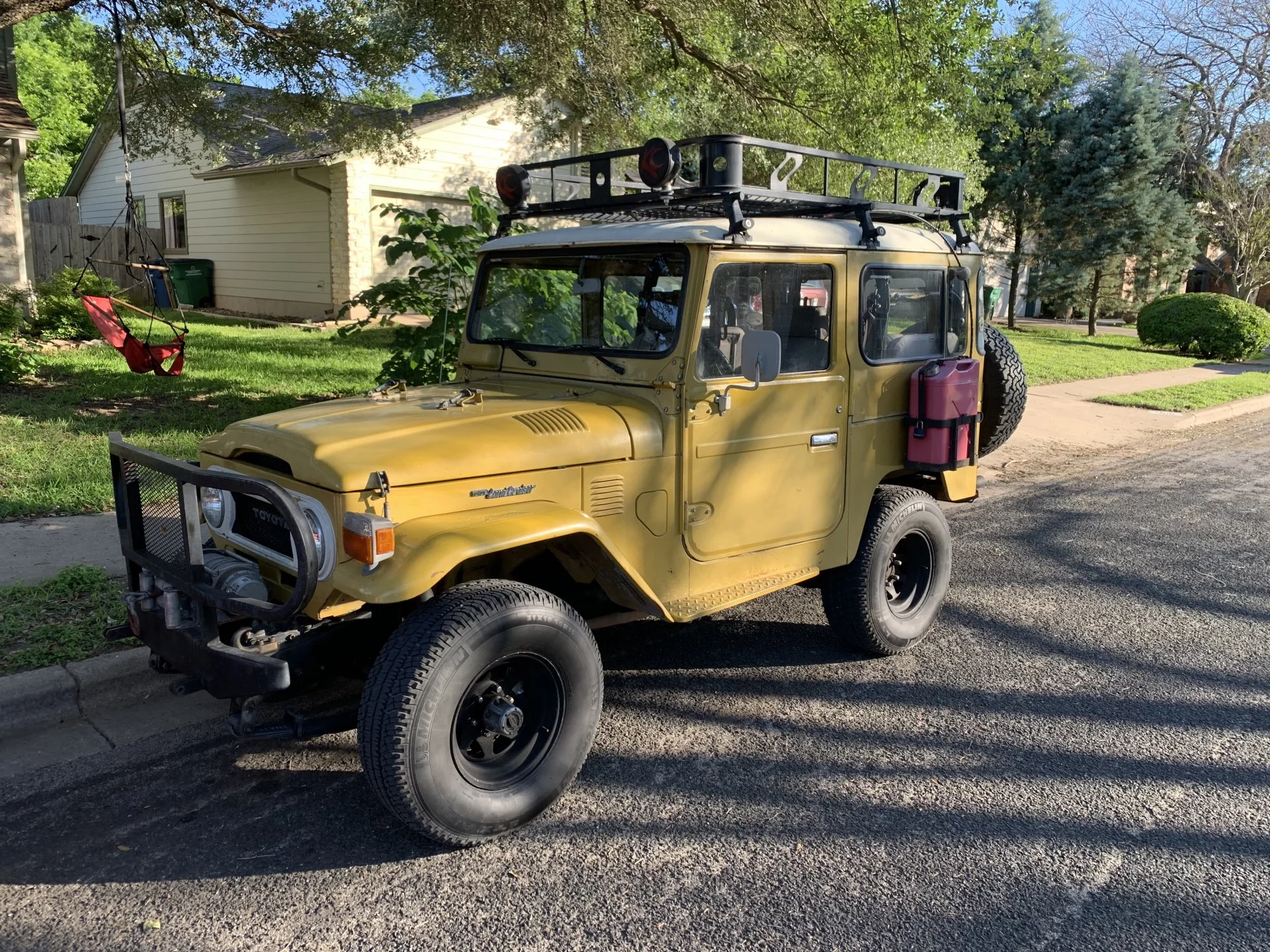

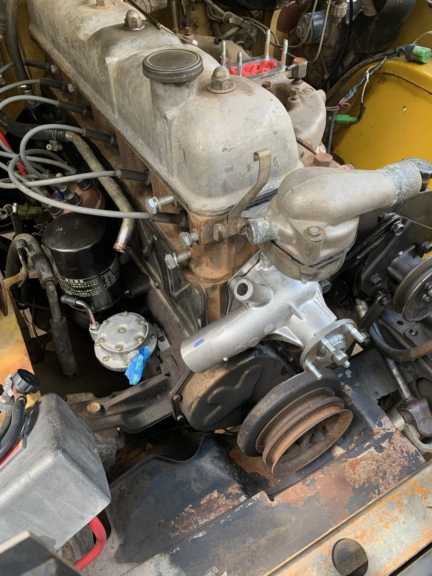

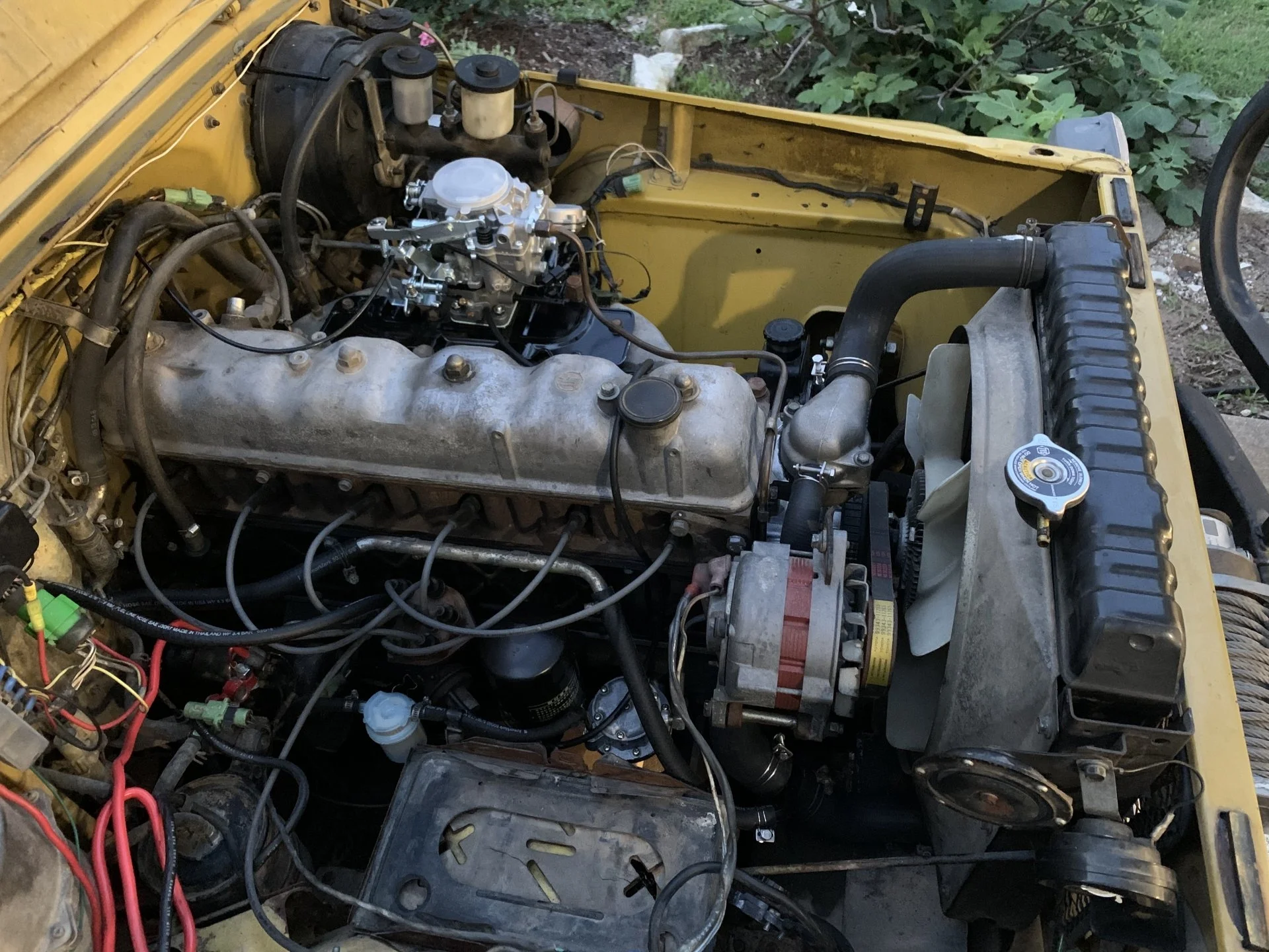

Bought my first 40, she's a 12/78. Not a lot of great history from the PO except that the previous owner to him used it in Montana for hunting. I think I made a decent buy although when I got it home I found gas in the oil. There wasn't any I could see when I did the walk around so I'm hoping its a new issue. I replaced the oil and filter and ran it enough to get it into the garage. I'm starting by replacing fuel pump, lines, and returned to factory by removing and replacing the weber carb set up. While its apart I think I'll go ahead and base line it with new plugs, wires, coolant hoses, belts and whatever else I find while I'm in there. Water pump, thermostat, fan clutch, what else?

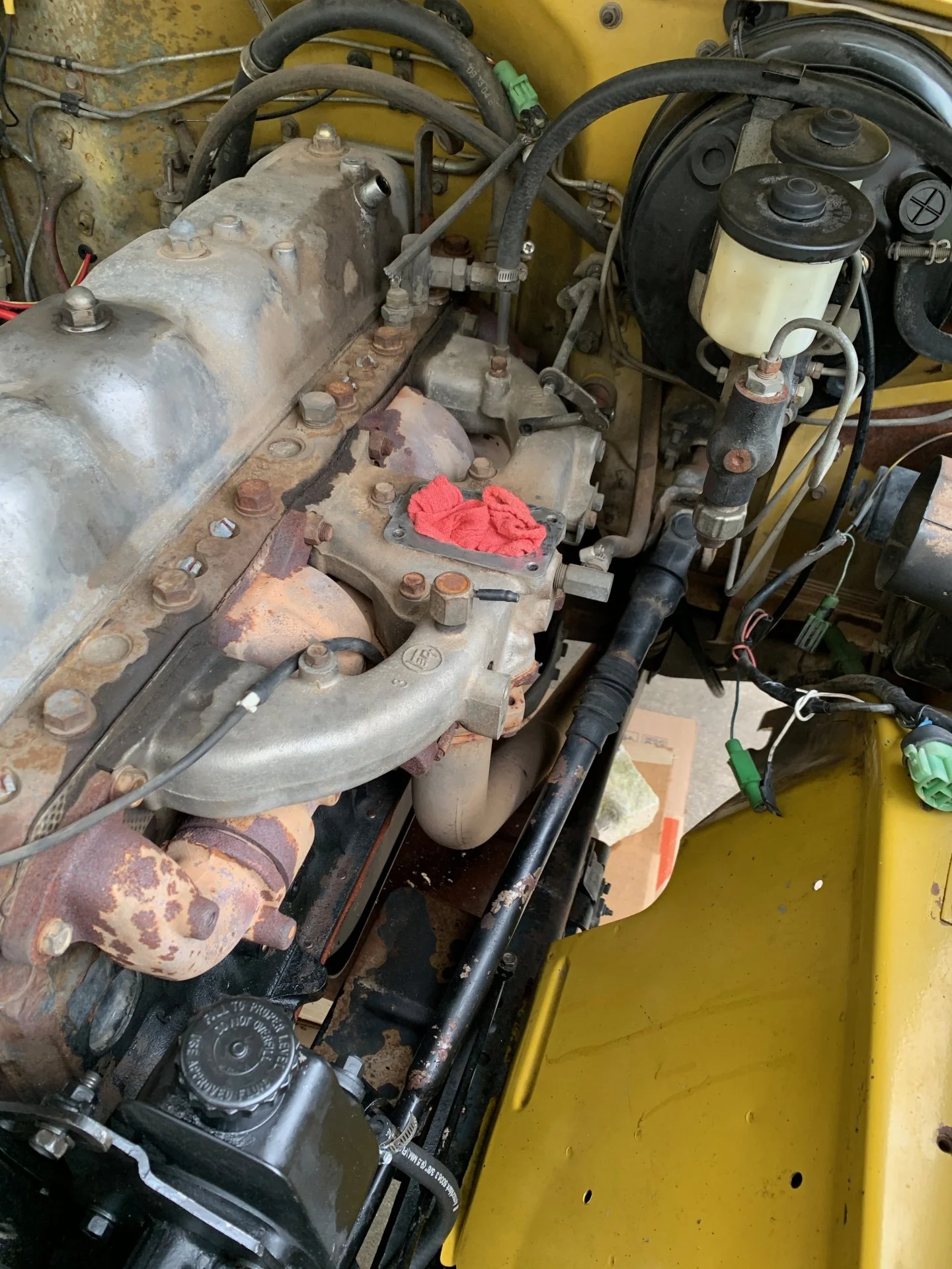

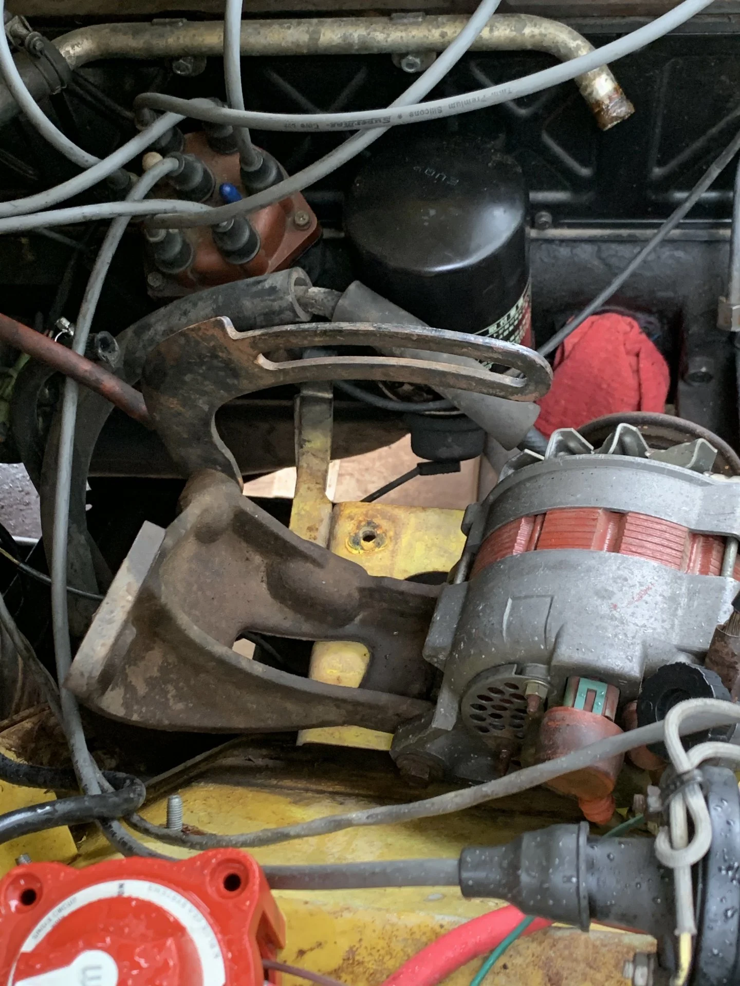

Engine bay post break down
Fuel pump out. I'm assuming that was the culprit for gas in the oil
Old weber carb delete. Waiting on parts...

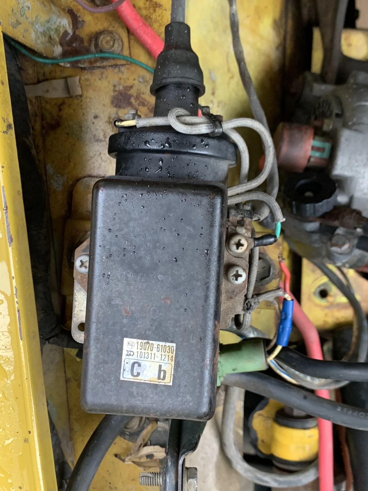

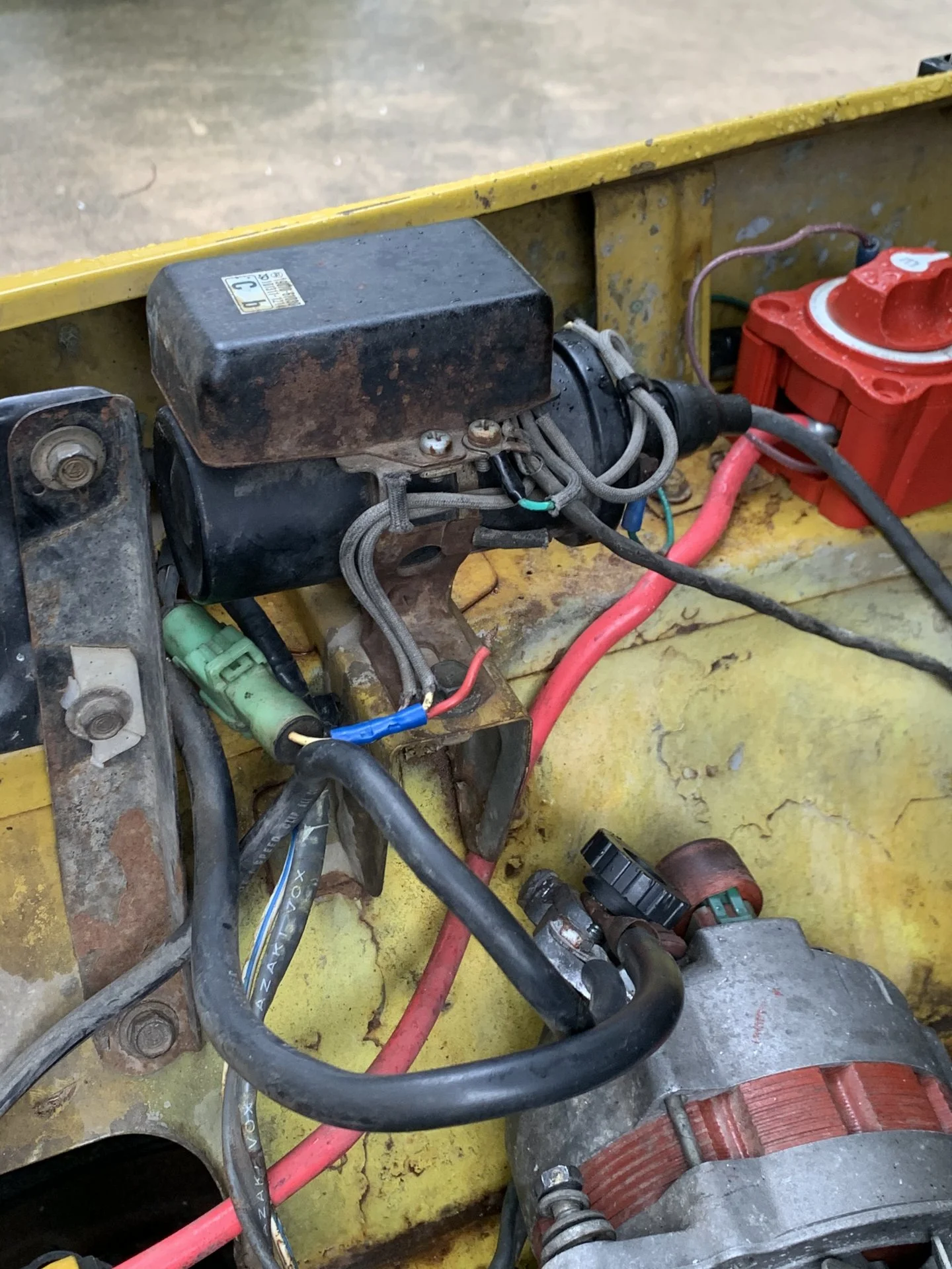

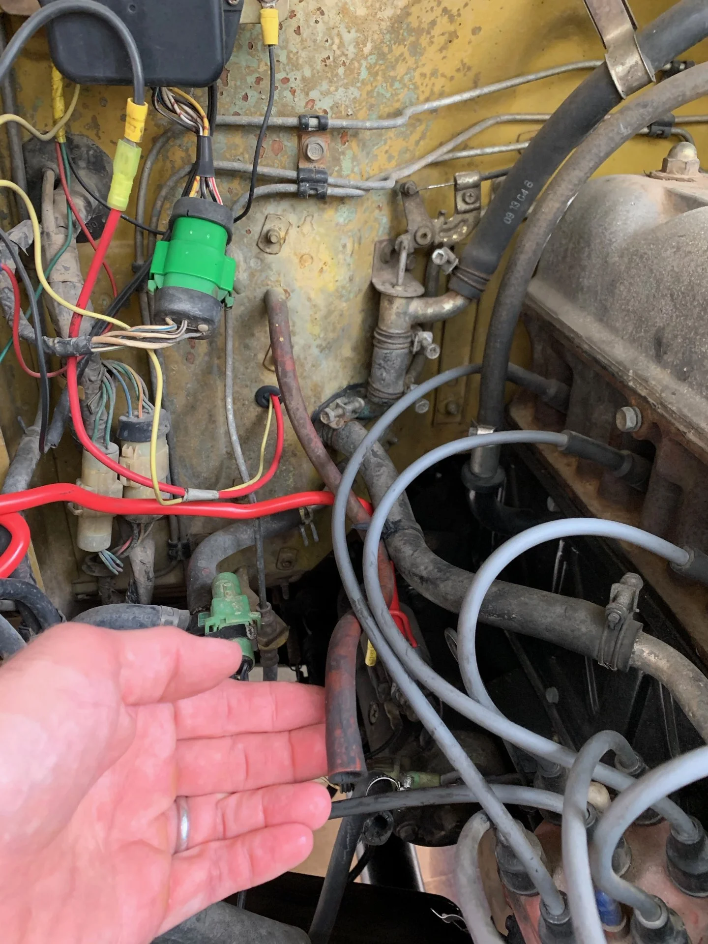

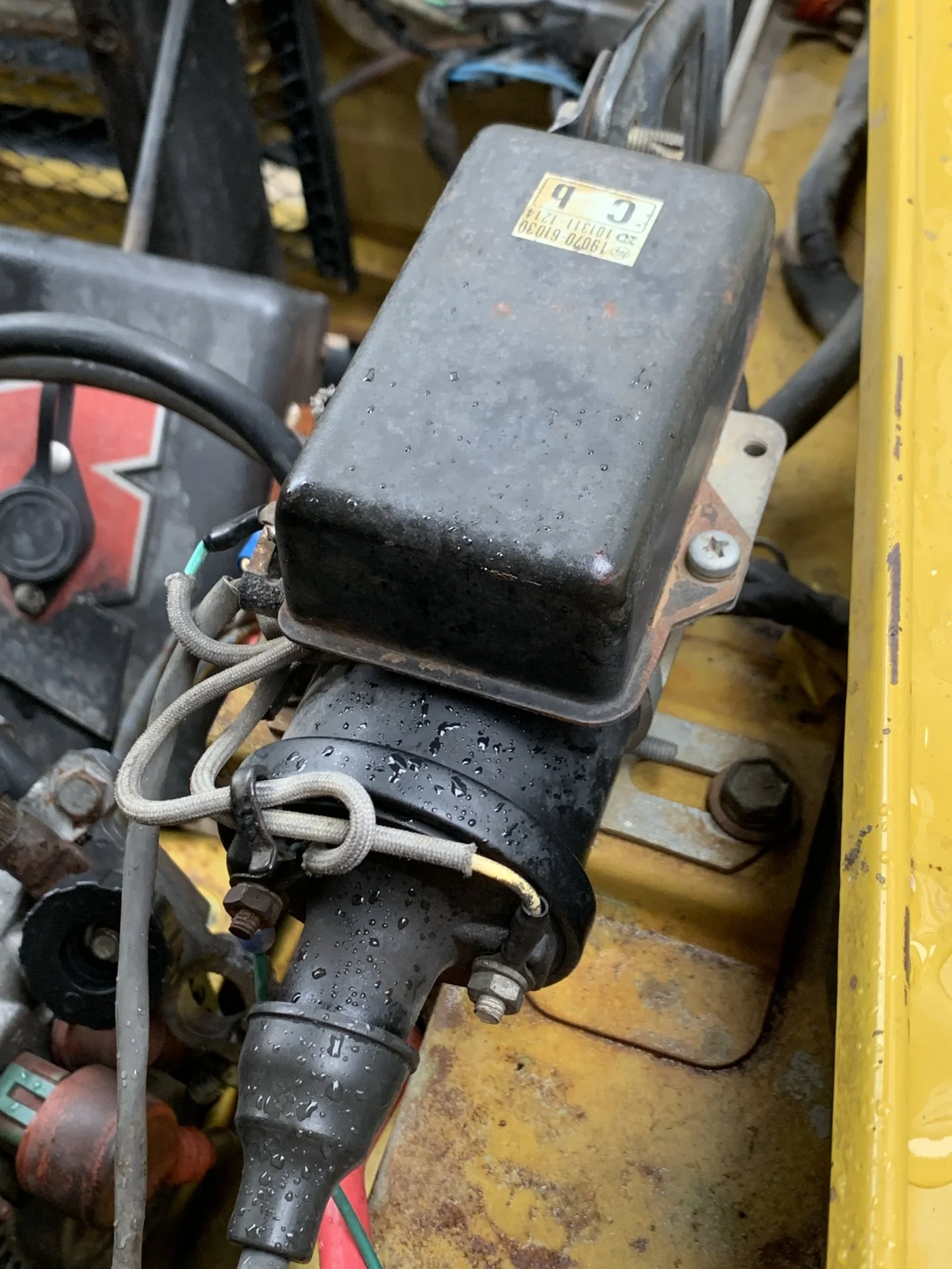

Anyone know where this red hose goes to?
I found it dangling when I starting going through things and so far I can't figure out where it goes.
It's part of the waterproofing of your distributor. There's an o-ring sealing the base of the cap and then two ports on the cap. One runs to the air cleaner (small port on distributor side) and the other to the firewall port the other side of which is a small filter in the cab. This keeps the distrib dry by always sucking air through to the intake.
Why is it disconnected? Who knows. You'll have a lot of those questions as you proceed.

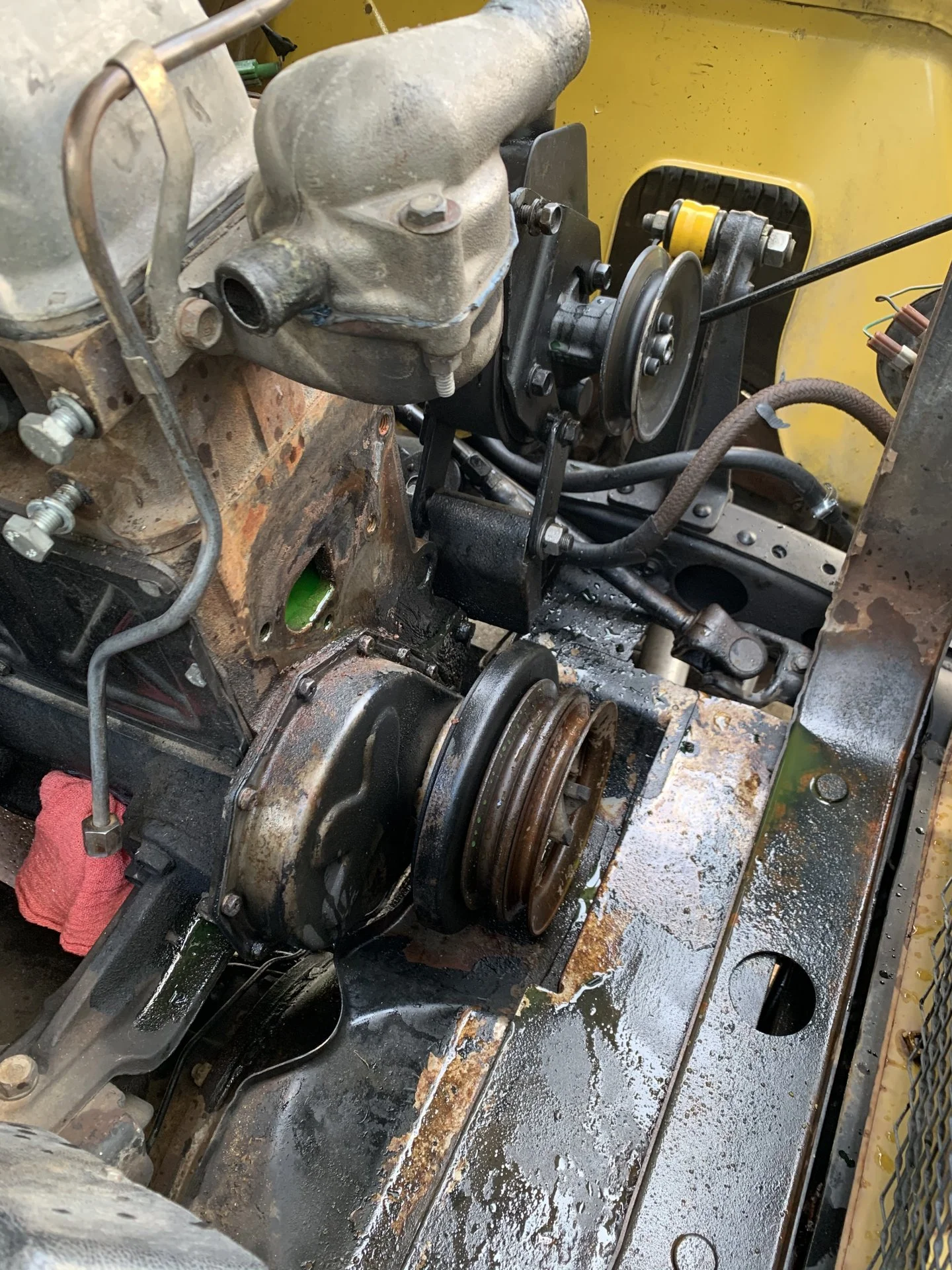

Took off the front stuff. Some good validation in there. Bearings on the fan clutch and water pump were wobbly and the belts were shot. More parts ordering tomorrow!

Then got 'er started. Sounds surprisingly good, I'm pretty happy considering unknown miles on a 43 year old engine...
