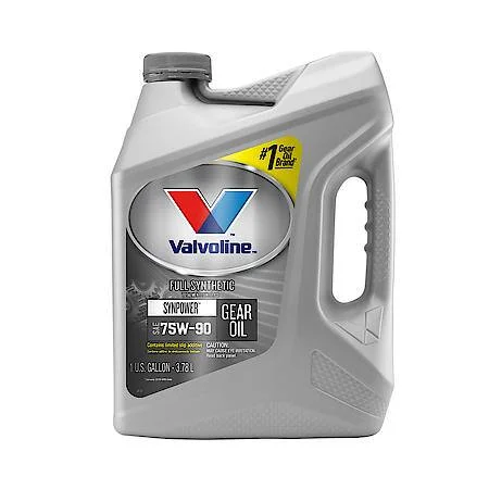

I'm headed to the beach this Saturday and am in a little bit of a time crunch finishing up my 120k fluid exchanges. Vehicle is '09 LX570 w/just under 120k. So far I've done AT fluid/filter, AHC fluid, coolant, & power steering. Looking to do front and rear diffs and transfer case before we hit the road since I'll be pulling a trailer with a golf cart. Amsoil would be my first choice but I'm not confident I can get it here in time to get the work done.
Looking at my locally available options...it's slim pickings! At the moment, I'm leaning towards Valvoline Full Synthetic 75w90. I can get it at my local auto parts store for $46/gal.
Any issue with using this oil in both diffs and transfer case? Is there another brand I should consider? Do I need to add a friction modifier?

Should work fine, don’t add friction modifier.
Toyota didn’t start specifying the odd 75wt in the transfer case til 2010, so you are clear of that change.

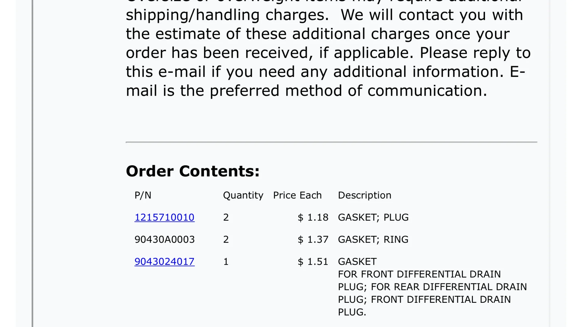

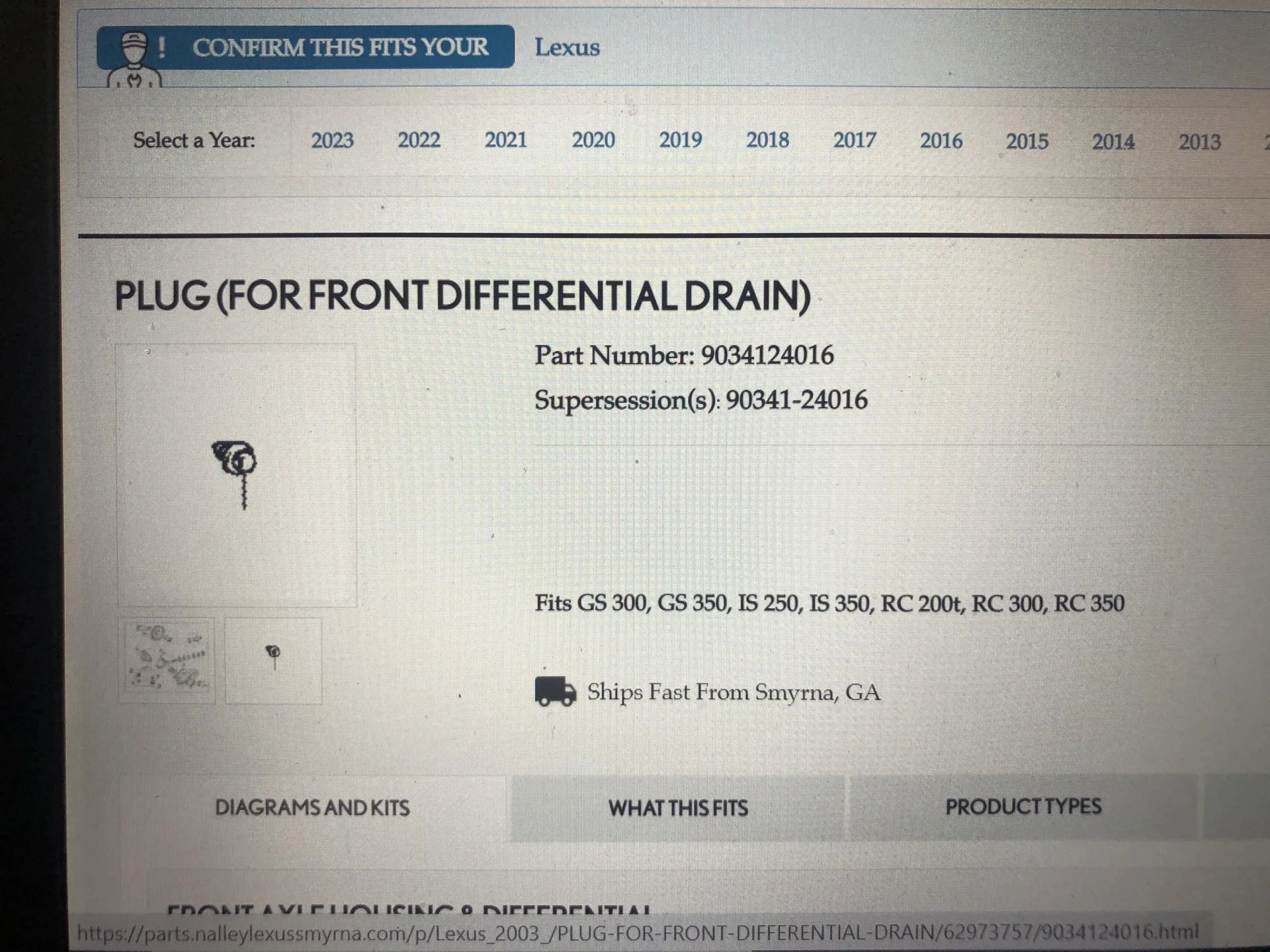

Need part numbers for crush washers or anything? Also be prepared for the front diff drain plug to give you grief. Consider upgrading to the Lexus IS plug with external hex if you have time.
Thanks, @bloc
Here’s what I ordered for washers:
Can you confirm those part #’s? Do you have the part # for the Lexus plug?

Think I found the plug part #.

think I found the Lexus plug part #. Thanks to @bjowett for posting. Now if I can just get my hands on one of his oil filter housings!!!

Valvoline is fine. I use Mobil 1 and I'm not aware of any differences between the two, other than price
I would not put 140wt in our diffs unless aftermarket gears call for it.
You need three of the first part number.. two for the rear axle and one for the front diff fill plug.
In my notes I have
90430-24003 front diff drain gasket
90430-18008 Transfer drain/fill gasket
12157-10010 Rear diff drain/fill gasket, also front diff fill
Use a torque wrench on this stuff..

Any name brand 75-90. I use synthetic, Chevron (Delo, I think) is my favorite, or M1, or Valvoline. NO limited slip additives. Fluid changed at reasonable intervals virtually guarantees a long long life.
Happy trails.
Edit to clarify, many Brands include limited slip additives. While you can buy just the additive in a bottle, don't.
@bloc, Roger that...I noticed I only ordered 2 of part # 12157-10010 at the counter and was able to get a third. Thanks for looking out!

@manofthewoods so am I ok to use gear oil that has additives? Both Mobil1 and Valvoline say they have a limited slip additive
Yeah, I read the label on a Delo bottle; makes no mention of the stuff. But, Valvoline practically brags about it. Okay to use in our non-LSD's. If you had a LSD, then you'd need the additive. But, we've got more sophisticated goodies for traction enhancement, which is nice.
Maybe verify it won't impact a Torsen differential which is the format of our center diff, but I seem to remember it being ok.
It’ll take me visiting 7 different parts stores to cobble together 9 qts. of Mobil1. I did find a local independent Amsoil dealer that has plenty of Severe Gear 75w-90. So, with my options of readily available fluid being Amsoil or Valvoline…I’m going with Amsoil. We’ll see if it lives up to the hype!
I was conflicted about what to use in the transfer case and considered holding off and ordering either Ravenol or Toyota fluid. Being that my owners manual calls for 75w-90 in the TC instead of straight 75w, I decided to just use Severe Gear in both diffs and TC. Honestly, I don’t think it really makes all that much difference in a pre-2010.
