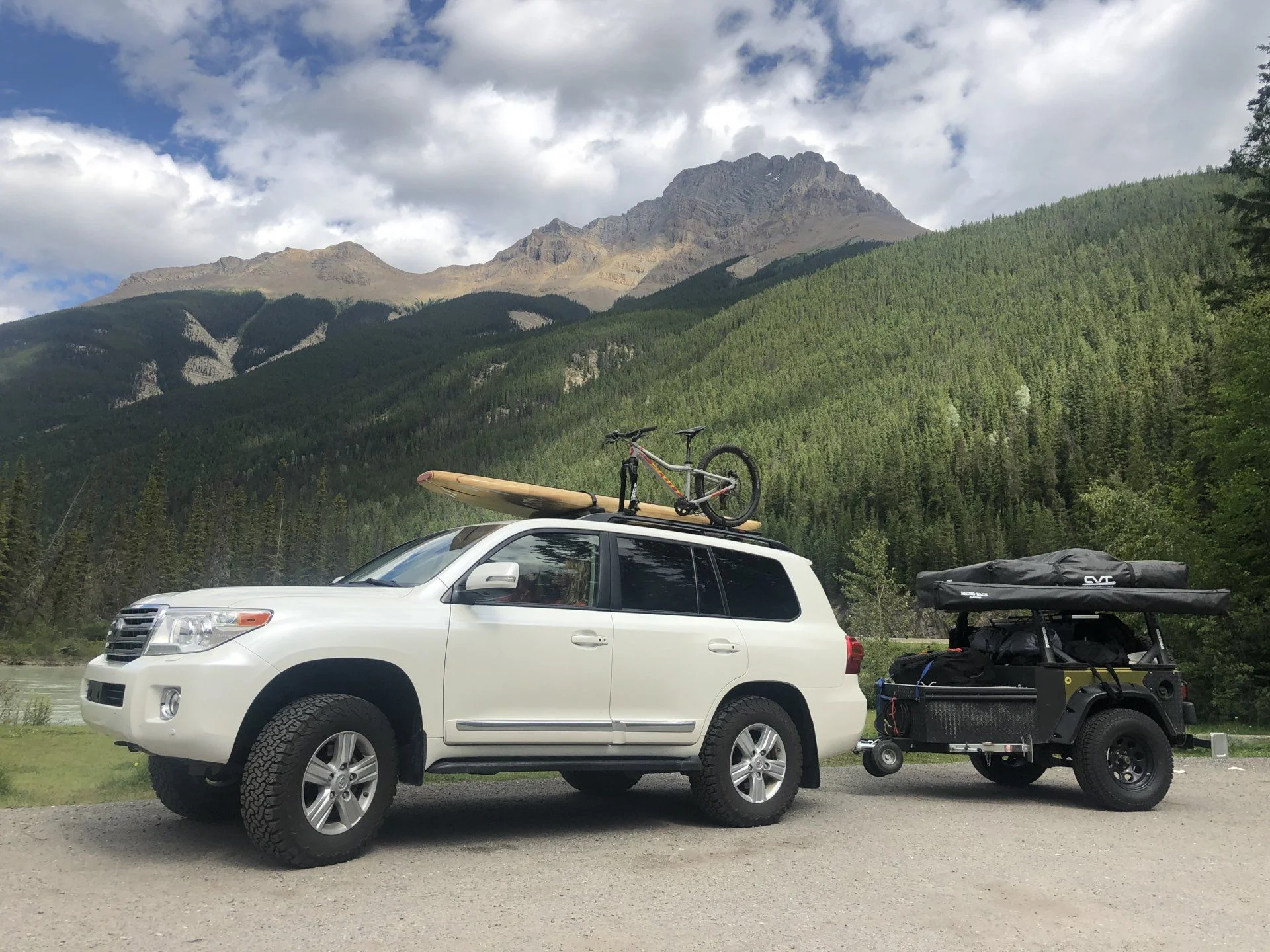

I just got back from a trip to Banff with my adventure setup and was surprised by a gas mileage difference between fuel in Canada and the US. I get a max of about 12.7 mpg with the setup pictured in the US, but from the very first fill up that mileage went up to 14-15 mpg in Canada. Upon returning to Idaho, my gas mileage went right back down. Has anyone else had this happen? The only thing I can think of is a difference in fuel. I even tried premium grade US fuel but no change from my normal. I was using regular in Canada. Same octane, same type, no ethanol.

I've tested this every which way I can figure out at this point, except US gasoline brand. I noted while in Canada that all their gas is the same price, which leads me to believe it's highly regulated. Yes, I've done the math on gas mileage, same speed, highways, traffic conditions, driving style (steady speed, no passing).
I'd probably give up if not for that 20% bump. That's huge over time. Good advice on Ethanol. Of particular note was the immediate effect upon entering Canada (I filled up at the first station after crossing the border) and returning to the US (filled up again, immediately). The gas mileage didn't creep up, it was immediate.
My guess is a small amount of extra engine efficiency at a steady highway speed could lead to a big improvement, where mixed driving would be unclear. If ethanol content ends up being the culprit, i'll avoid it. Now that i'm home and driving without any gear loaded and no trailer, i'm still under 13 mpg on the highway. Two extra tires on the ground and 2000 lb extra load and 1.5 mpg better mileage? That's crazy.

They use Liters and I spot check my trucks digital mileage gauge and take that into consideration so it's not a conversion/math issue. Lake Louise, yes... but too many people. They close the roads when the parking lot is full... talk about irritating but probably necessary.

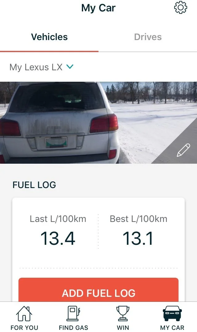

Here is my mileage in Canada. Regular gas most of the all the time, premium from time to time.
I have the tank filled up in a local chain gas station "Red River Co-op". Used to be a Shell guy until I notice the money back from the co-op gas stations.
Edit:
Highway City combined. Most of the city drive is early morning or late evening. 20L/100 km in Winter time when I had to drive during regular rush hours.
