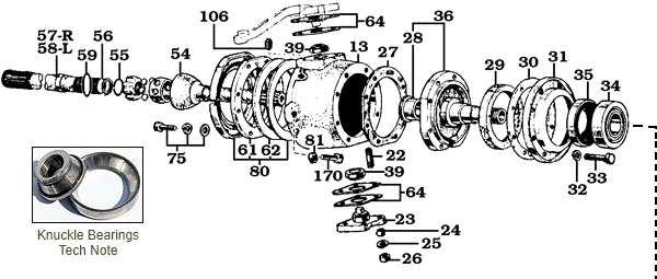

Per this photo it's a "fax felt" (29) and should have a retainer gasket:
http://www.sor.com/cat080.sor

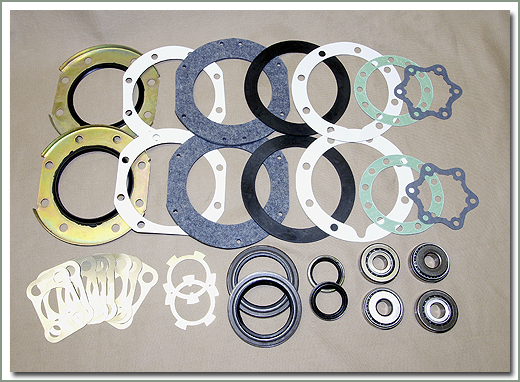

Every kit I've ever gotten looks like this:

The other thing is a small oil seal that appears to fit nowhere in the front end assembly. I cannot find one, and my diagram in Haynes does not show a smaller one. Any help out there?
Axle seal, look up in the bell and pull out the leaking one with a seal puller. I fashioned a custom tool to insert, big bolt with two nuts around a thick flat washer of the same diameter as the seal ;)
