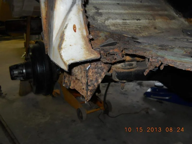

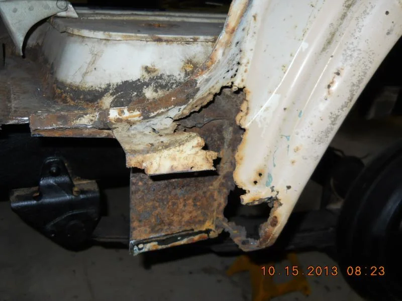

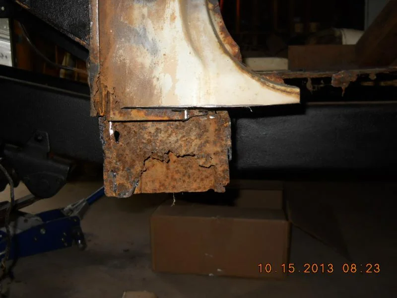

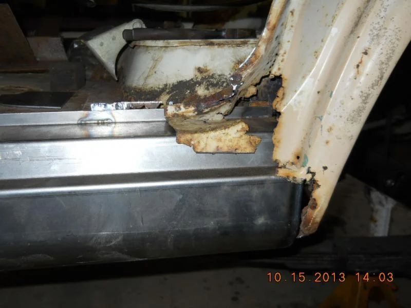

We started on this early today. The"A" pillar bottom will have to be rebuilt from scratch after we get the rocker in. The lower section is just gone. Fortunately, the body mount appears to still be in good shape. The "C" pillar bottom will need alot of work also. IF we work hard, I will get my taxes turned in and get the rocker in today!

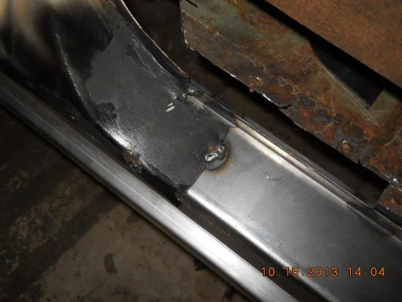

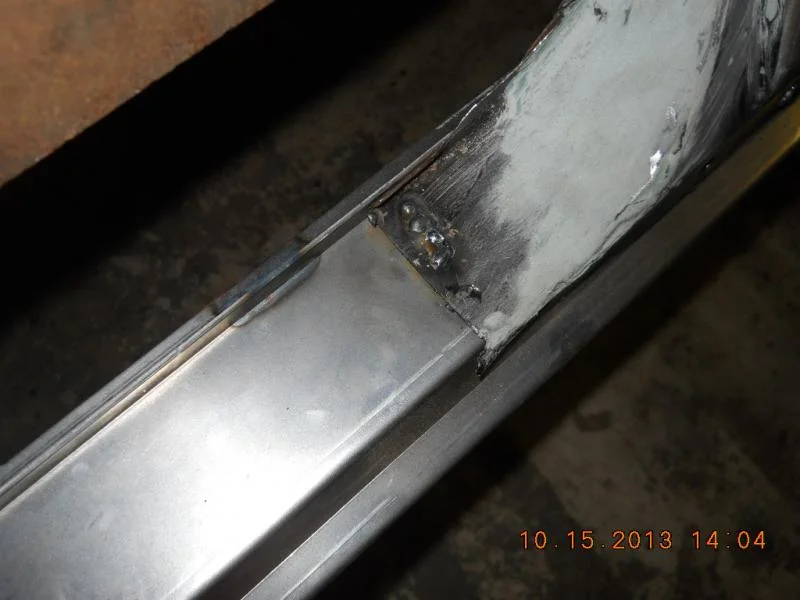

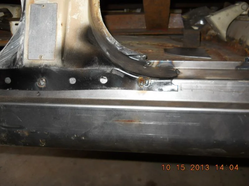

First Rocker Installed! Well, this is my first rocker ever! The welding is not completed nor is the front door curves which is going to be a pain. rocker install 10-15-13 (1).webp

looks like you could turn the heat up on your welder just a hair...:popcorn:. I try to use as high a heat and slow of a feed rate and make up for things by trying to keep moving...if you don't hear bacon, it ain't makin;)
I also start/run on new/thicker material and then quickly grab the thinner older stuff and drag it back in. The pig will make you a master;), and Bobs panels will make you a PRO...:cheers:
Bobm,
The first pic above is the back of the body mount. It is solid. In the photo, the floor is bent around it and makes it look like a mess. What are you ideas on forming the front curved areas?
With so much of the posts already thin and rusty, turning up the heat will disintegrate alot of it on contact. I am already having to rebuild alot of the curved surfaces. It is so time consuming, I figured I would go easy on the top. I will be getting new floor mounts, and I will certainly cook the mating of them and the rockers. I am finding it is a delicate balance to repair this thing. If you get a little over exuberant, you pay for it with more work! Nonetheless, it is exciting to see new metal go on the pig! Hopefully, tomorrow, there will be another rocker on there.

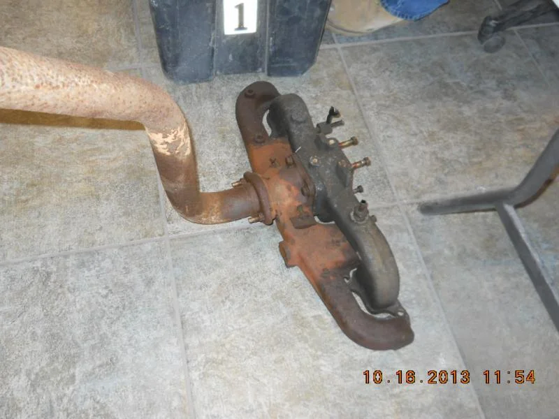

Powder Coating
Headed to the powder coater yesterday. The stack just kep on growing. I cannot wait until they are back, and I can put the engine completely back together. It is almost a full time job to move at this pace and get things done. I am still looking at about 1 more month of working at this pace, I am afraid. Even at that, it will only be a solid rebuild, not a restoration. I can only imagine the time that Delancy and Scrapdaddy have put into theirs.

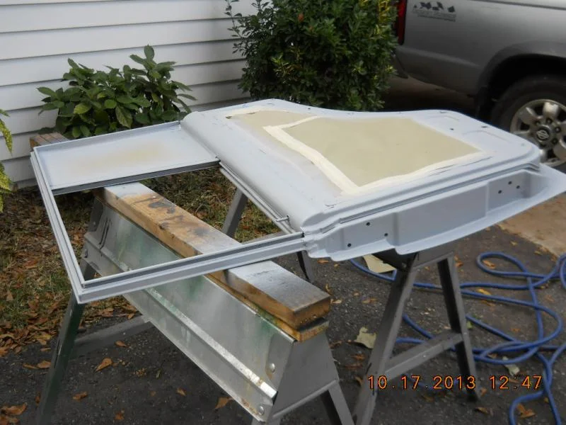

Also, managed to get some primer on one door, after repairing several splits on the inside panel and on around the hinge. I am going to have to hit all of the doors and the tailgate later today so see how bad they really are.

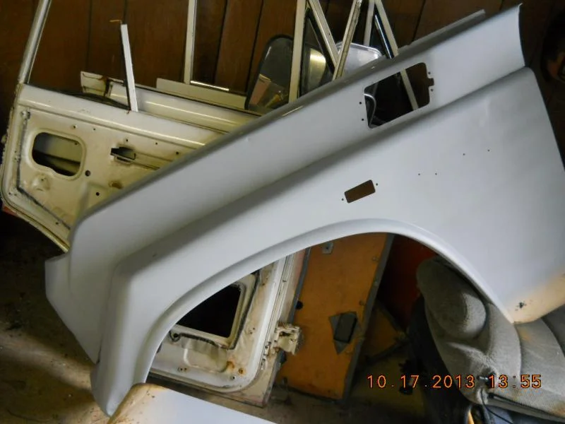

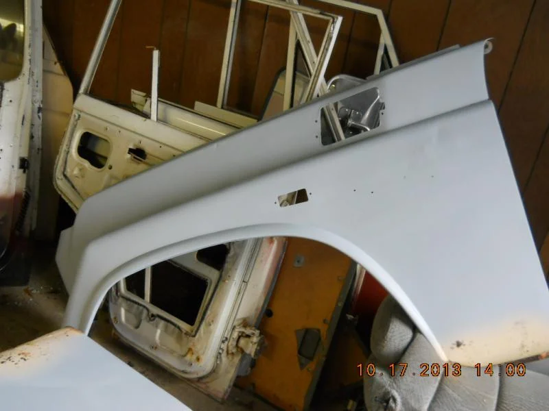

Its fun seeing a little progress. I am saying Good Bye to the old pig, at least the pig I have grown weary seeing, and getting ready to welcome the new pig....at least a pig of a different shade. I am thinking about mounting the front clip sans the fenders next, just to see what it looks like a little more put together. I am on hold waiting for floor mounts, so I cant finish the floors. May as well focus on the things that I can do.
With primer on, the obvious work needed on the fenders becomes even more obvious. Looks like we will be busy for a few days on this.
We might go ahead and shoot the top and the rear section too.
and why not the hood too, while we are at it...
Lots of sanding to be done here, and some more rust treatment and hole repair along the front lip. what a pain.

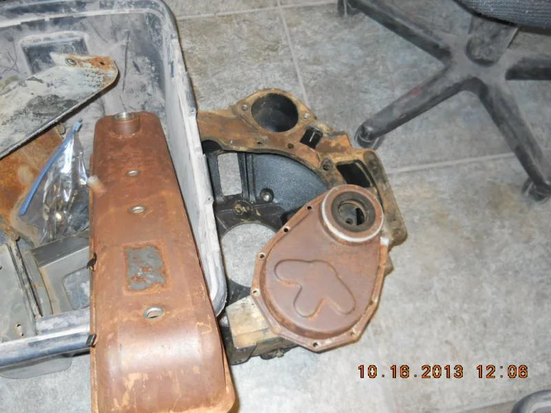

Today, I picked up the rebuilt transmission, and the re sealed transfer case. Also, picked up the head that had the oil port tapped and plugged ( there was another broken bolt that was drilled out also.) on the way home, the powder coater called and said that he would have everything ready on Wednesday. So, I am getting pretty excited about all of this coming together! May assemble the bottom end on Thursday or Friday....if I can get the bolts to hold it on my engine stand. I measured the bolt size with my bolt gauge, and it is a 14mm. I have no idea what the thread pitch is. 1.50 will not work, and neither will 2.00. Any ideas?
I was looking around for bolts, seems I can only find 1.5 mm and 2.00 mm. Not sure what to tell you. Where do these bolts go again? Bellhousing?
