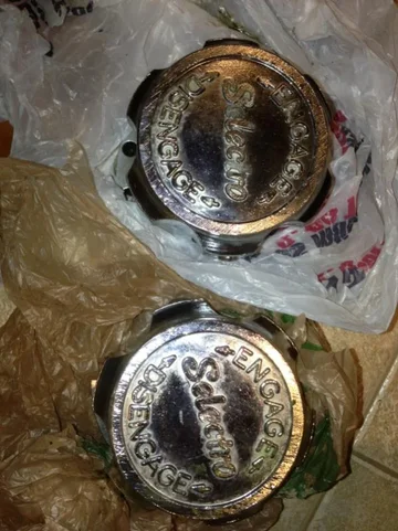

That's a Selectro hub on the passenger side -
Tucker
Actually, it appears to be the earliest ASCOs that were offered, believe in 74.
Too bad they don't match.
Have a set of Selectro though, if you're interested.

Don't toss that one oddball hub. If you're not going to run it, can surely find something to trade.
I don't need the hub. I was just going to putti back on parts rig to seal up the hole. What do you have in mind?
Want to trade that nasty old, junky hub you have for period correct, shiny Selectros?

I'd like to find a match to the hub you have, clean up when I restore mine, since they'll be very cool additions to the 74 model resto's in the future.

We are working on the brakes now. Look at the hubs in the photos. DS is a Warn, the other side, no idea. What do you think?
I am going to take the PS Warn off of my parts truck and put it on the pig so that they will match. I know there is a hub kit that should go on there. Can someone tell me what that is all about? How difficult to install the kit, etc.?
PS lock-out is ASCO product (factory piece).

I will just send you the hub and stuff a trash bag in the hole on the parts pig. I may need some of the other later on. I am not worried about it now. It will be a few days before I get it off.

Having a hard time removing the Selectra...only moves about an 1/8 th of an inch and will not budge. I don't want to damage it. Any ideas?

Can't say with certainty, but the dial should remove to expose the c clip on the eve of the CV.
Remove c clip and slide off, is my assumption, if anything like any other LC I've encountered.

and the dial comes off how?
