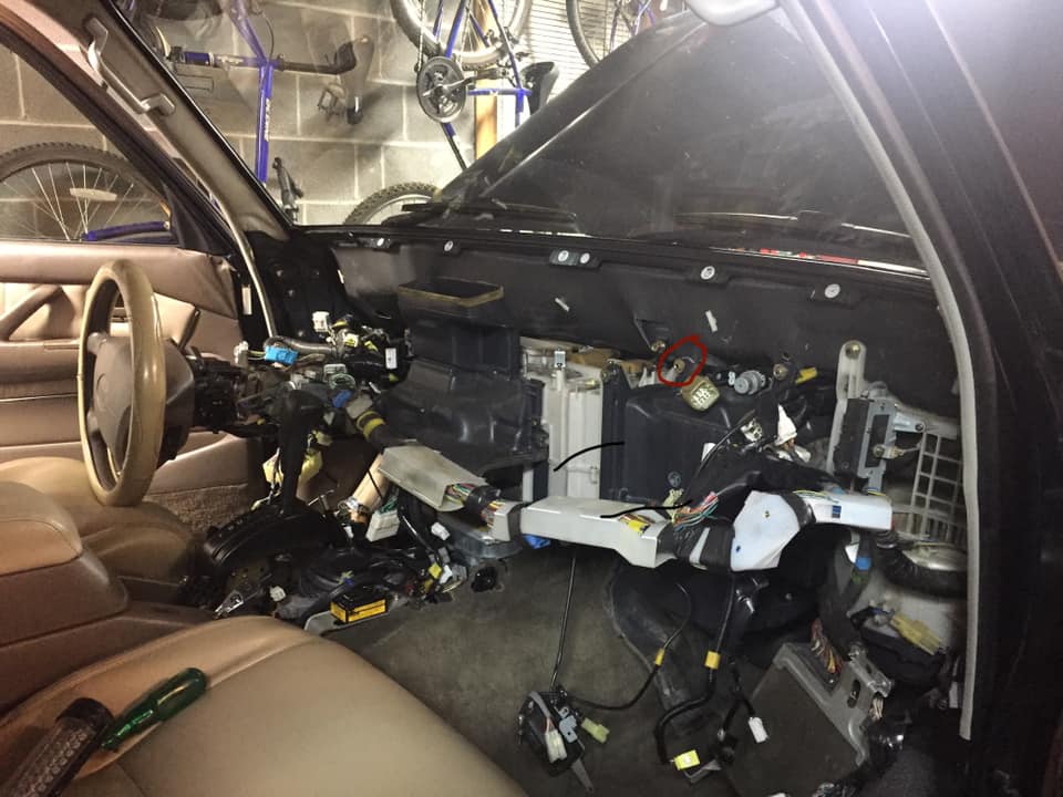

I pulled my dash a few years ago to fix a leaking heater core, back when you can still get them. There is one stud on the firewall where the A/C evaporator box and the box that holds the heater core overlap, and the heater core box is the one against the firewall at the stud. The manual says to discharge the A/C so the evaporator can be removed. I found everything for a bit but was able to get the heater core box assembly out without having to remove the evaporator. Wasn't fun through.

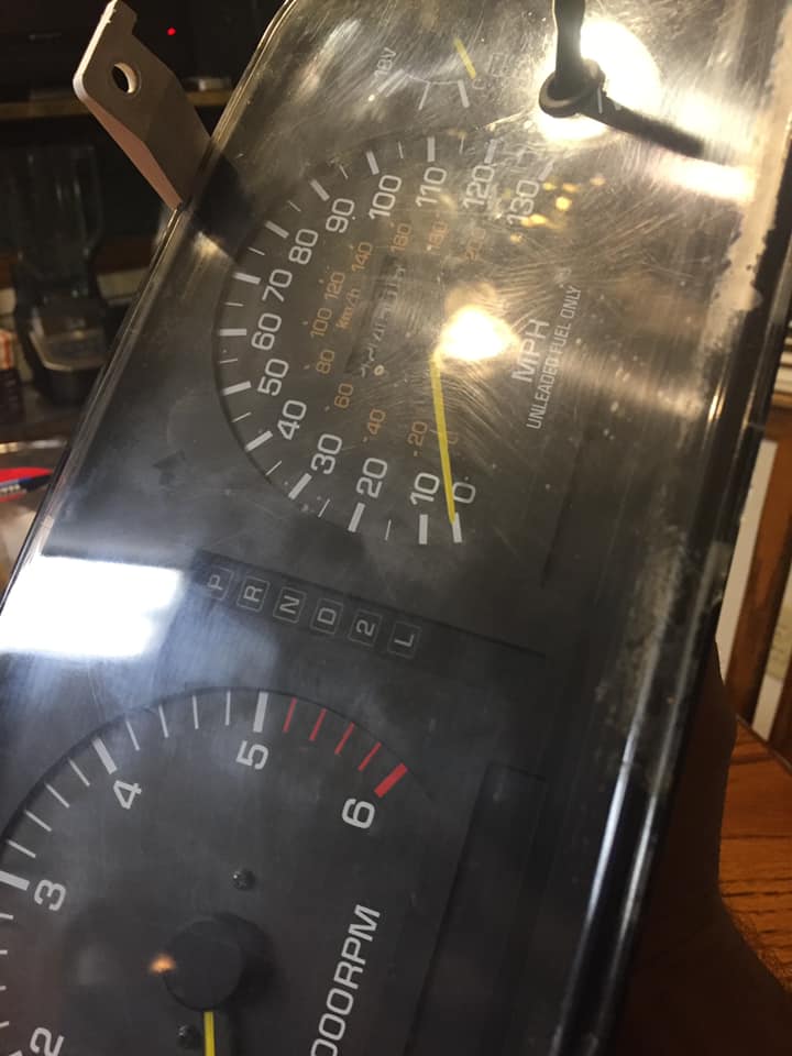

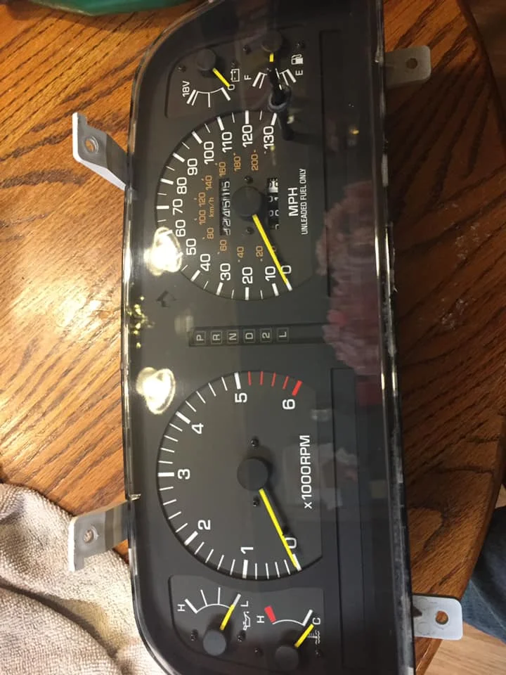

While I had the instrument cluster out I took the time to replace the bulbs and also polish the plastic on the front. I used 3M Lens Polish and Protector
Attached a photo showing the one spot where the air box and the A/C evaporator box overlap.
Cluster before and after

Wow, that cluster came up mint!
