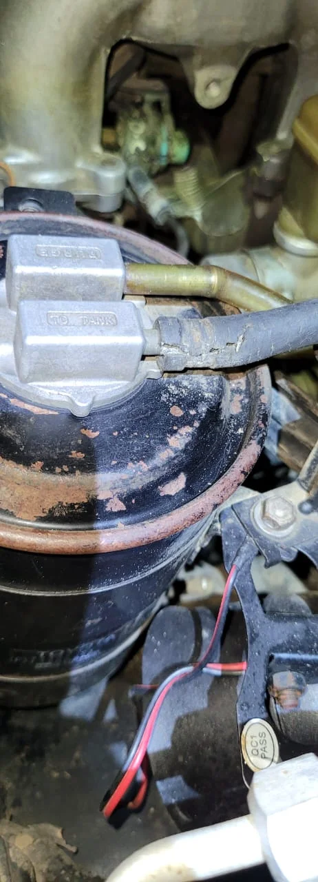

I did not notice, I will check here is the canister lines before fitting a clamp

I did not notice, I will check here is the canister lines before fitting a clampView attachment 3061233
Yeah those hoses are shot.
There should also be a hose coming out the bottom of the canister...don't see it in the pic tho could be there. It is the actual vent hose that runs along the inner fender well and stops somewhere around the firewall IIRC.
Given your proximity to the UAE, recommend just replacing the canister.
The hoses can be replaced with 4mm(?) fuel line from any parts place.

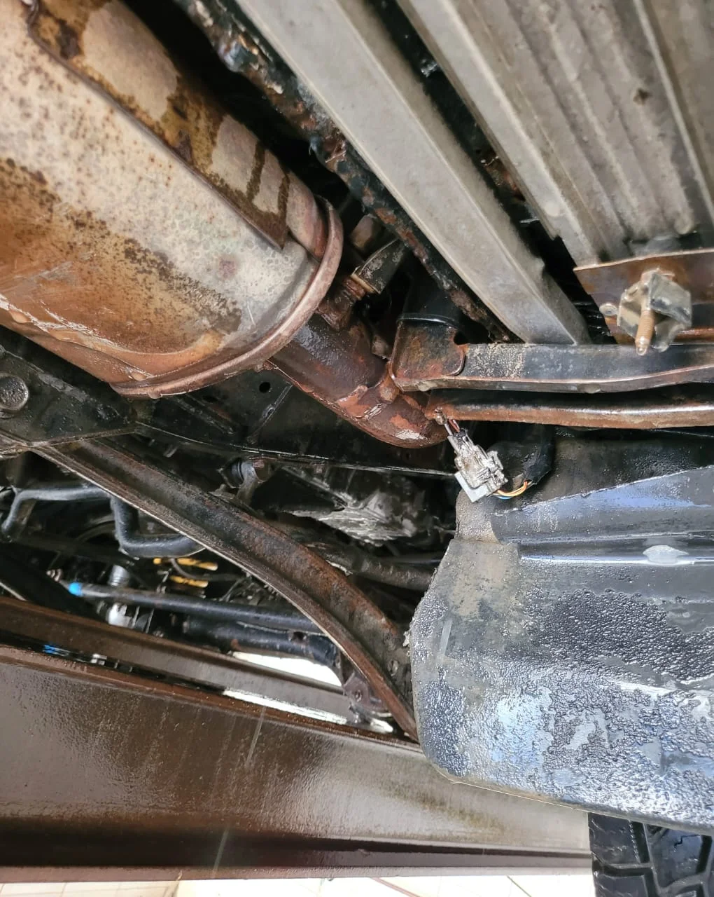

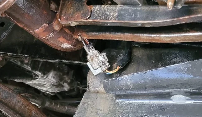

Oh I found this when I was looking under the car, seems it was dangling and touching the exhaust.
The plastic plug is melted but i didnt see exposed wires i will need to take a better look but i think this is the Co2 / Cat cable ?
Yes, that's one of the wiring plugs for an O2 sensor. It appears melted and that will cause an issue.
O2 sensors are very sensitive with wiring. Check the harness and replace the parts and sections necessary.

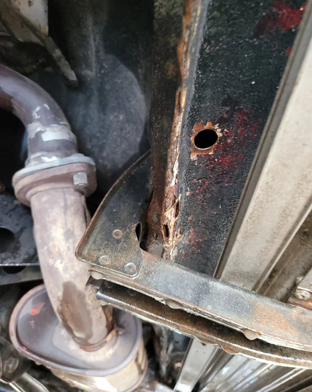

Post a picture of your cats. You may need to take them apart to test if they are clogged.

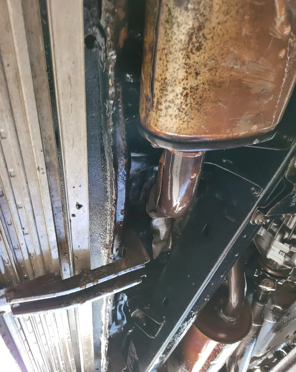

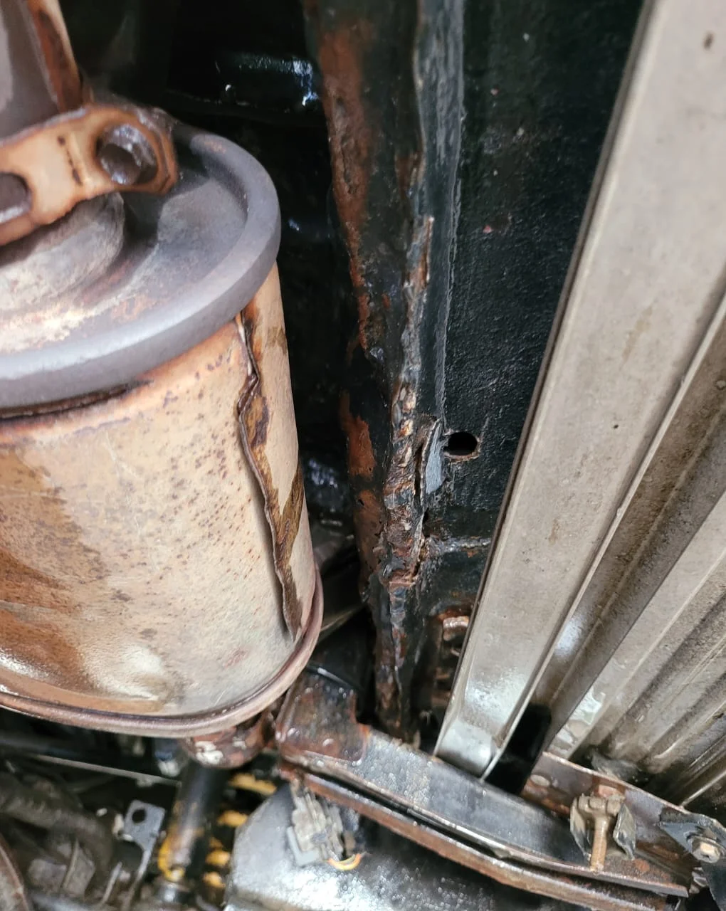

Here are the pics i have for the CAT

Here are the pics i have for the CATView attachment 3063890View attachment 3063891View attachment 3063892View attachment 3063893

That "cat" if that's what it is, appears to be left over from the diesel. Not sure how they differ in design or operation.
Did we determine that your engine is a 1994 1FZ-FE?
If so you should have two O2 sensors. The 94 engines had side by side cats, one for the front bank, one for the rear bank.
You may need to install or find the second O2 sensor and locate both into the exhaust manifolds near the engine.

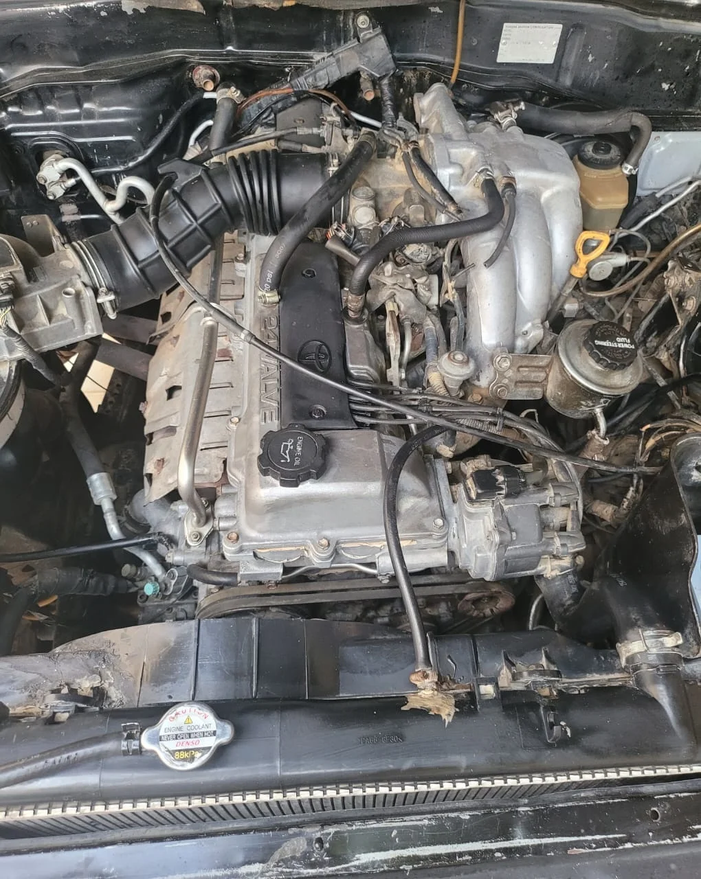

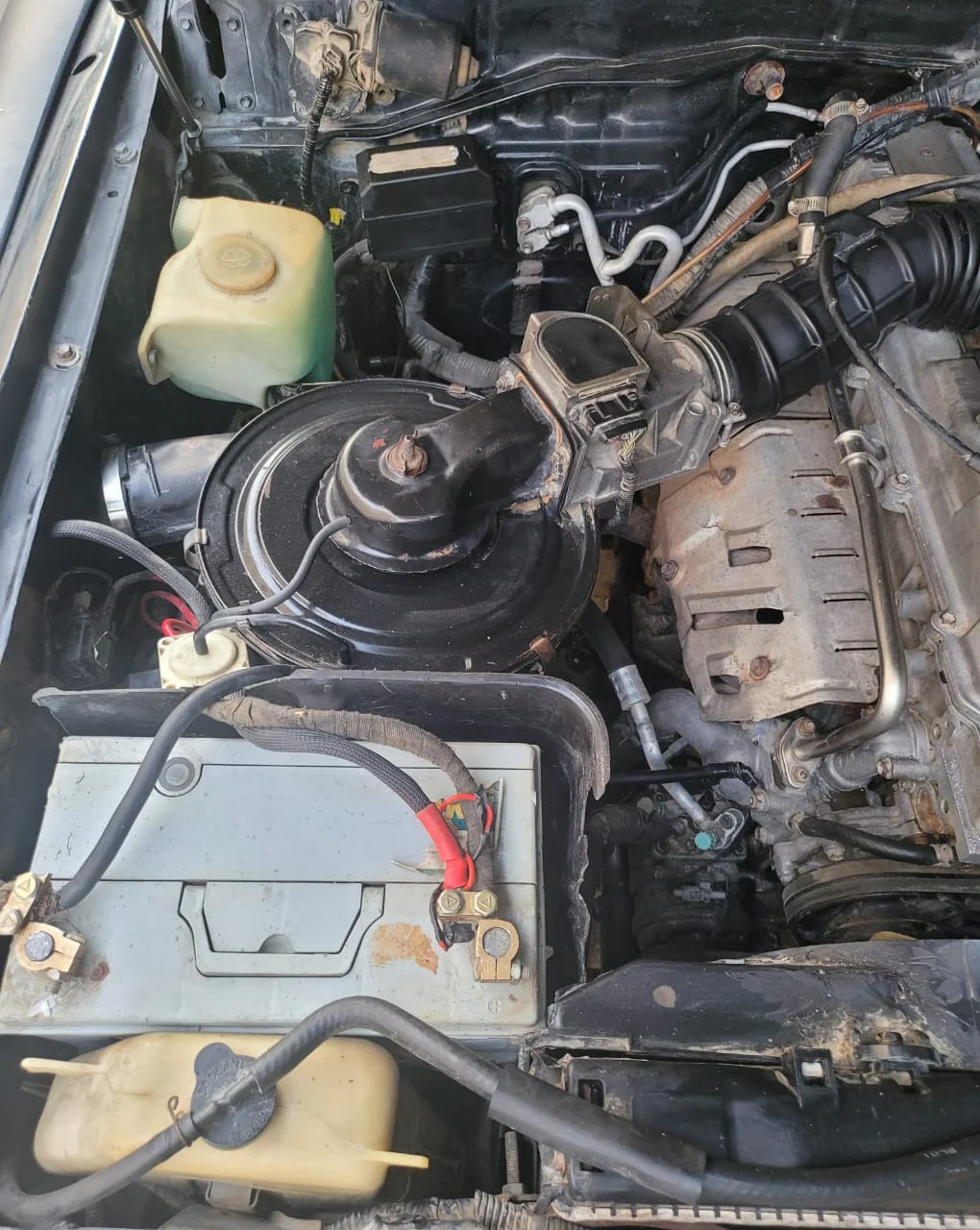

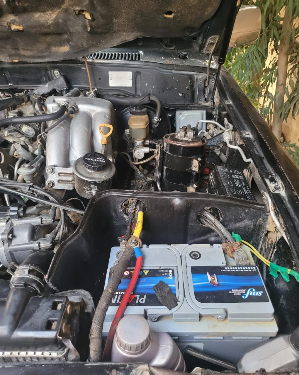

Please attach pics of the exhaust manifolds under the hood.
Found this link Injector Service - https://george4wd.taskled.com/injectors.html are those the ones you mentioned?
Thanks @BILT4ME for the support (and patience) truly appreciate it !
Yes its the 1FZ-FE, I know the bonnet is scavenged from some where else :D
The cat was installed quite a bit after the car was changed from Diesel to petrol, It never had cat before that.
View attachment 3063952View attachment 3063953View attachment 3063954View attachment 3063955
Yes.
Also, you have a vacuum hose disconnected on top of the intake manifold. It goes from a hard line near the front to the "gas filter" on the top of the manifold.
Do a search on here for "94 O2 sensor relocation" or something like that and read through the threads where they move the O2 sensors to the manifolds. I believe they remove the heat shields and there's a port in there that they can bolt into.
