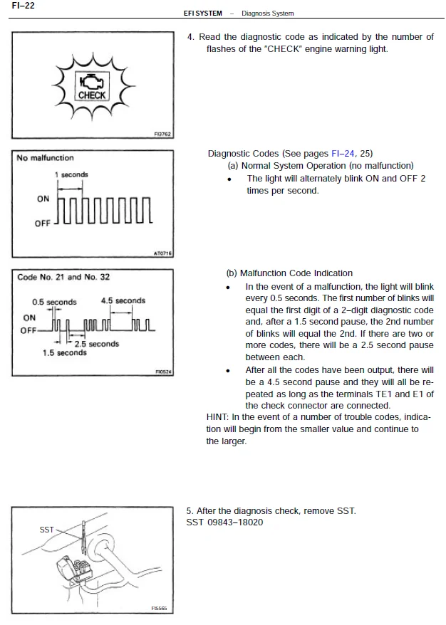

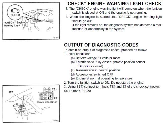

The CEL flashes out the code numbers.
Jumper between two pins I can't recall at the moment at the diagnostic port in the engine bay. TE1 - E1 or some such. A quick search will bring up the process. 👍

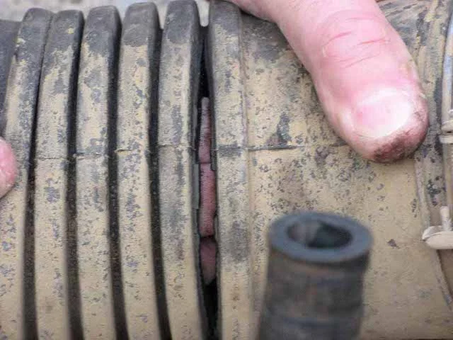

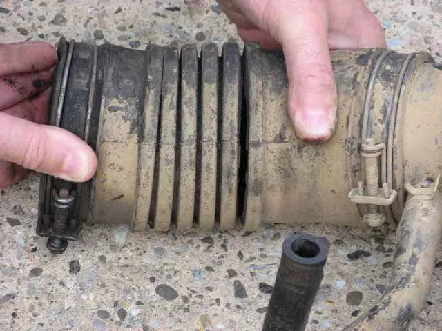

First thing to do is check the intake tube for cracks. Any unmetered air getting into the system will play havoc with your idle. This includes the gasket on the oil fill cap, oil dipstick, valve cover grommets, etc. The top half of this motor wants to be air tight.

What do you mean it didn't work? From the 1991 FSM:

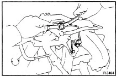

Slightly crack open the banjo bolt on the cold start injector (CSI). The CSI is located on the top left of the intake. While cranking the starter, you should get fuel spraying out.
