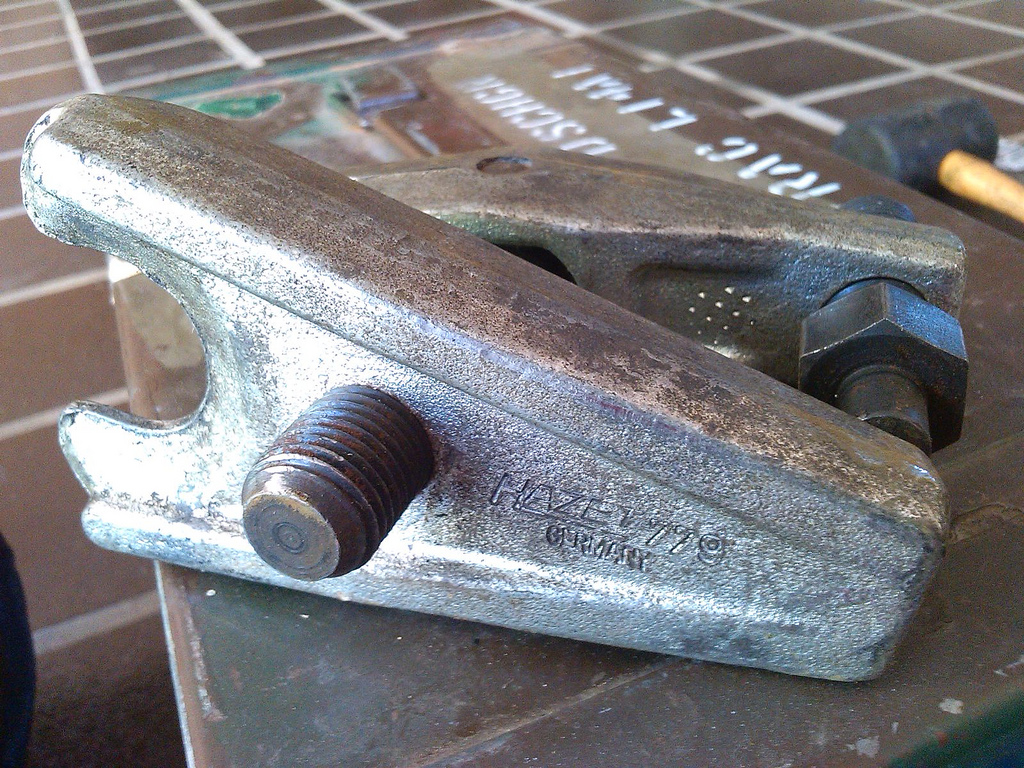

Maybe I'm just a wuss (sic!) but i was trying to get the tie-rod ends to come free on the front steering rod (going from pitman arm to LHS swivel hub arm) however I baulked after getting a bit too jiggy with my nice Hazet tool ball joint tool.

I don't want to damage the steering box by using excessive force on the end at the pitman arm. My ball joint tool is this one:

the Hazet one you pictured is far from ideal. I had one similar and snapped it in half. You have leverage in the puller working against you.
I have a small Kinchrome pittman arm puller that works a treat. grease the thread, and you can put a metric sh t load of pressure on the tierod stud, then a sharp crack on the side of the steering arm with a good size hammer, they pop out
I actually broke a pitman arm puller trying to get the pitman arm off the old steering box about 5 yrs ago. 8-) But worth trying out. Back when I replaced the steering box I had to do the two-hammers thing.
