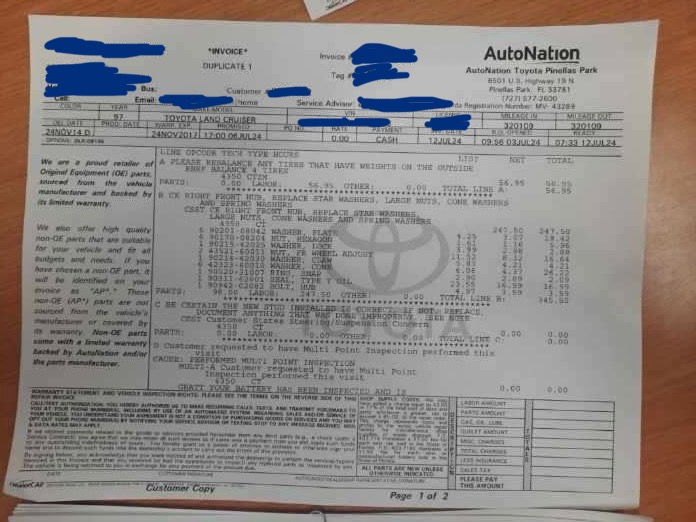

The national tire chain I use for tires and rotating/re-balancing once cross-threaded one rear wheel lugnut so the stud snapped when I went to change a tire.
The tire chain gave me a choice, take it to a mechanic they use or take it to the local Toyota dealer to replace the wheel stud, I choose the dealer.

Toyota bill, Monro is reimbursing. I'll post the tire choice invoice when I get home. Not sure why, but they also had wheel weights on outside on left wheels, and inside on right wheels. So I had them fix that too.
