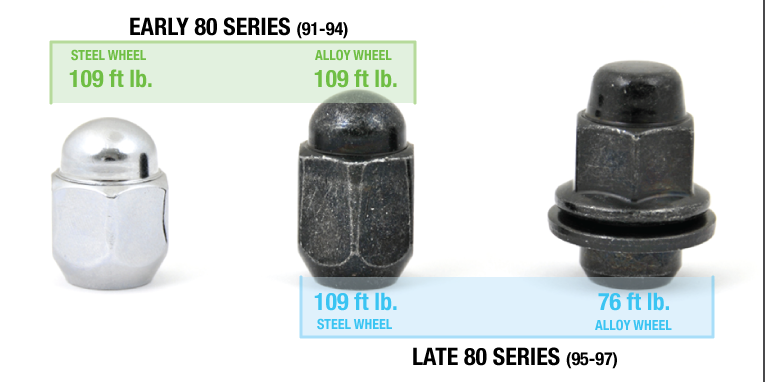

Standard bolt torque requirements are listed in the introduction section of the FSM for your truck.
Torque settings are tabled. Bolt tensile strength is not.

I’m not sure what value there is on trying to get the specific bolt strength of a wheel stud.
i don't know either. show them the lug nut torque value called out in the FSM and ask what they torqued to. via torque wrench or torque stick also matters.
be very careful with that. grease, anti-seize, etc change the torque value and you are most likely over torqueing your studs.
I use a torque wrench and torque to 100lb.
I also think over torquing due to lube is less destructive than overtorquing due to corrosion/galling and siezed threads.
Lots of tire shops use torque sticks/ torque bars. But lots still don't.
