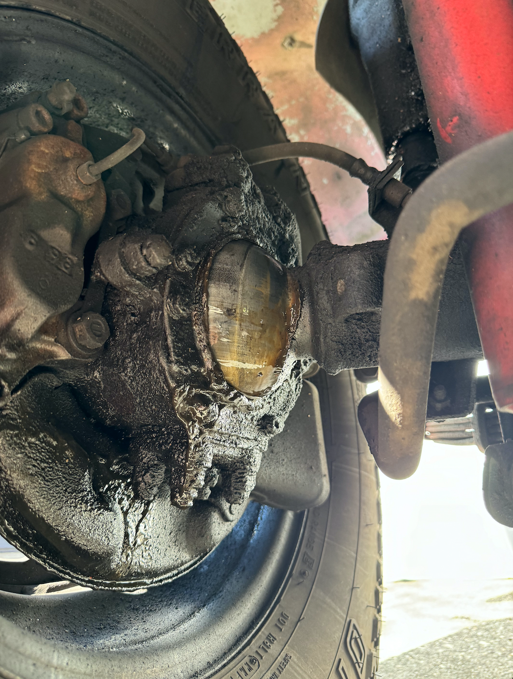

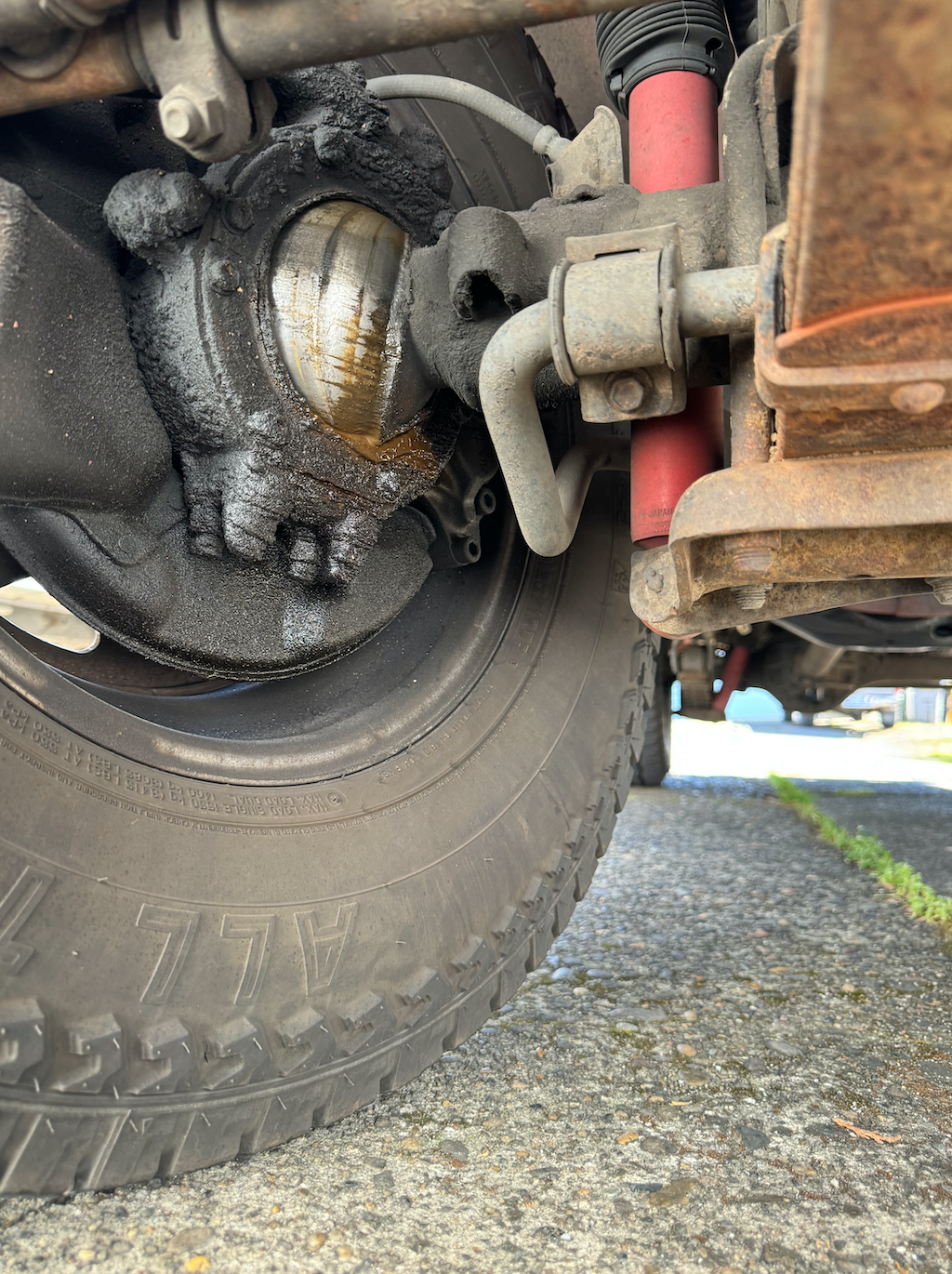

Hello all,
My rig is progressively dripping more grease here from behind the wheel. So much so that it is dripping from the tires and even to the driveway. Is this considered normal or what is causing this? Was it just overly greased?
1931968
yeah probably inner axle seals are leaking and that’s diff oil mixing with knuckle grease causing that soup. cruiser outfitters has rebuild kits and all the stuff you’ll need. get marlin axle seals while you’re in there. not a hard job just messy and time consuming. many other vendors here on mud that sell them too so pick who you like. also loads of threads here that’ll walk you through it
The gear oil from your front differential is leaking out through a seal on the axle inside the axle housing, mixing with the grease in your knuckle. The wiper seal on your knuckle can keep dirt out, but not gear oil in.
Depending on how much has leaked out, your differential could be low on gear oil and your knuckle low on grease.
If you decide to check the differential for level, always try to remove the fill plug first, because if you pull the drain plug and the fill plug doesn't budge, you won't be able to refill it, any easy way in any event.
