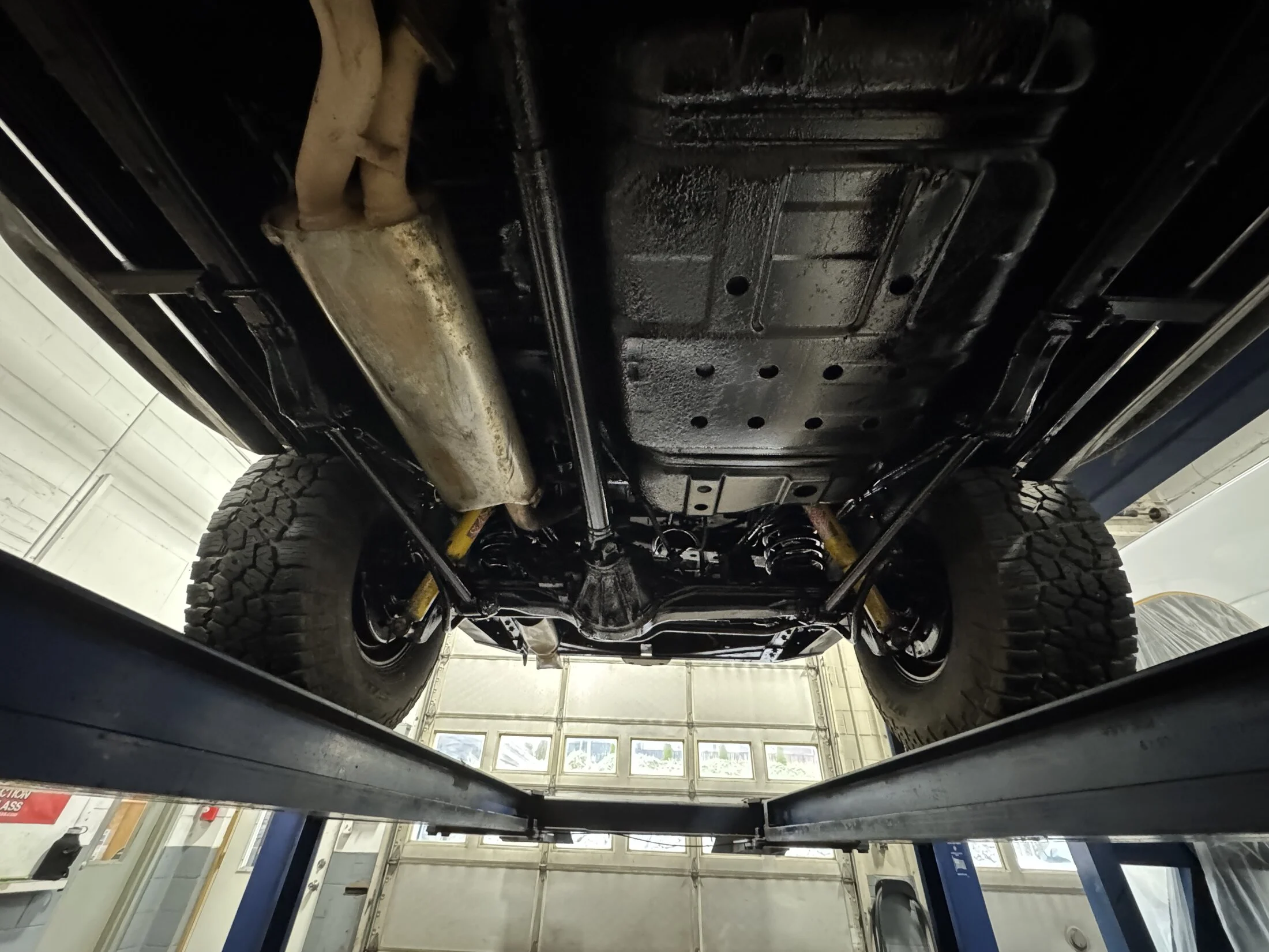

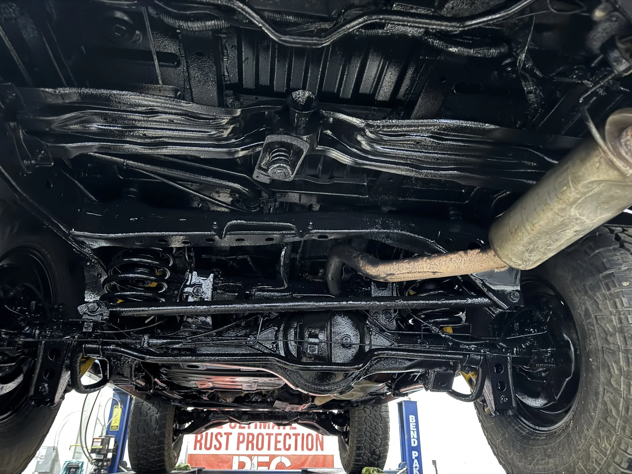

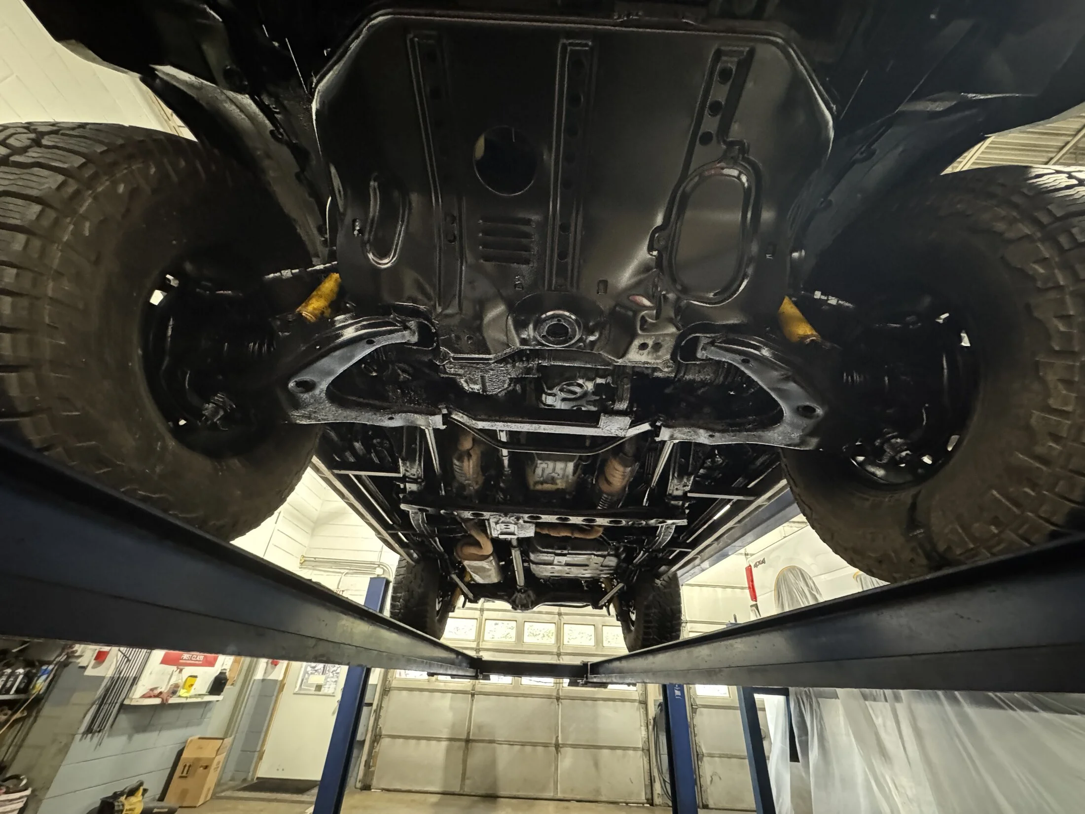

Extremely happy with the results and the guys that own/operate the place. 10/10 would recommend and for me the money spent is worth the peace of mind, headaches saved and time I would have spent doing his myself.

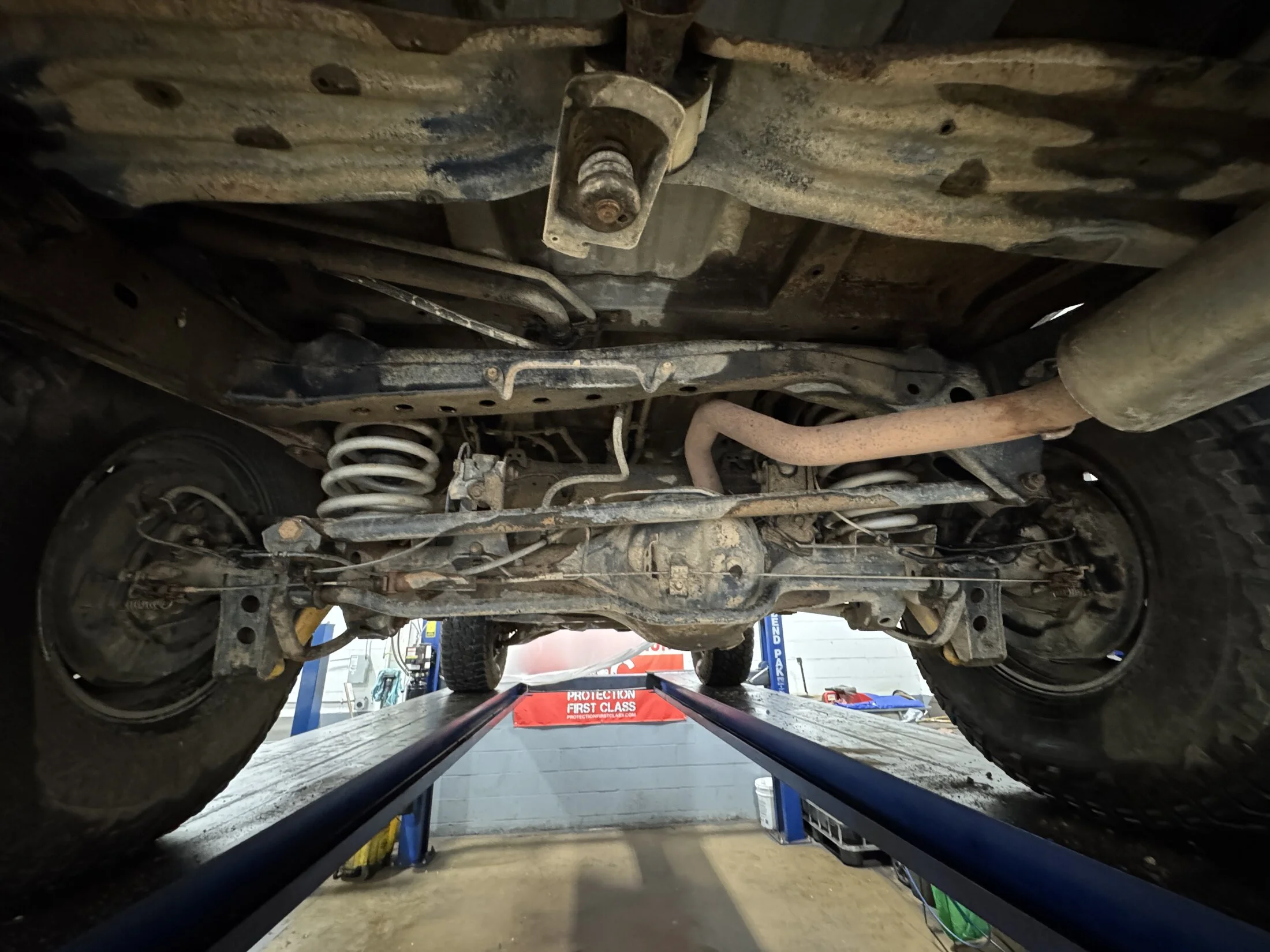

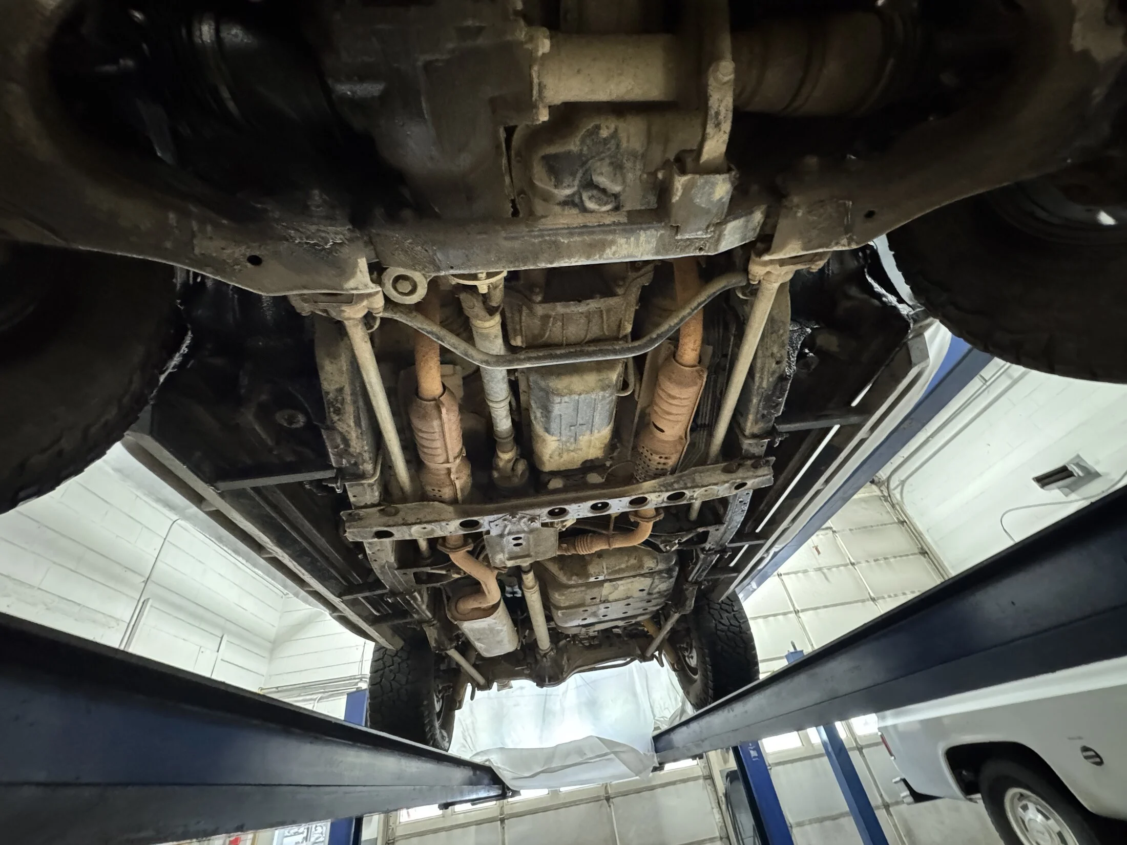

@kouki wow! you had considerable latent mud and grime stuck to that underside in the before photos...that's pretty cool that they are able to use that starting point and finish like that. Did you get to see it after the cleaning? After photos look impressive. :)
They did a really good job. Unfortunately I wasn’t allowed in the shop under the lift for insurance reasons so they guy doing the work took these for me and text them too me.
Looks amazing.
Did you find out what product they used? Lanolin based w black tint?
It is a lanolin based product that can be clear or tinted black, your choice.
