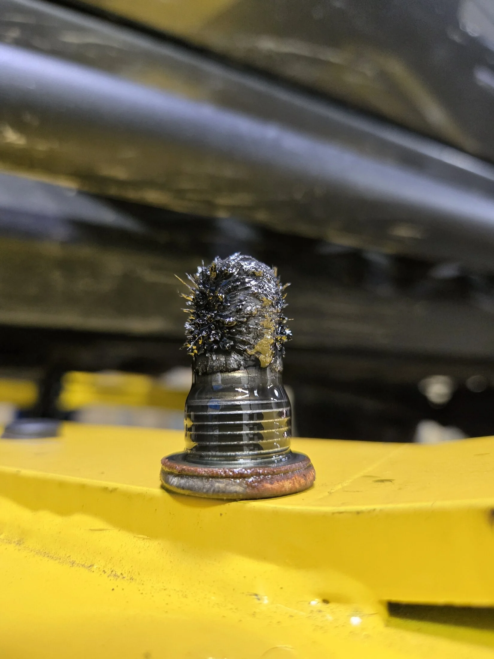

Looking for recommendations on shops local or that can send a complete unit for my core. It seems that my diff is bad and short of YotaMasters I haven’t had any luck finding a plug and play solution.
Finding something at a yard seems risky without knowing mileage and condition, but I’m open to suggestions.

Most likely just old age. We also see pinion and axle seals being left to leak. You can only lose so much fluid before things melt.
