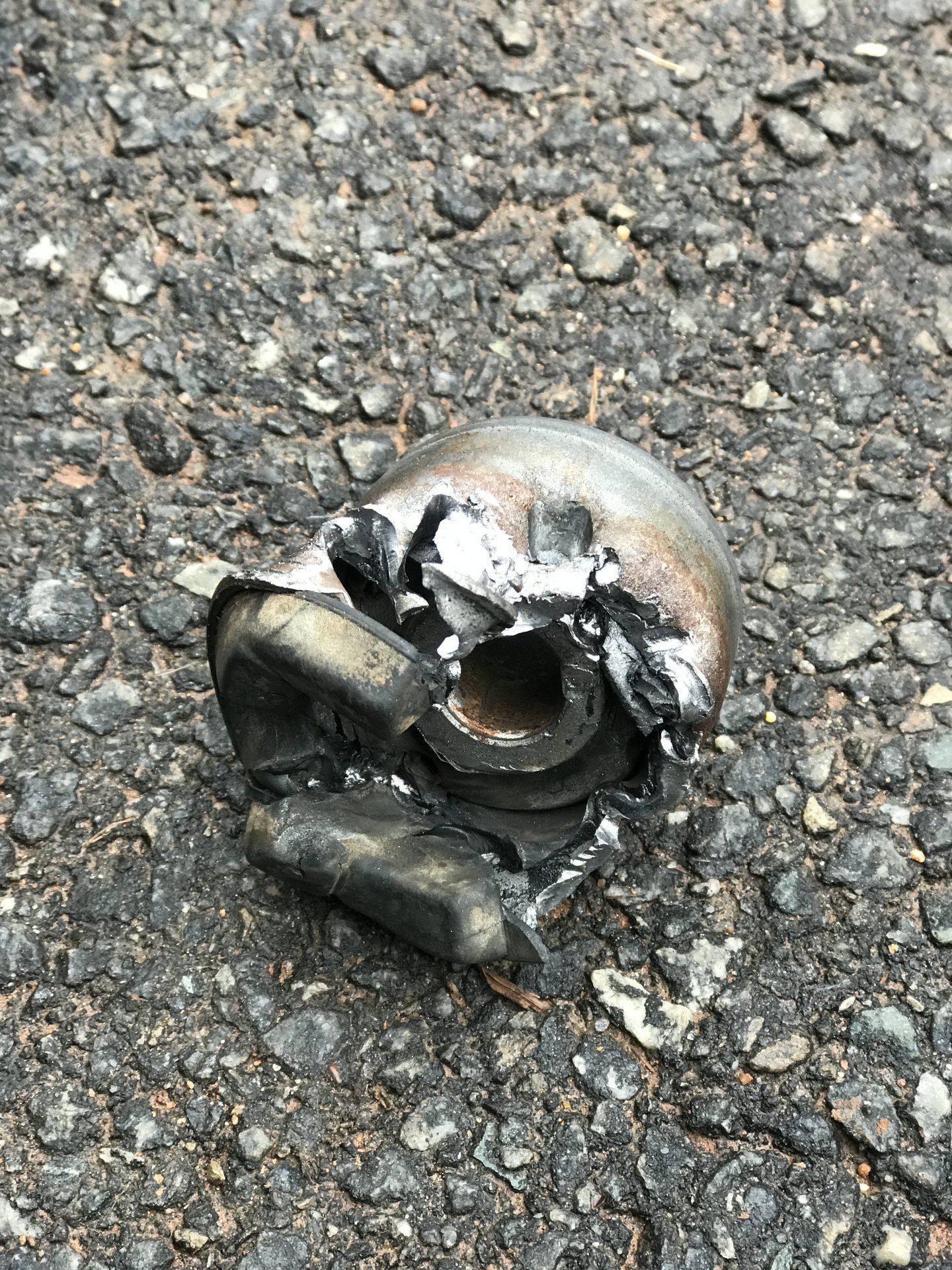

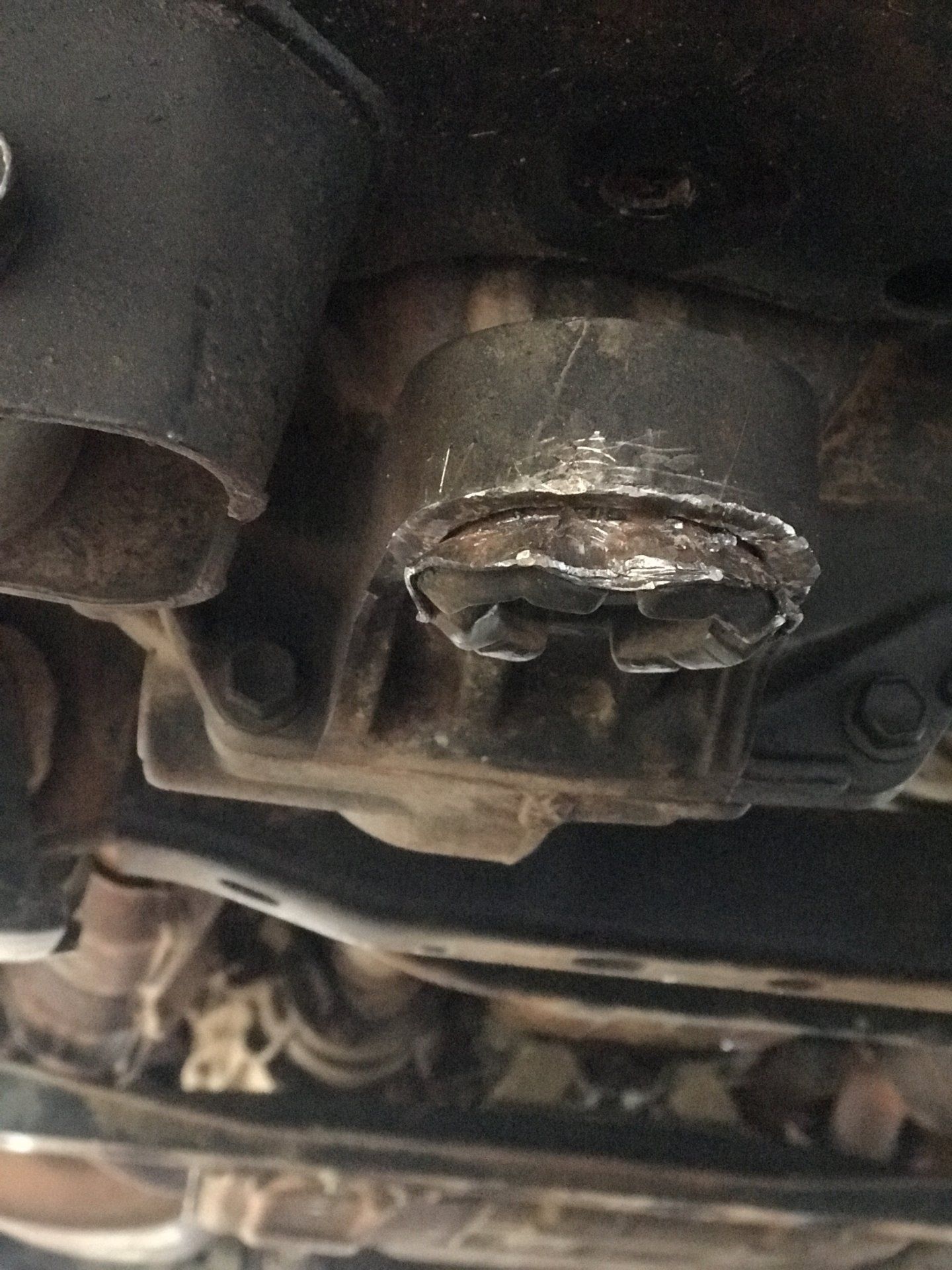

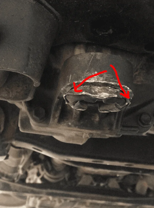

Got it to here... now how do I get it down and out???
If you can get a bimetal sawzall blade in there and cut a notch in the bushing that will relieve pressure.
  • Like
Reactions: MDK
I wonder if I am the only one who went through all the same trouble to replace these bushings to find out they weren't causing the clunk and not really that worn out in the first place.

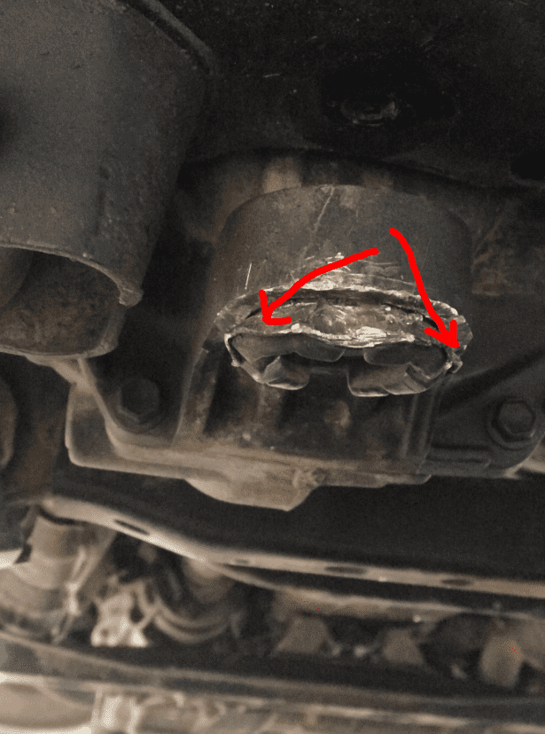

Do I have to pinch out 360 degree of the bushing before I start pushing it out? Trying to get the back of the bushing out is nuts. Can’t even swing a hammer back there
I talk about that in both my diff bushing videos, I think. You have to hit it down and out. You do *not* need to break the lip free all around. once it starts moving, you can move around the exposed areas and creep it down.

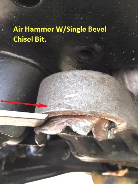

It takes about 30 seconds with an air chisel. A whooooooole lot longer with a traditional hammer, haha.
Yup. Tried with a hammer.
I look like this now.
Will be attacking it with hammer drill (chisel bit) tomorrow morning to finish the job
Basically it is wedged in there so you gotta work it back and forth, side to side. Once she starts coming out you will hit a point where it will be moving along like it has and then suddenly just "fall" out. Clean up the hole with a file so that you don't have any marring spots and you are good to install the new one. I did like @2001LC did and put a schmear of Red Mobil 1 grease around it to help slide it in.

FYI for anybody doing this task, unless you possess Herculean strength and endurance please get a hammer drill or air chisel.
Hahaha as soon as I looked at it last night all torn up I thought - “well i have to replace it now for sure.” :meh:
Right... I hit that point too and was like "Welp...s***...... Ok its gonna have to come out somehow."
And yes, the air compressor with the hammer drill is the 1-2 punch. I purchased the $12 HF special with a set of extra chisels (not realizing it came with one) and that did the trick for me. Don't know if I will ever use it again, but it served its purpose, went into the tool bin and will be there until I need it again.

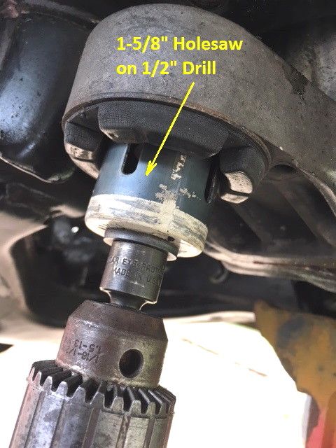

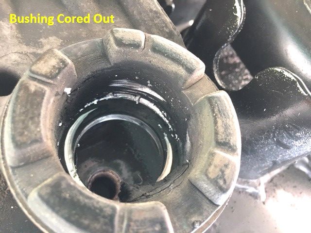

IF you are equipped to do so, then 'boring' the center section out first will allow for MUCH easier deformation of the metal shell and removal of the old bushing.
An 1-5/8" hole saw in a 1/2" drill makes short work of it.
