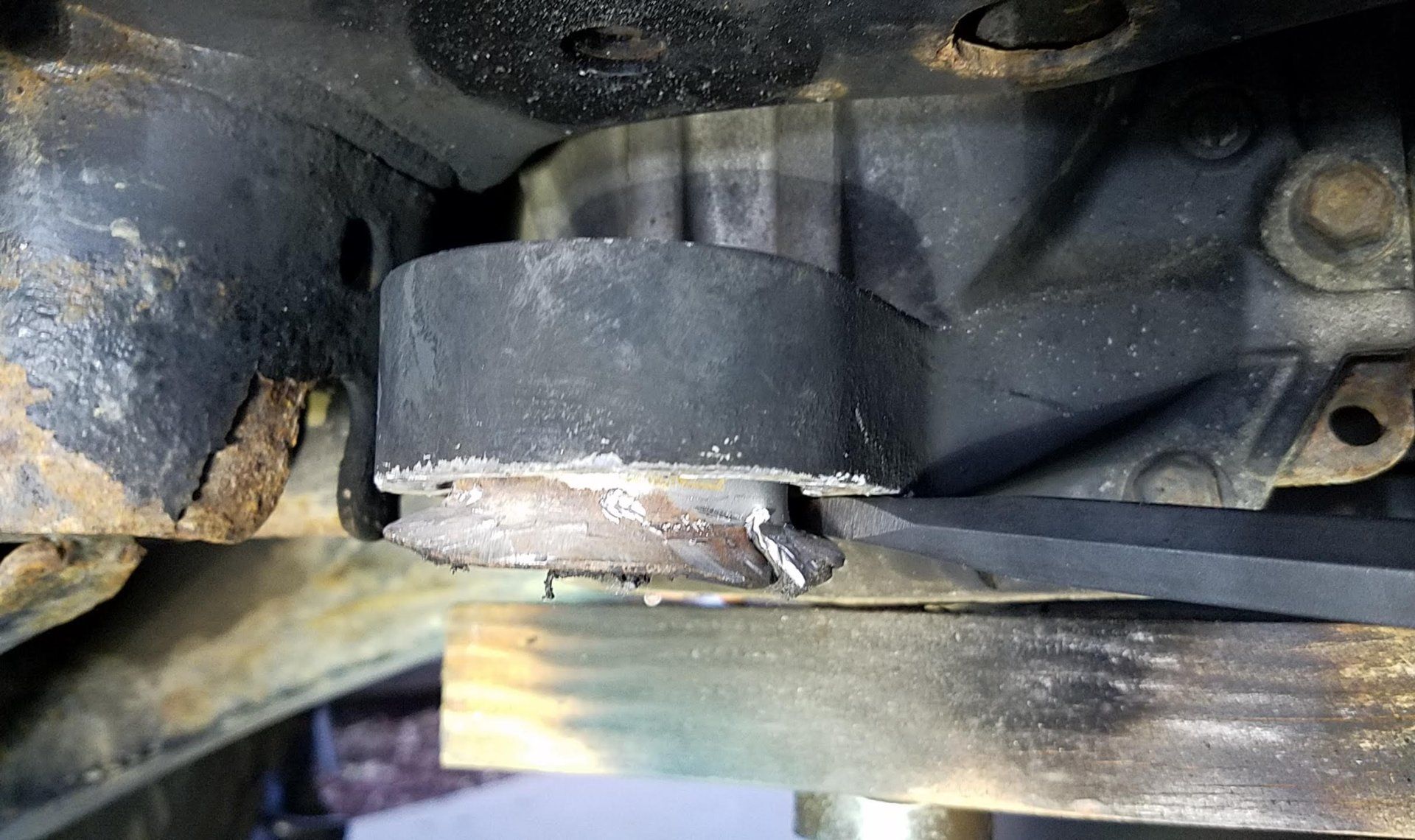

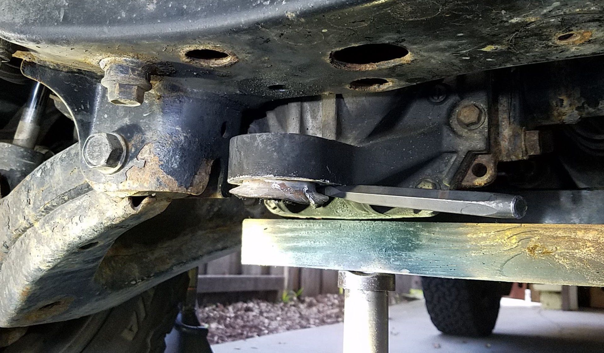

I recently used a good ole' hammer and chisel remove my diff cover bushing. I notched the metal bushing sleeve in four place and just started chiseling away. I only needed to get the bushing chiseled out about half way out (180 degrees of the 360 degrees). Once you get it started with the chisel, you can just pry out the rest instead of chiseling.
Just my experience, I don't know that I'd buy an air chisel for this job alone...

Scarier job than it really is. Just take your time and do it... air chisel/hammer makes the job a breeze as you slowly work it down, but once you hit a point it literally comes out in seconds. I think when I did mine I spent the majority of the time fighting it the first 1/4 to 1/3 of the way out, which was probably a good 20 minutes, then after that it just about fell out.

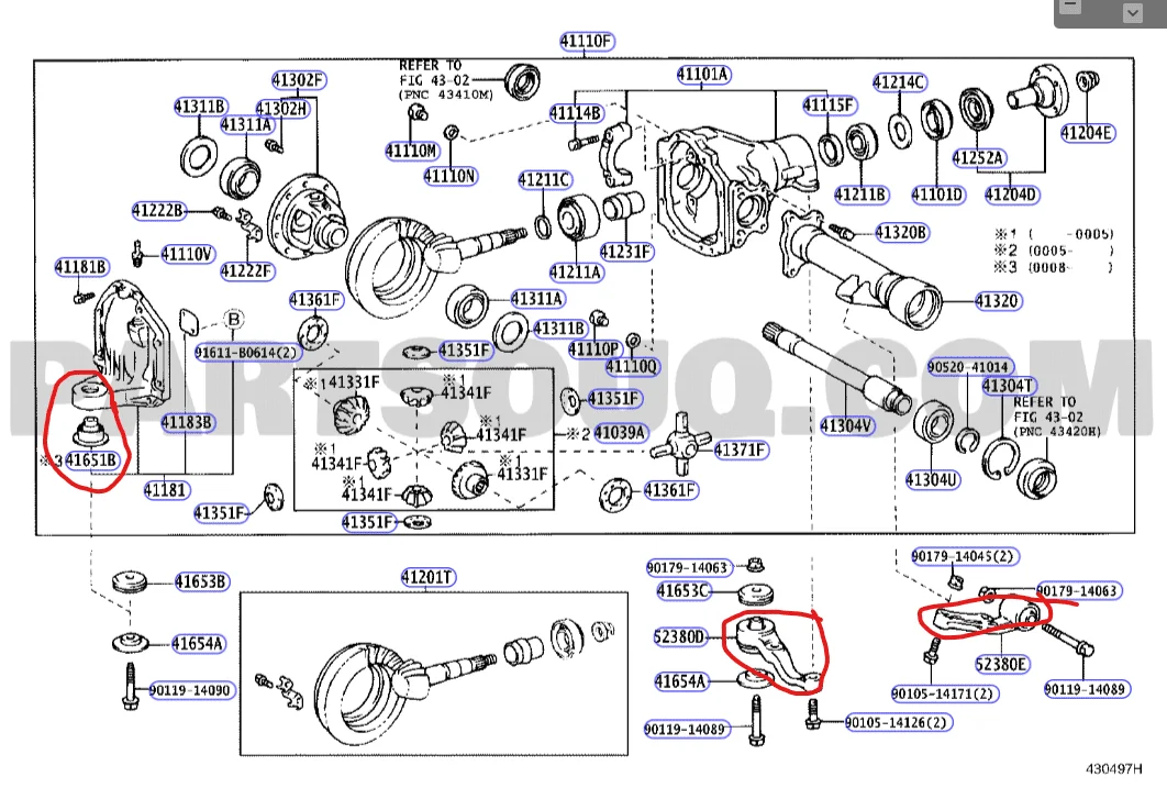

I replied to your youtube comments, but I think I understand a bit differently here. I think you have the rear arm mixed up with the front bushing.
The common failed bushings are the front lower and the side arm. The side arm is only available from Toyota as a preloaded assy with the arm/bushing ( 52380-60040 ). The front lower is available as the individual bushing ( 41651-60010 ) or the full assembly with the diff cover (multiple part numbers). If you want to do the full assembly, you will be removing the diff cover. I would not do this. Just fight that lower bushing out on its own.
The 52380-60030 part number is for the rear arm. In my experience (a 99 with 280k miles and an 06 with 218k) the rear arm was fine both times. The other bushings were terrible. The little pucks (stoppers as Toyota calls them) never looked too bad, but they're cheap enough that I think it's silly not to replace them while you're in there.

For sure that helps alot , been digging into this today and just trying to verify part numbers
My budget will dictate just doing the fronts for now, and based on your input sounds like I've got the two part numbers needed for that .
Maybe just suck it up and replace the side arm assembly as well but the piggy bank has been low
As for fighting the bushing out VS replacing the entire assembly up front , your advice sounds good just deal with replacing the bushing.

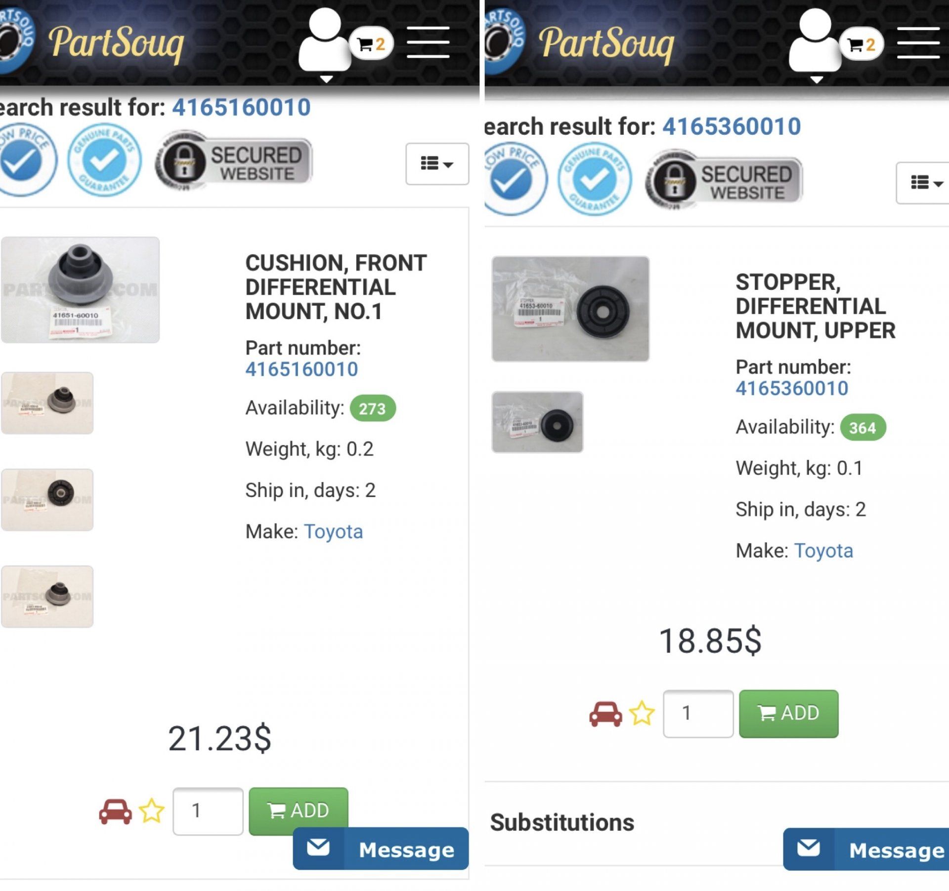

partsouq:
