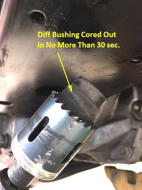

IF you are equipped to do so, then 'boring' the center section out first will allow for MUCH easier deformation of the metal shell and removal of the old bushing.
An 1-5/8" hole saw in a 1/2" drill makes short work of it.
Coring the old bushing is absolutely brilliant. Followed this advice and had the bushing in and out in 30 minutes, including cleaning and polishing the gouges in the housing. Thank you!!!

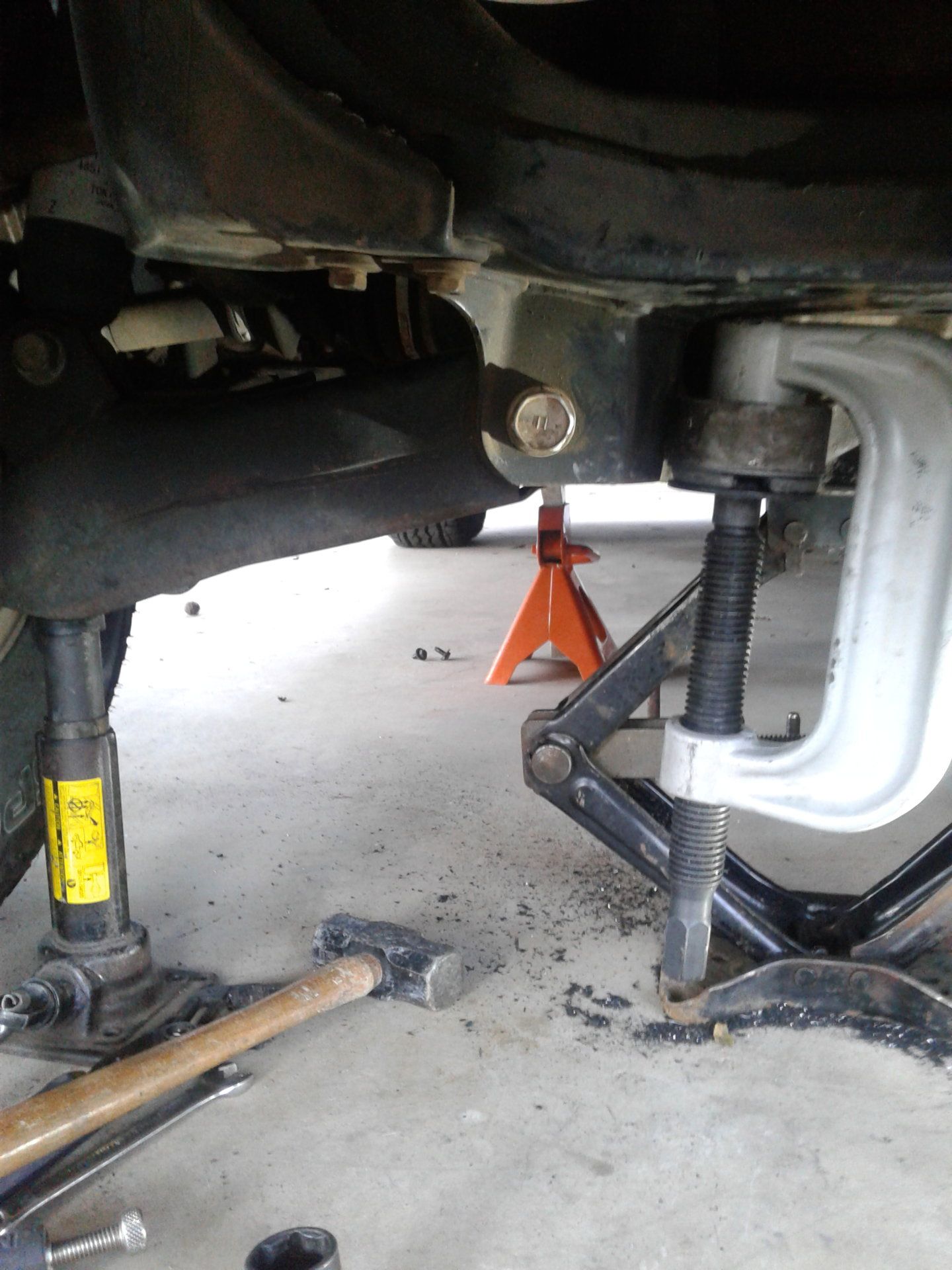

Finally after 1 month. Out with the thud in with the no-thud.
Started at 8am was done by 10:30am. Used a cold chisel and a 6lb sledgehammer to slowly pry it out. Took me about 1.5hrs to do it.
Now instead of using the ball joint press that I loaned from O’Reilley’s, I used my hydraulic floor jack to press/push UP the brand new oe cushion bushing on its spot until it snapped (but it still had about 4mm gap and wasn’t fully flushed in). I then further pressed it in the by tightening the bolt until it flushed right.

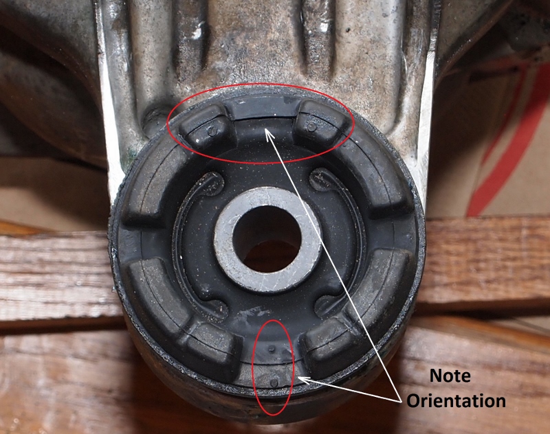

Also note THERE IS ORIENTATION DOTS!!! PAY ATTENTION!!
What are the orientation dots?
'Two Dots' to the front. Single dot to rear. Who knows why....but that's how it is. :confused:

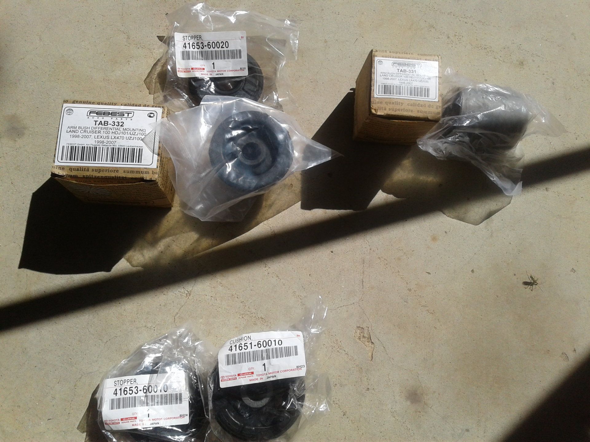

I replaced all differential bushings in a matter of 2 hours or less!
This thread is for demonstration purposes only:
Used parts are shown in the first picture (bottom for front end of the diff, top left Pass side and top right driver side): OEM and Febest for two arms (332 for Pass side and 331 for driver side)

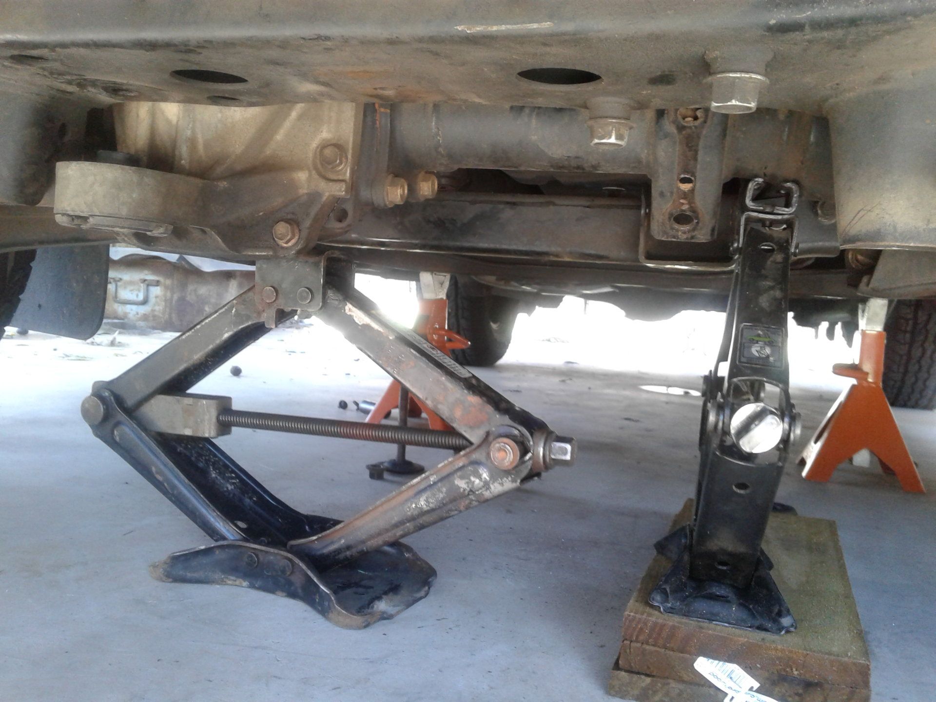

I jacked up the front passenger end and choke the rear wheels WITH park brake applied.
Removed both skid plates
Placed two jacks under the diff as shown in the picture
Removed all 19 mm bolts and nuts.
Note or mark the orientation of bushings before removal.

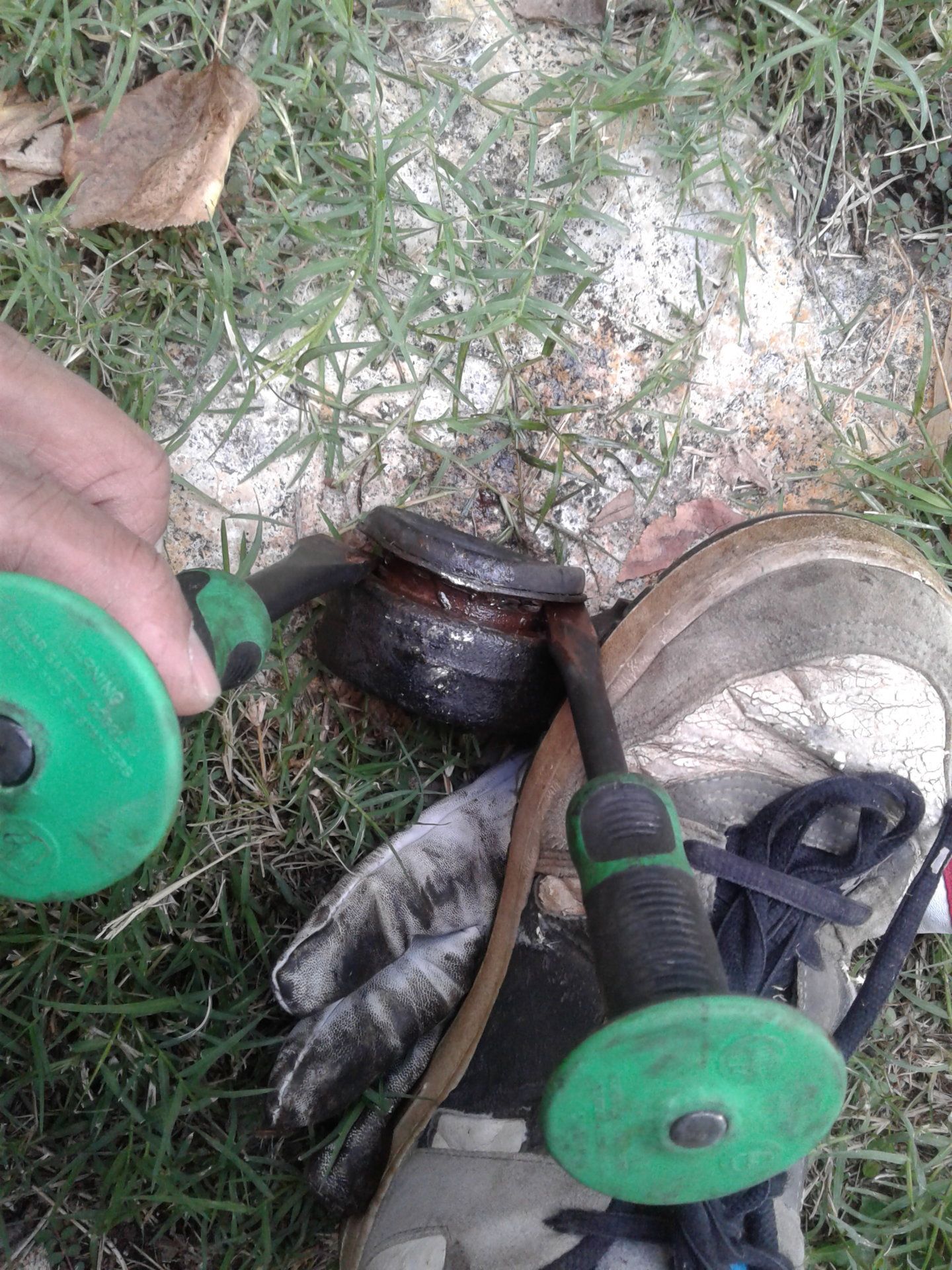

KEY STEP: Drove two flat chisels (even flat screwdrivers might work) on exact opposite sides of the front diff housing bushing (spraying some lubricant might help). Tap a chisel little and then do the same on the chisel located on the other side. Continue to do so and the bushing will come out easily. There is absolutely NO need to drill or burn the inner rubber bushing to insert a saw blade. The same process is used to remove the bushing in the arm on passenger side (right side); pretty easy removal.
The driver side (left side) arm bushing came out after removing the inner sleeve/rubber and cutting the outer sleeve.

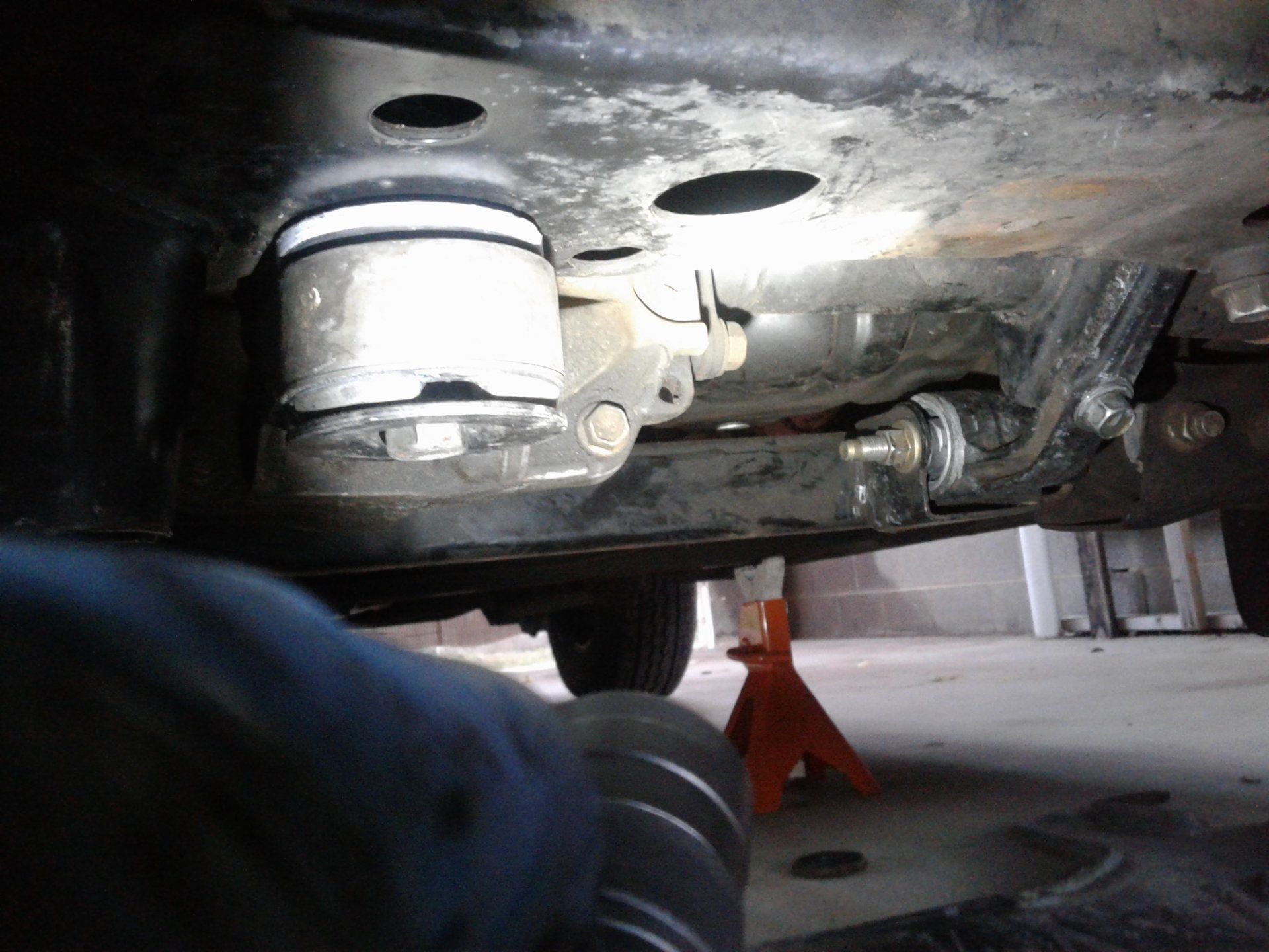

Applied all mating surfaces with anti-seize and installed the front diff bushing as shown. Used the Bottom washer on the front bushing to keep the ball joint separator tool centered and just turn. The bushing went in without much effort!
I used my 20 TON (10 TON would do) press to install the passenger side and driver side arm bushings
Do you have the part number for the bushing under the stopper (41653-60020) and to the left of the Febest (Tab-332)

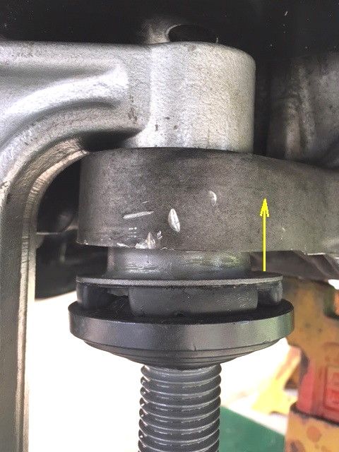

Just completed replacing the bushings, thought I’d share a successful technique I used for pressing the front cushion into the diff housing that I haven’t seen in this thread.
I didn’t succeed at using a floor Jack and didn’t have immediate access to a ball joint tool. As I looked at the bolt, I’m thinking I could use it. So I cut two 3” long pieces of 1/2”x1/2” stl bar and placed it between the diff housing flange and the underside of the cross-member (placed both spacers parallel to the axles, one to the rear of hole the other to the front lip side). The stl spacers will keep the diff aligned and perpendicular to the bolt as it’s compressed. The bolt is long enough that it can be threaded in by hand about 1/4” with the washer and bushing. Once I got it started I used a socket to tighten it by hand, It started in a little crooked so lightly tapped the face of the washer with a hammer to correct its alignment and it kept moving till about an 1/8” from being fully seated. I then switched to an impact and drove it to being fully seated.
Now that the cushion was installed I backed the bolt out, removed the stl bar spacers, installed the top stopper and bolted it back together.
Went really well for me, super easy. I did use grease and made sure to clean the diff housing really well removing any burrs on the mating surfaces. Hope this helps and adds to the quiver of tricks.
