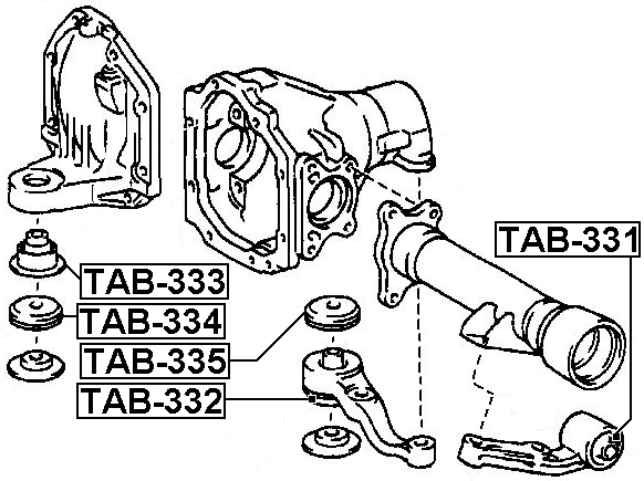

Febest: TAB334 for the upper stopper
Febest: TAB333 for the bushing.

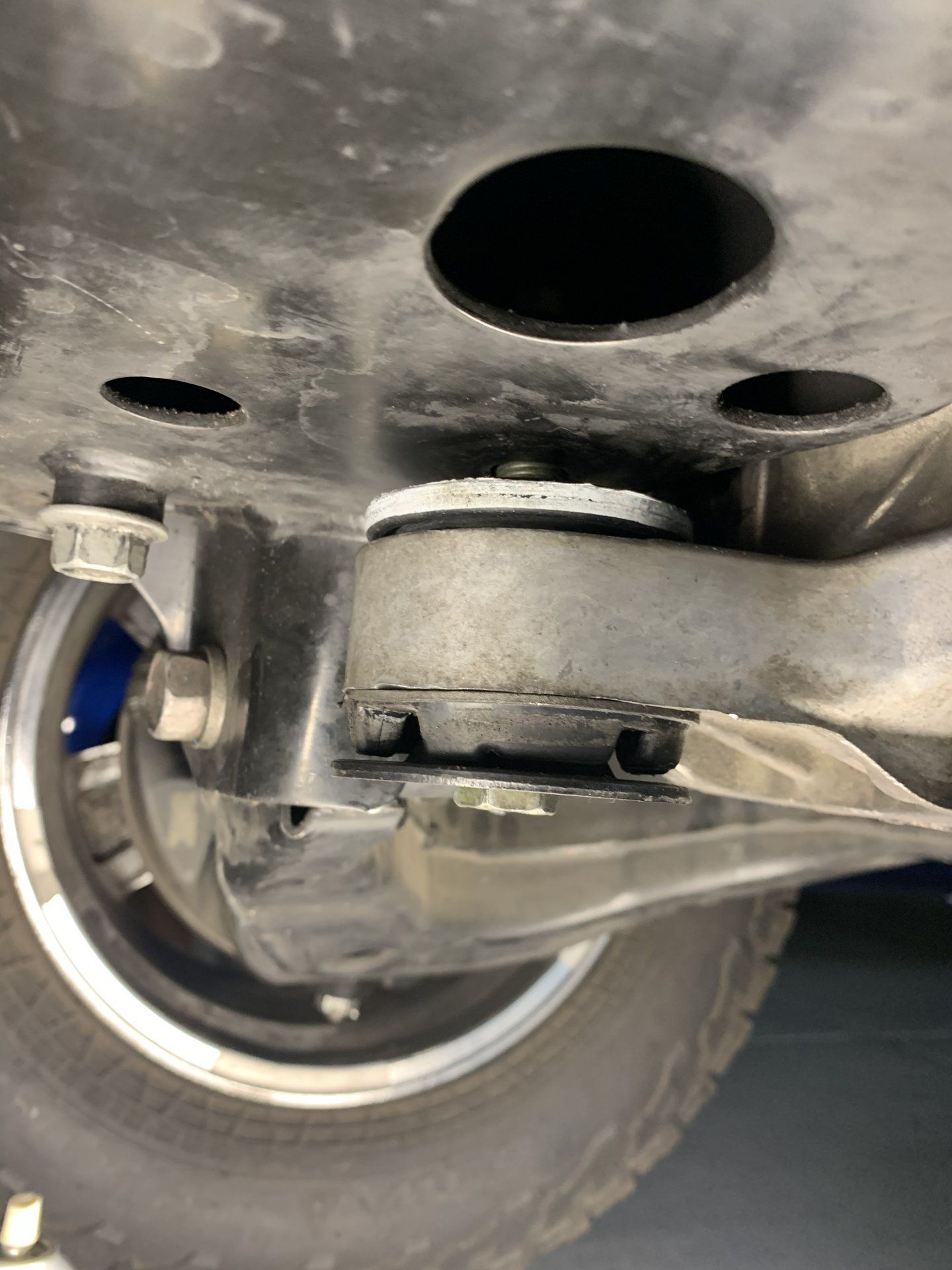

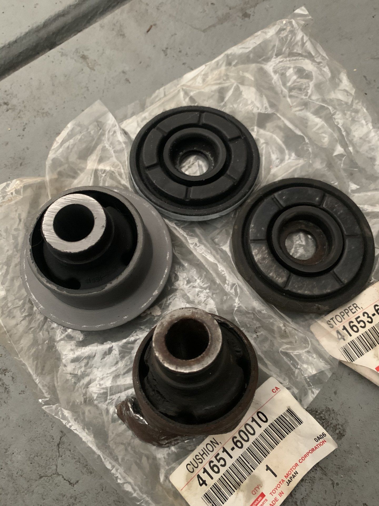

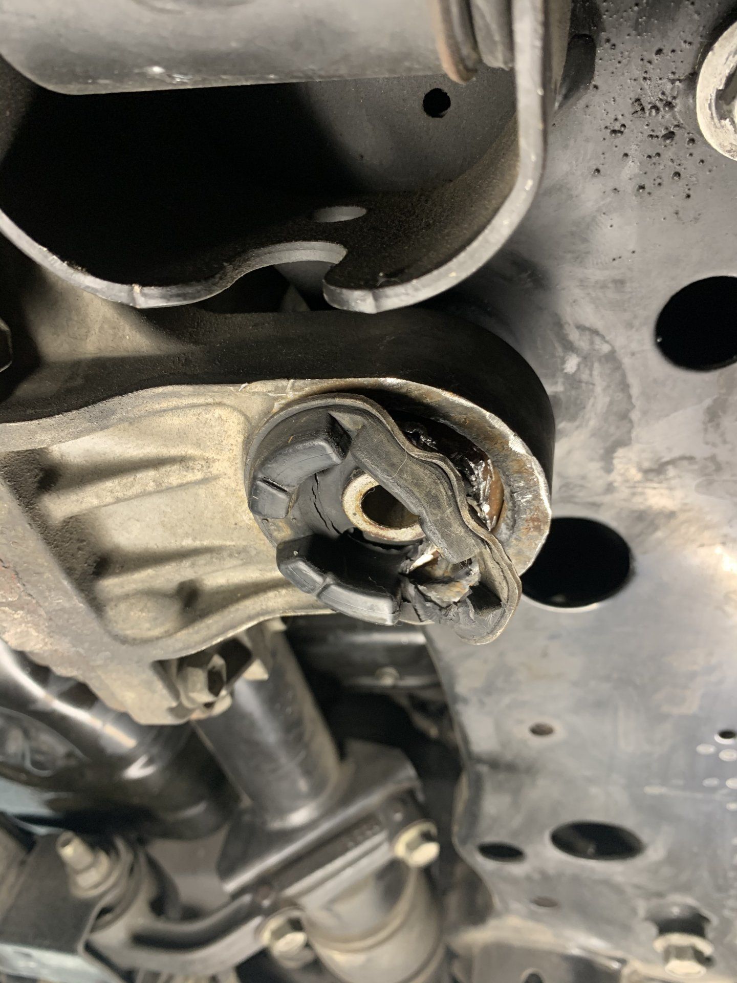

Finally after 1 month. Out with the thud in with the no-thud.
Started at 8am was done by 10:30am. Used a cold chisel and a 6lb sledgehammer to slowly pry it out. Took me about 1.5hrs to do it.
Now instead of using the ball joint press that I loaned from O’Reilley’s, I used my hydraulic floor jack to press/push UP the brand new oe cushion bushing on its spot until it snapped (but it still had about 4mm gap and wasn’t fully flushed in). I then further pressed it in the by tightening the bolt until it flushed right.
