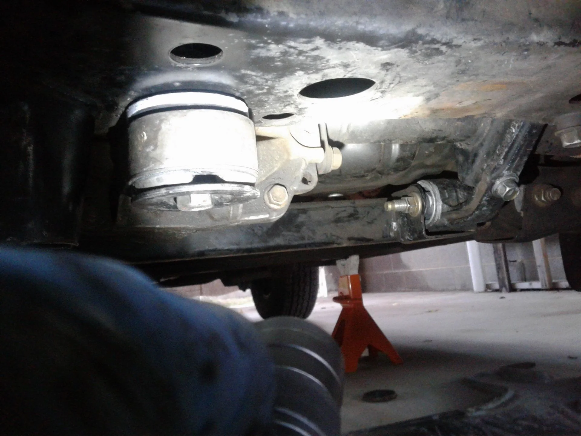

Used parts are shown in the first picture (bottom for front end of the diff, top left Pass side and top right driver side): OEM and Febest for two arms (332 for Pass side and 331 for driver side)
I jacked up the front passenger end and choke the rear wheels WITH park brake applied.
Removed both skid plates

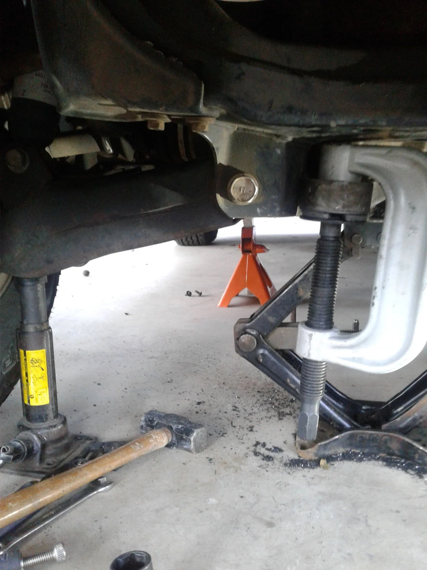

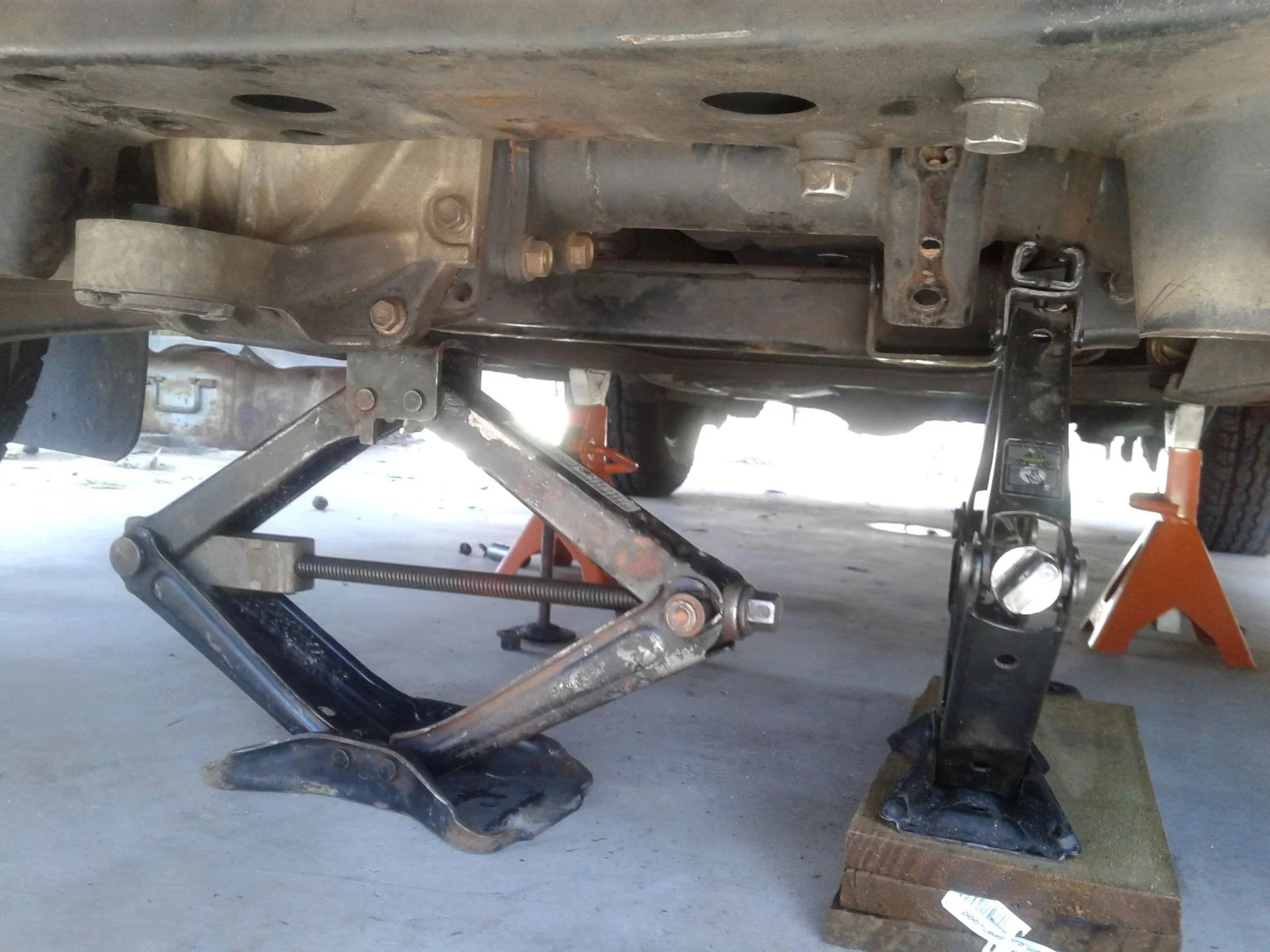

Placed two jacks under the diff as shown in the picture
Removed all 19 mm bolts and nuts.
Note or mark the orientation of bushings before removal.

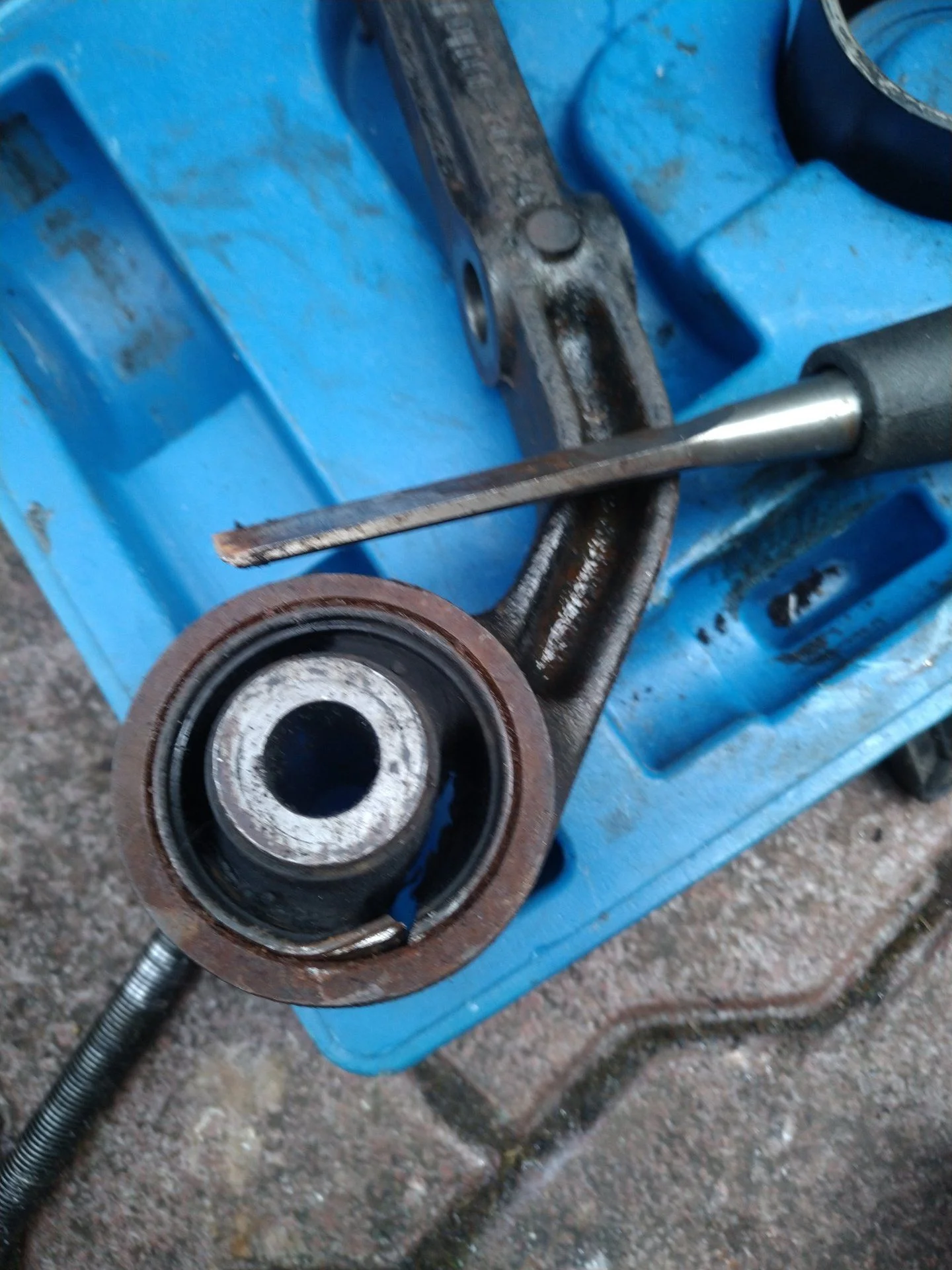

KEY STEP: Drove two flat chisels (even flat screwdrivers might work) on exact opposite sides of the front diff housing bushing (spraying some lubricant might help). Tap a chisel little and then do the same on the chisel located on the other side. Continue to do so and the bushing will come out easily. There is absolutely NO need to drill or burn the inner rubber bushing to insert a saw blade. The same process is used to remove the bushing in the arm on passenger side (right side); pretty easy removal.
The driver side (left side) arm bushing came out after removing the inner sleeve/rubber and cutting the outer sleeve.
Applied all mating surfaces with anti-seize and installed the front diff bushing as shown. Used the Bottom washer on the front bushing to keep the ball joint separator tool centered and just turn. The bushing went in without much effort!
I used my 20 TON (10 TON would do) press to install the passenger side and driver side arm bushings

Just finished this. An air chisel made a huge difference, super easy for the front and pass side mounts. I actually bought the Maddox ball joint clamp press from Harbor freight.
Worked like a charm to install the front bushing. I used my h frame press for the rest. The #5 (i think) in the kit sleeve was a perfect fit for pressing in the SuperPro driver side bushing.

The two scissor jacks you have in the pic are just supporting the diff correct? This front one is on the next "to-do" item list.
Yes, a chisel took it out. make sure to drive it out symmetrically. Correct used a scissor jack.
