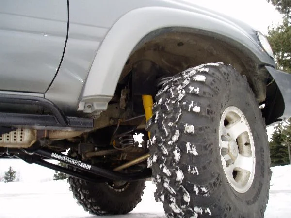

Also, we are going to be testing a 4" setup with control arms in the next couple of weeks. Then we will see if we can run this with control arms and stock driveshaft.
Kinda like this? ;)
We completed our first actual trail run in the LX. I'm in luv with this truck! I absolutely luv the added suspension lift height (despite the reduction in wheel down-travel compared to my 80). I WILL find the solution for this truck and am contacting Mr. Slee on Monday. :)
