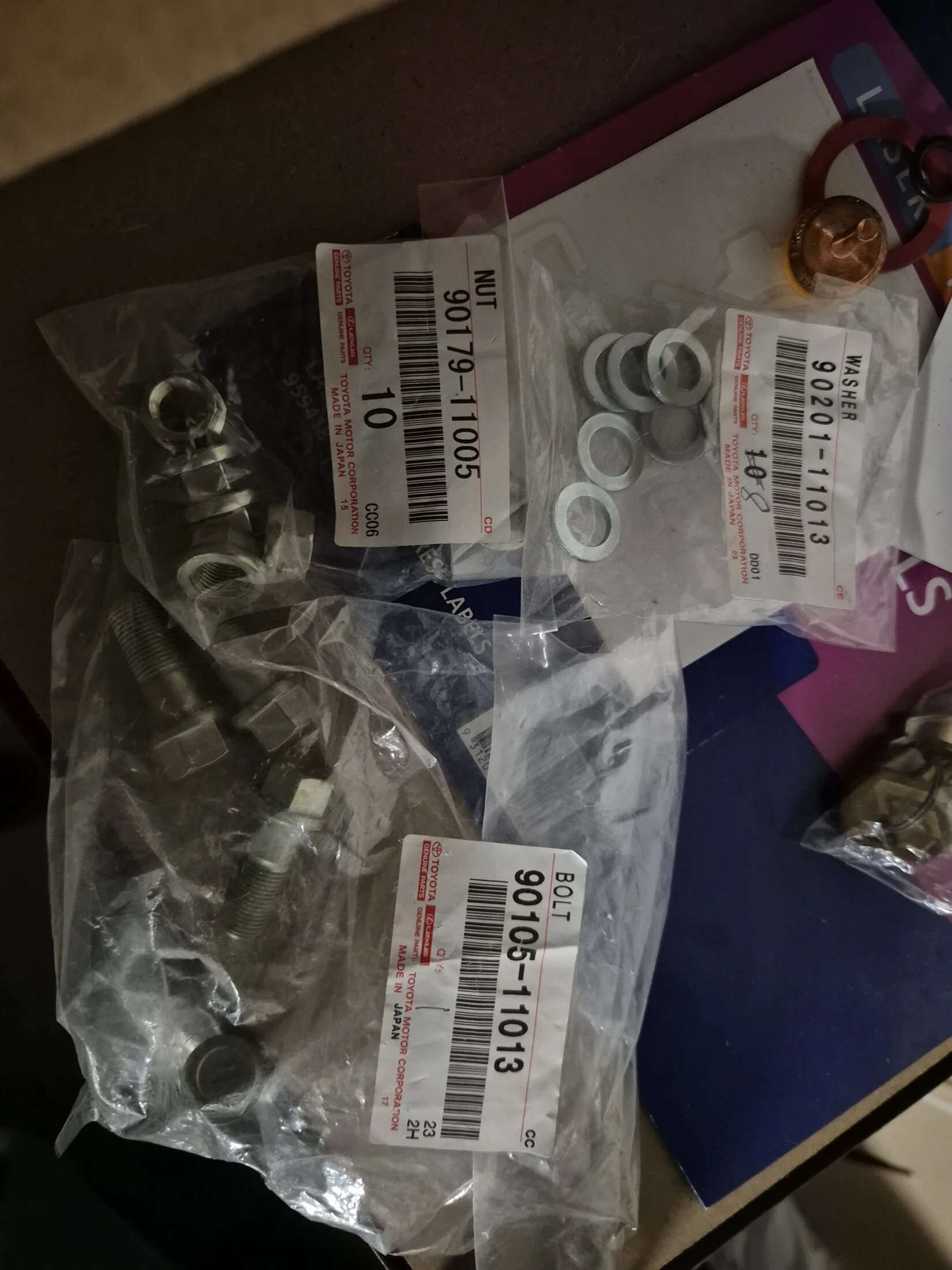

Bolt: 90105-11013
Nut: 90179-11005
Washer: 90201-11013
A full set of 4 will set you back $22.

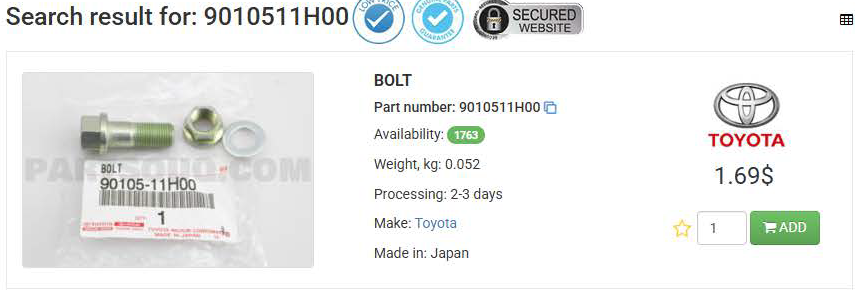

The Toyota hardware for the rear drive shaft comes as a kit (Part No. 90105-11H00): one bolt, one washer, one nut. PartSouq currently sells each kit for $1.69, but that part number doesn't show up if you search with your VIN.

90105-11H00 Comes as a kit: one bolt, one washer, one nut. About 50% cheaper than getting the part numbers separately. You need 8 of these.
