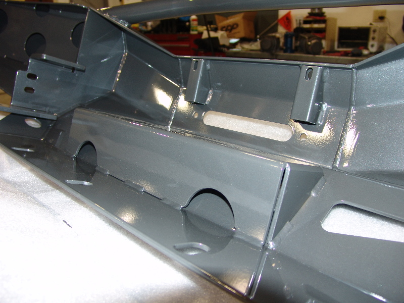

This is the business end of the bumper.
That is what is needed to support a 12k lb winch in the bumper. All that would have to be duplicated in steel to make a cradle. Once you do that, all you really have that is AL vs steel is the wings.
The blueberry design would be cool in AL if we forgo the winch.
I doubt the weight savings is going to be that much. Blueberry bumper is 172lbs, heavier than Sahara and 03 and later combo. Not heavier than the 02 and earlier combo.
