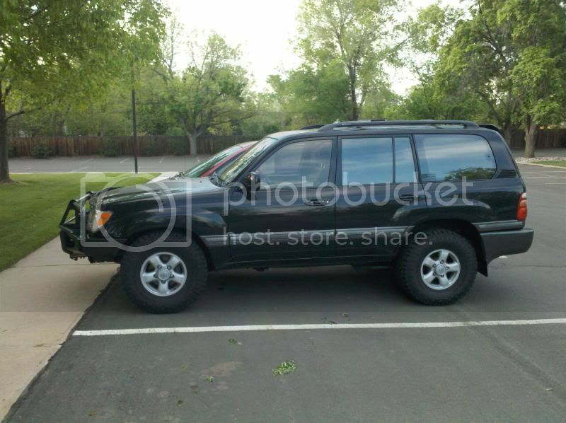

What I’d like to build may not suit the die-hards. I’m a firm believer of moderately enhancing a car without going overboard in any particular direction. To keep some semblance of balance especially given my 95% on road use.
I don’t want to go down the route where added armor automatically means changing out my suspension. As much as people like to complain about AHC, I really do like it in my truck and do not want to sacrifice it’s flexibility. I like the ride and handling options it affords me. With VVTi, my truck is actually not slow and I can drive and pass when and where I need at highway speeds on two lane roads. I don’t want to laiden the truck to where it becomes a tank and a choir to drive in the mountains. (Any driver that appreciates any type of cornering performance will feel 60 lbs hanging off the front end btw.) Yet it doesn’t mean I don’t want the added protection and safety of a winch bumper when traveling alone. There is definitely a place between tank armor and the stock tupperware. Think overlanding vs. rockcrawling.
My ideal build would be a front bumper winch combo (+150lbs), sliders (+80lbs), minor TB crank front and coil trim packers at the rear along with sensor height adjust for a minor static lift (.75”), and the 32.6” tires I have. This should still give me the full weight carrying capacity of stock. Possibly augment it with rear bags if I find myself packing heavy to reduce strain on the AHC bulbs and always allowing me to get into high clearance mode.
This should give me 90% of the capability of a 6000+ lb tank. Without undue compromises to on road performance.
I like to have my cake and eat it too which is why I bought into the LX470 in the first place.
