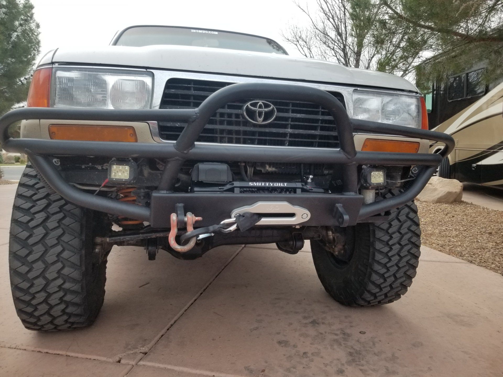

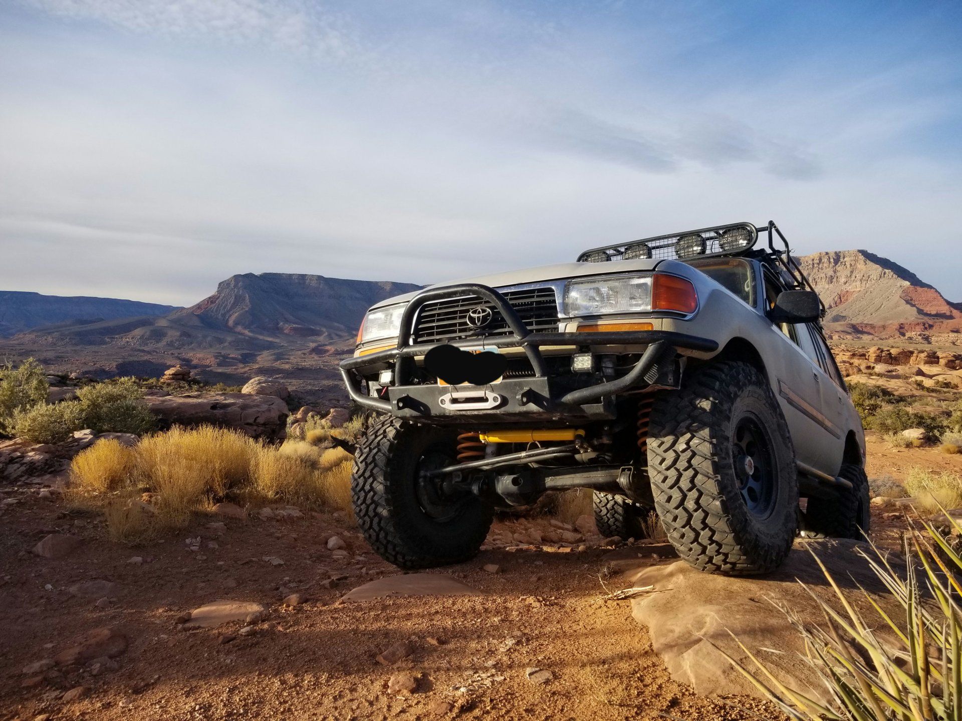

Here is a picture of the metal tech front bumper on my current rig. I really like how light weight this bumper is. I have 3 inches of lift on this 80 and I was still worried about hitting another mule deer so I added another set of bars that sit in between the signals and headlights. From my experience this modified bumper will protect my front end from mule deer strikes (these are the big concern in my area) as long as they aren't jumping when I contact them.
Before modification:
After modification:
I'm not saying you shouldn't get one of the bumpers you listed, just trying to give you food for thought based on my critter smashing experiences.

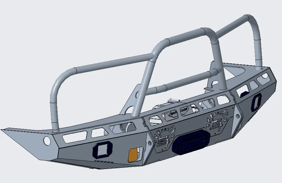

Have you seen the Dissent front bumper? There is currently a group buy going. Costs more than the ARB and Ironman bumpers. The Dissent bumper starts at $1395 plus options...bullnose, stinger, lights.
I have been following this and I do really like the appearance and function. My concern with this one is shipping logistics and how soon they'll be ready. In my mind I'd like to have the rig "done and ready for 2021 camping and wheeling season" by May.

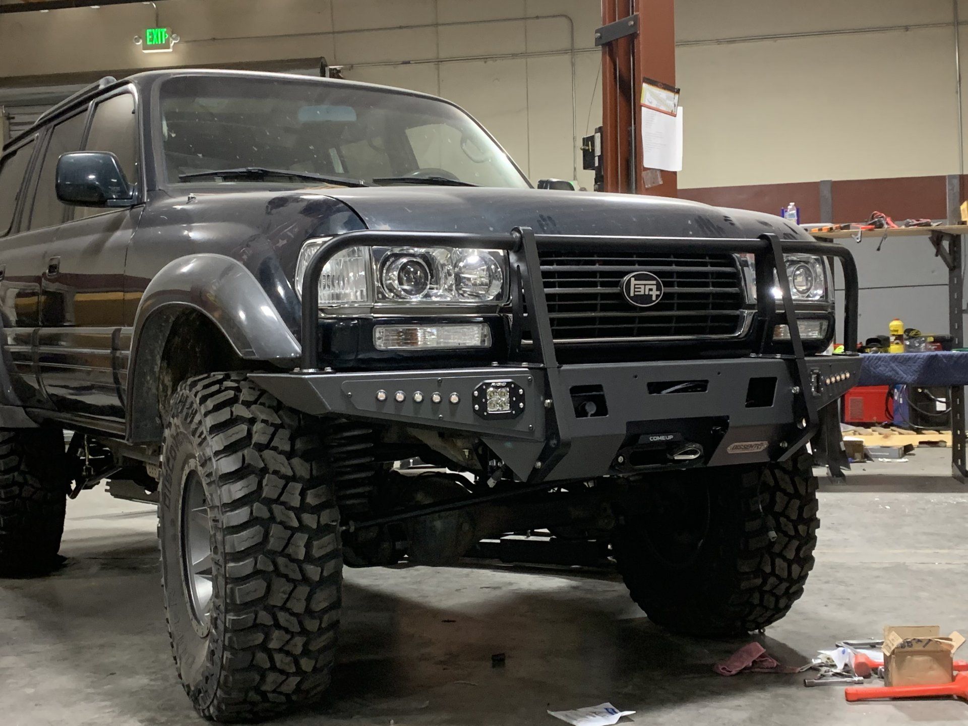

I have on order a Delta VS front bumper.
It is probably the most expensive front bumper out of the bunch
Delta Vehicle Systems - FJ/FZJ80/LX450 Front Bumper
I think this one would eat up my winch budget, but it does look very well made. Appreciate the suggestion!

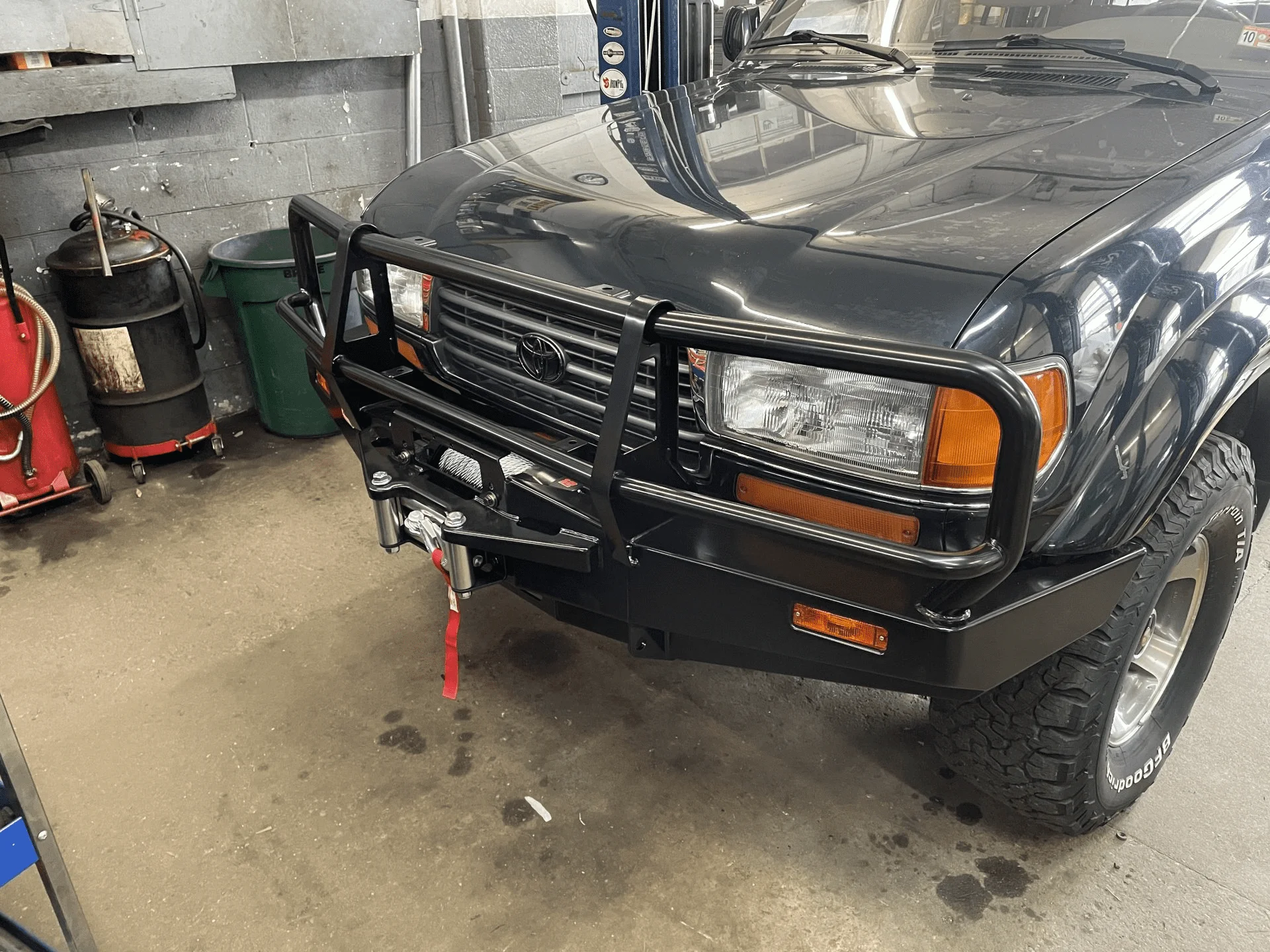

I just installed that winch in a ARB. I used a spacer kit that was about 3/4".
This was the exact thing I was hoping to hear. Did the spacer kit come from Warn or similar?
