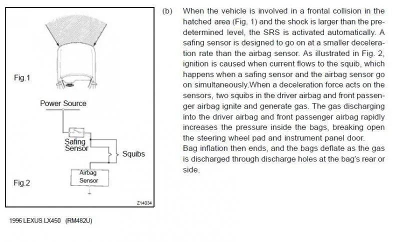

I have a previous post from a long time ago about this, I think it even had the documents relating to the activation. Basically, there is a deceleration sensor near the center console , if conditions are right, and the system is armed, then a accelerometer will trip the airbags if the sensor detects a specific deceleration. Basically, the sensor is in the cabin next to you, so whenever the appropriate deceleration reaches it, it will trip the airbags, regardless of what is on the front of the vehicle.
EDIT: here are some excerpts from the FSM
Airbags (SRS, actually) are designed to work with your restraint system so never drive in an SRS equipped vehicle without seatbelts expecting them to protect you.
SRS systems use a sensor or sensors to detect deceleration of the vehicle. Some systems have one or more in the area behind the bumper to detect the impact slightly earlier than sensors placed in the center console area, which nearly all have. They compare notes in milliseconds and if 2 or more don't agree a collision is happening the system won't deploy the airbags. Some newer systems use a single sensor in the console area as experience and reliability were proven for sensors over the years, allowing this strategy.
Roughly speaking, the threshold speed is about 15mph into a solid object such as a wall, tree or bridge. Also roughly speaking, the impact must come from the front within 15 degrees to each side of dead center for a swath of about 30 degrees.
The ARB bars for the 80 were not put through the expensive testing procedure to certify them as this was a time when SRS was just appearing on the scene. Later 100 models and beyond may have been. Adding the bumper adds structure to the front end that is extremely helpful in minor collisions to prevent a disabled vehicle and stranded occupants such as a deer strike or fender bender. In severe collisions it would most likely offer even more help by tying the front frame tips together securely and helping ensure the tough frame continues to be involved in resisting crush as the front end collapses. Without it, the factory bumper basically gives up early in the crushing. This is all theoretical and the wide variety of crash factors make the extent of help impossible to estimate.
I have a background in vehicle design and personally feel they're so effective that I put one on both our 80s specifically for increased crash protection - not for offroading. If my wife is out with the kids on a lonely dark road and wacks a deer on the way home, I want her to remain mobile with headlights and radiator intact despite severe damage. Ditto a minor fender bender in a bad part of some town. I don't want her sitting immobile under any circumstances - rural or urban. Those safety issues are even more likely to benefit us from having an ARB than the severe crash scenario, and they all contribute to total vehicle and occupant safety.
How would an ARB affect SRS deployment? Hard to say as there are situations I feel it may deploy them faster or earlier and other situations it may slightly delay SRS deployment. Overall, I think the total safety is improved with having an ARB.

As far as I have been able to tell, it means they have not been tested with airbags, and they do not "accept" liability, if you are using the bumper on an airbag equipped vehicle. It doesn't mean it will/won't work, it's just legal stuff to protect them from a lawsuit.
x2^^ to IdahoDoug's comments...I feel much safer with my Slee Shortbus bumper, as compared to the tin-can-thin OEM one (which was bent by the PO in a parking lot). I too live in the country, and my wife has hit a deer before with our previous 4x4, and likely that will happen again. Better to be able to drive-away, then have to call a tow-truck.
Back to the original question...since the system is triggered by the accelerometer in Post #3 (which I have had to replace), I am confident that the SRS system will work no different from the factory setup.
