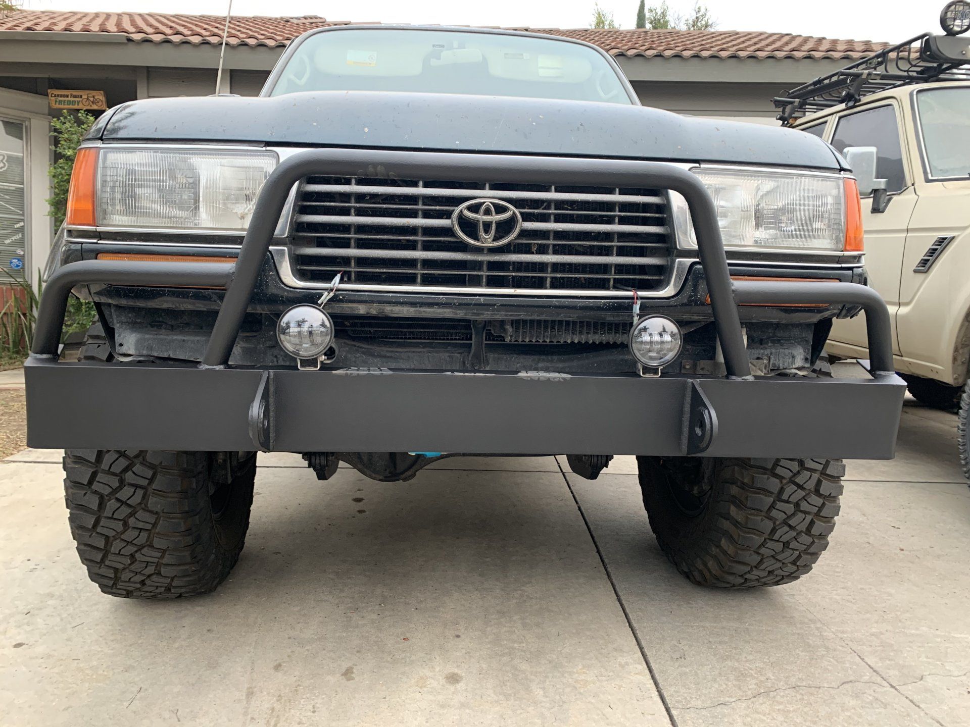

If you want protection get a piece of channel.
It’s not pretty but does the job for 98% of its driving. I may trim the corners to give it a better approach angle. Nothing is going to be stronger then channel for the money. It’s structural steel!
