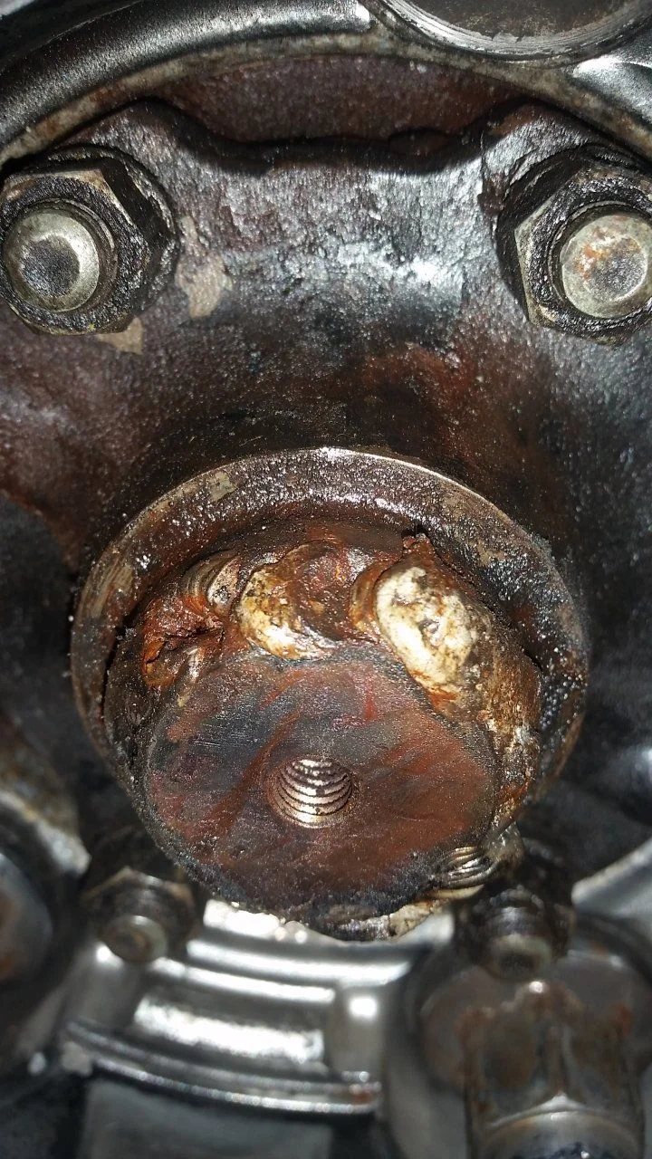

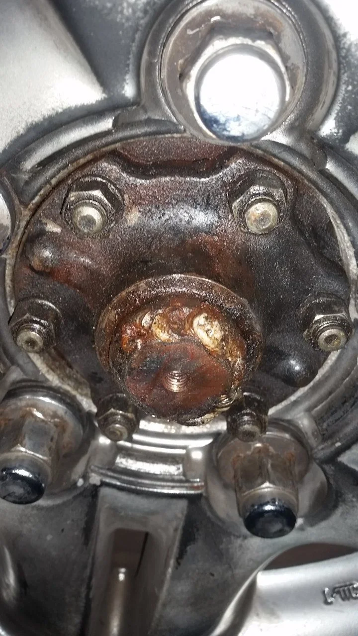

Rather than replace worn out (teeth) hub flange and front drive shaft(s), someone welded them together. Or it was a welders idea of a snap ring.
You'll need grind or cut off the weld so hub flange can be unbolted and slipped off. Then replace all damage parts.
I've seen some unusual fixes but this one takes first place.

No other way besides to grind it off ?.What parts will i have to change beside hub flange by this you mean( front wheel axle bearings and hub were the 6 bolts a bolted ) ?steering knuckle etc.Lucky bearings a still good.Sorry guys new to this.

The only good way to solve this is to get new CV-shafts, new flanges, and related parts like snap rings, cones/nuts and oil seals. Then grind the weld away and hope that the bearings are ok.
That there is not a repair, it's violence.

I think that's what my mechanic suggested new cv shafts best way and wheel hubs .Bearings a still good no play or vibration but now I know what I'm up for come the time.Really poor workmanship to that.
Def an asshat move by the PO... A grinder will get that off with a lot of time and patience.
Not going to be able to use a snap ring w/o serious machining.

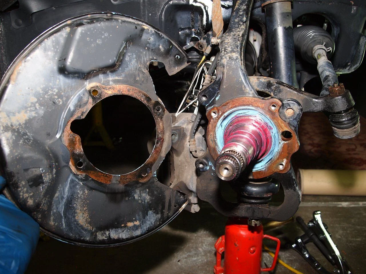

This picture you can see how far axle comes out past spindle threads of steering knuckle. The rubber ring on axle is not part of assemble, it a Slee - Spindle Grease Tool seal form Axle needle bearing & bushing greasing tool.

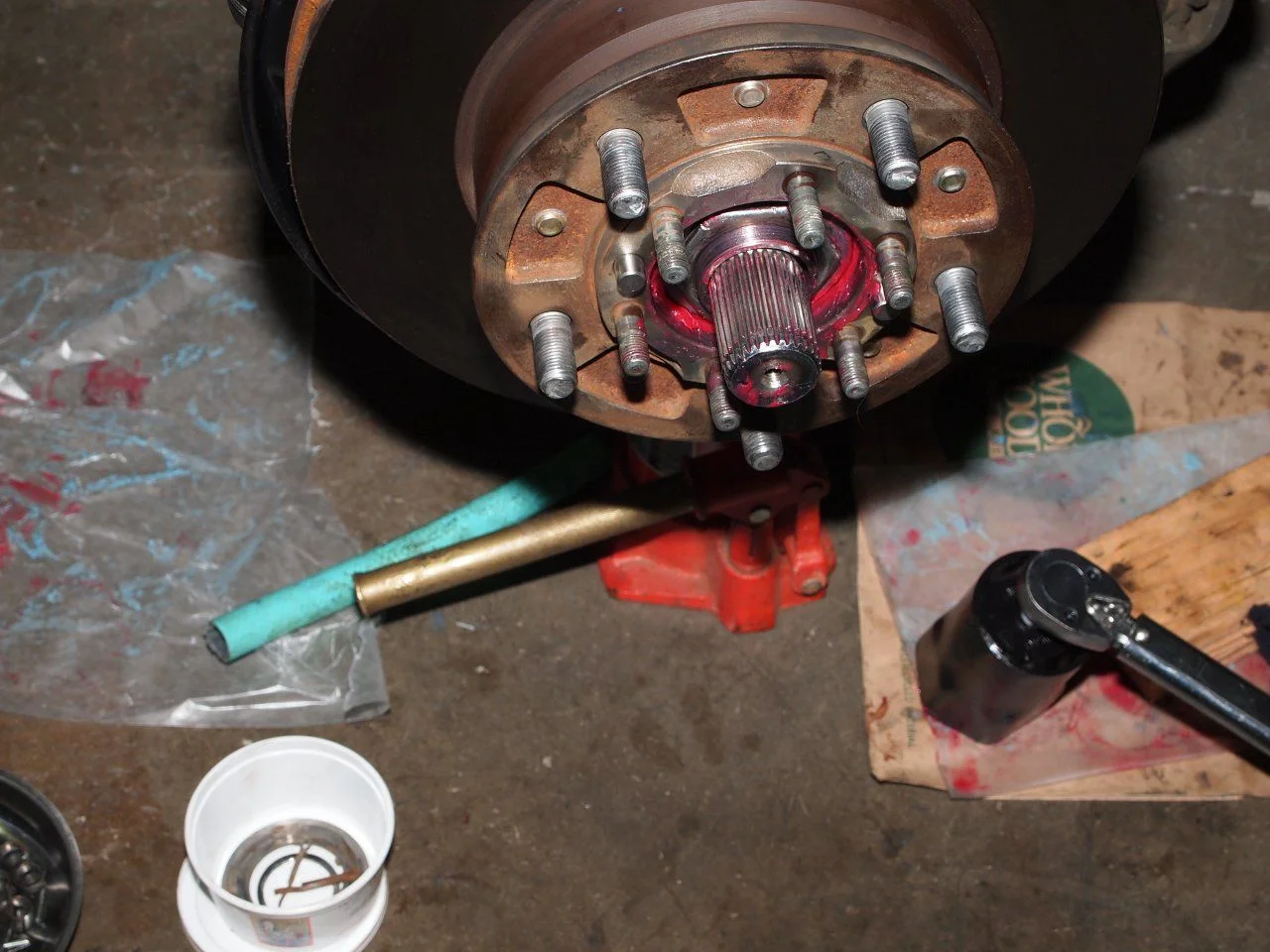

In this you can see wheel hub on steering knuckle with axle coming through steering knuckle spindle.

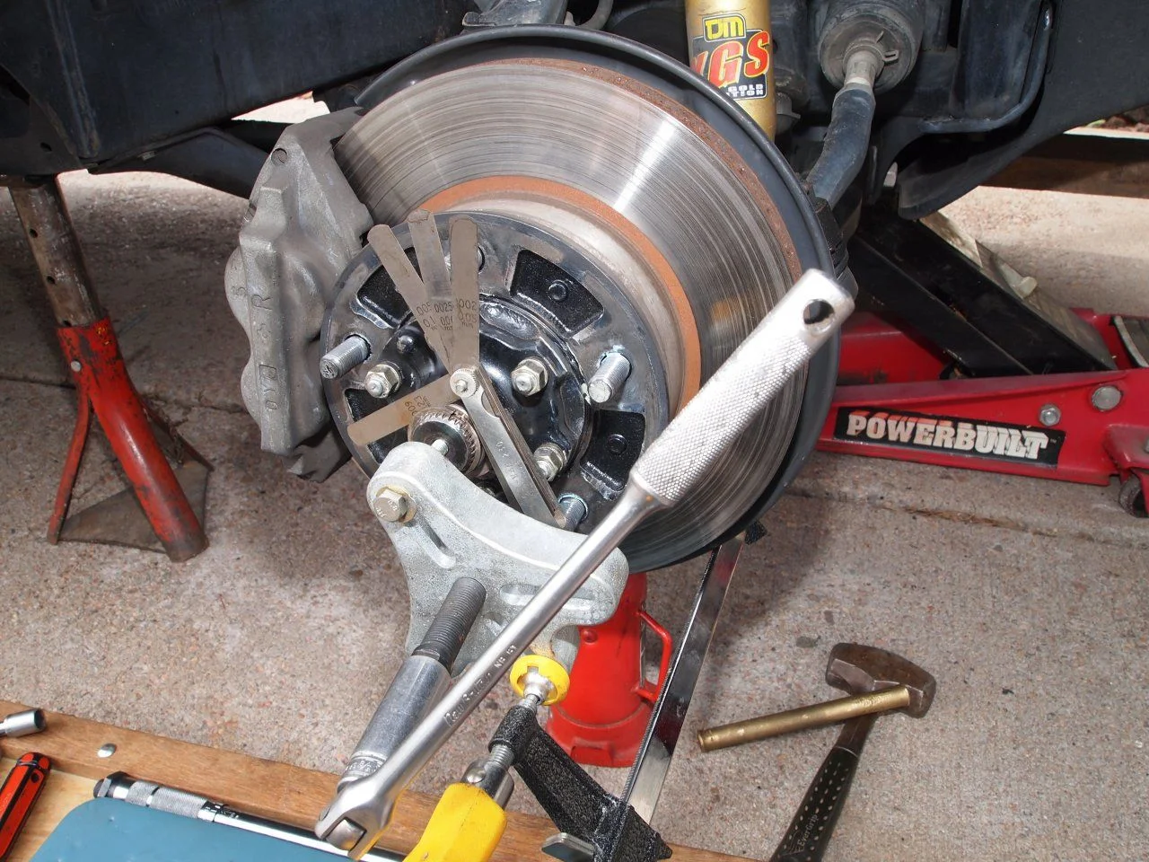

Testing preload:
Testing preload:

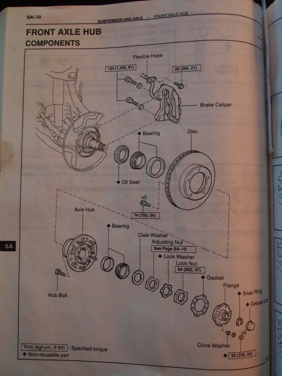

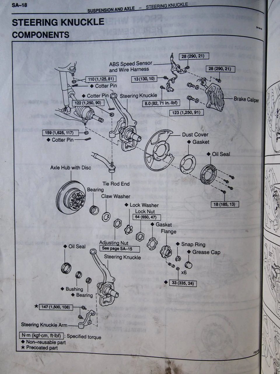

@Dannyboy lx470 this picture along with others above will help you develop a parts list.
Note: The front drive shaft comes in one unit.
