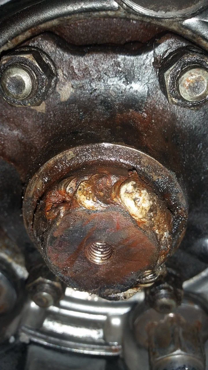

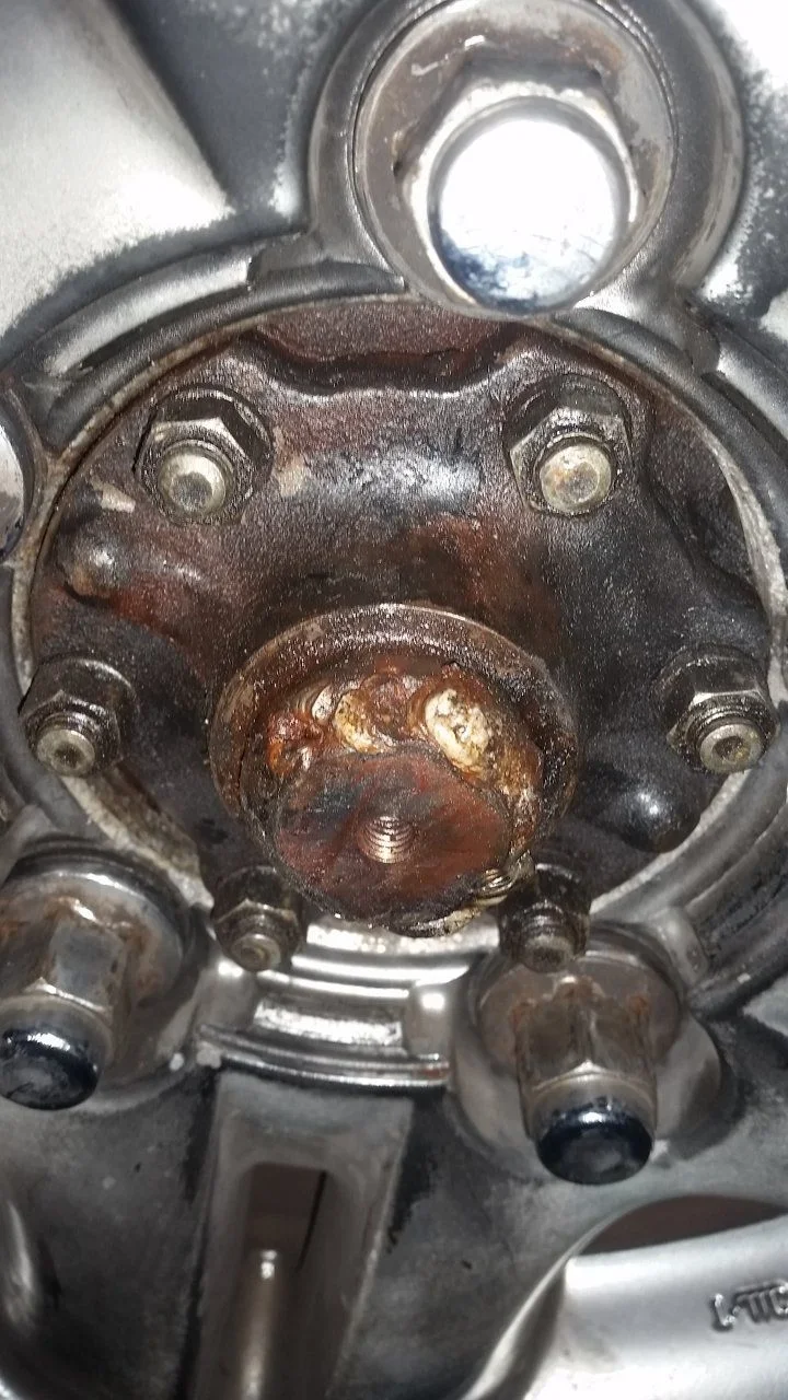

Guys just a question took of my wheels to look at.my bearings and both the cover caps on each side that come off with a screwdriver etc have been mig welded around the cap ????.Never seen this before cannot get cap off.
Wtf. Pics?
Time to get new caps, and then a grinder.
Wow man,
I surely hope that's not true.
Pics please, sorry for ya man but it's fixable.
