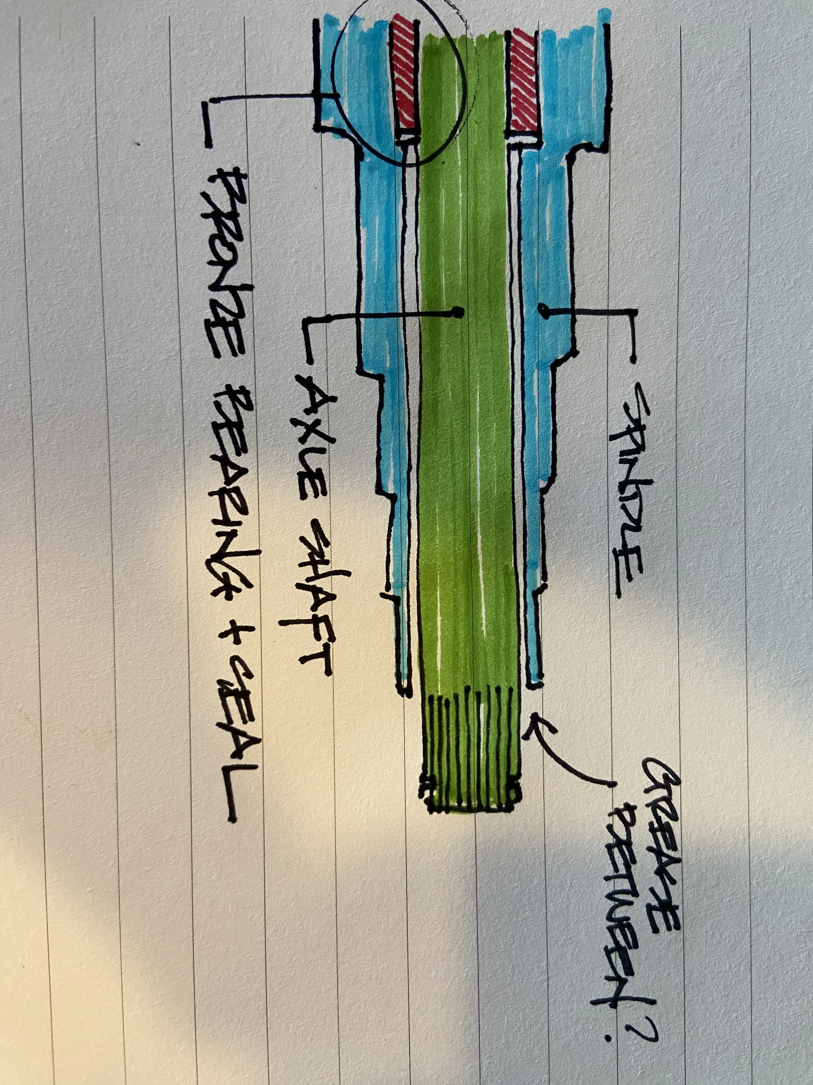

So if I understand how the axle and spindle work, there’s a bronze bearing and seal (in red below) near the base of the spindle (blue), and about 8” of axle (green) spinning inside the spindle, ending with the splines that hold the drive flange.
So should that gap between axle shaft and inner spindle (outboard of the bronze seal) be dry? Does it matter? Can anything inside that gap travel back to the seal and bearing?
Mine is oozing old brown grease plus the bit I mistakenly pumped in. Trying to figure out if I should rinse it all out with Brakleen before I finish the job. I can just get the straw into that gap.
There is a 54 mm adapter with a zirk fitting that is used for filling the needle bearing and bronze bushing with wheel bearing grease. It is the only way I know of to grease that. And it MUST be greased. Here is a link: SLEE - Spindle Grease Tool - Slee Off Road - https://sleeoffroad.com/products/sok1037/ BTW, great drawing…
Interesting. That at least suggests that the gap between the axle and the spindle interior is not supposed to be dry.
But, if (as the Slee video shows) part of the process of using that tool is to push in the axle and expose the bearing by unseating the CV joint (to wipe the old grease that’s pushed out…
…why not just grease the bearing from the back when it’s exposed? Apply some moly with a syringe and let the axle shoulder push it into the bearing when you re-seat the CV joint on the back of the knuckle.
I don’t think that that method would fully pack the bearing and bush. Tool is only $45 so not egregious.
These days, I do more pulling of steering knuckle to restore. Most, I replacing axle needle bearing & brass bushing. Which I grease those by hand.
Slee spindle grease tool works great. I've two of them. Few things to remember:
  • It will push any contaminants on splines, axle or in spindle into bearing & bushing. Contaminants typically get in from, re-use of grease cap. So don't uses if any you can't clean(ed off/out).
  • They need a good amount of spindle thread available. So use before adding lock nut. I typically use, before place wheel hub on.
  • It is best to have air gap, between axle & spindle tube. Just like in wheel hub cavity. So after lubing with tool. One can blow a canal with air gun. But not a big deal.
  • Don't over lube. Just lube until grease start coming out (~1/2" clean grease). Just like you see in the Slee pictures.
Some in mud, have made a spindle lube tool with PVC cap.
