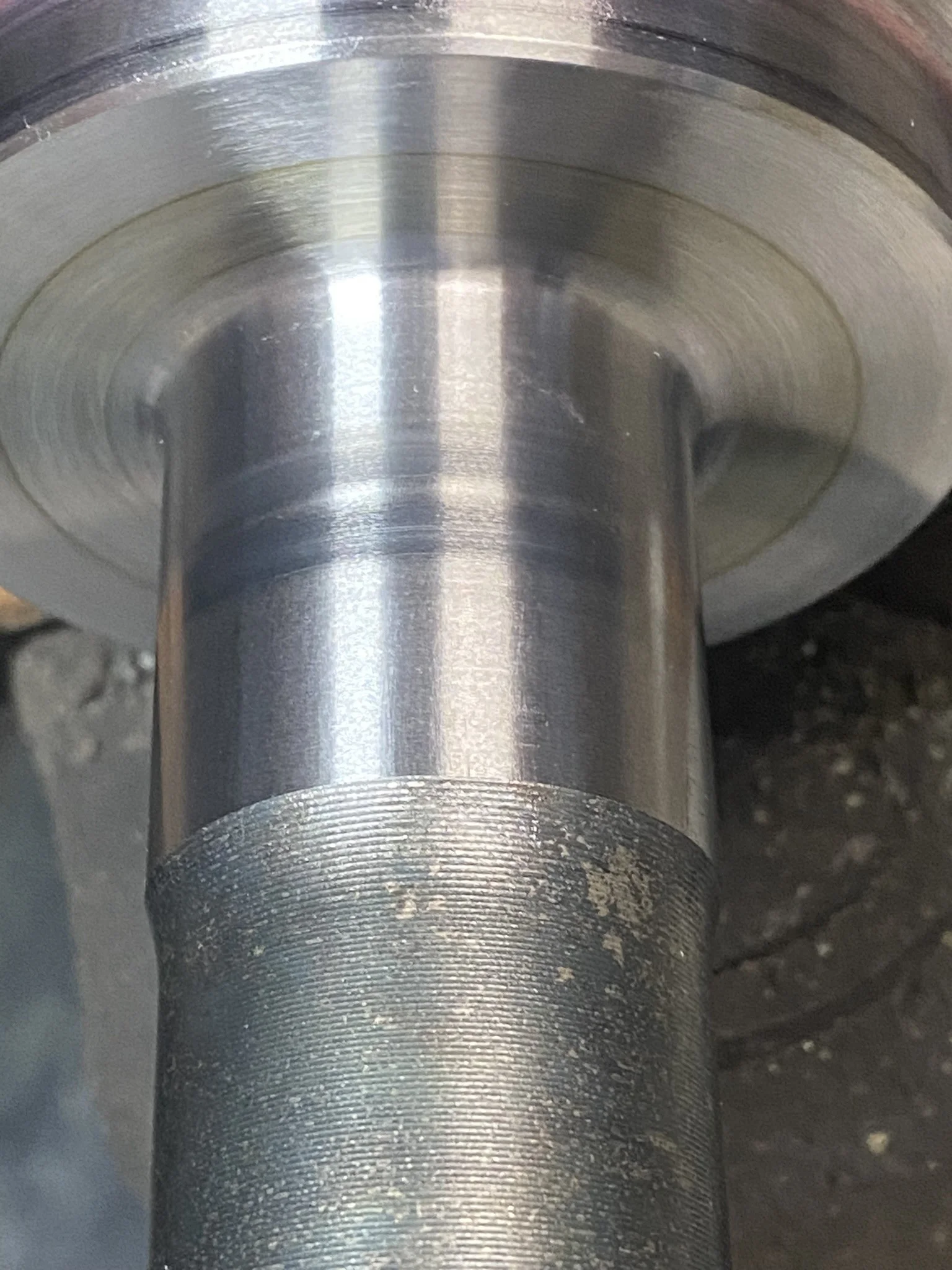

One thing I look at, once axle exposed. Is where needle bearing (AKA spindle bearing) rides on axle. The condition of axle, is a key clue, to health of needle bearing. Looking at needle bearing itself, is very difficult to make the call if good or bad. As @uHu mentioned above, "spindle bearing". Could well be your sounds. I've seen 100 series with ~350K miles, with supper service history at Dealership. With dozen of wheel bearing service in its history. But find the axle bearing and bushing, has never been lube. Most I find, still the factory grease. Needless to say, those needle bearings are shot.
Skipping needle bearing and bushing, while doing wheel bearing service. Will likely mean remove wheel hub again. Since the axle can only be seen, when either knuckle is pulled off or FDS is removed. When doing a wheel bearing service. It is the best use of time, to remove the steering knuckle while in there. Coming back to do later, is doubling labor time.
This was a new FDS with ~about 2K miles. That mild scoring on axle, was the clue, axle needle bearing shot/bad.
It made a sound, heard at low speed. Sounds at higher speeds, where masked by tire, road and wind sounds.
