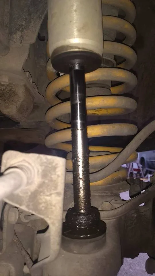

I had one of my FOX fronts, and both rears leak oil as well, stepped up to the ICON stage 1 kit and I'm very happy with it so far. Not cheap, but neither is having to replace shocks after a year or so.
