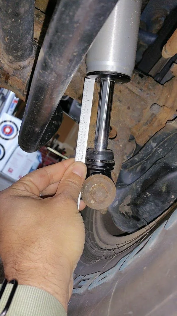

I just received my Fox Performance shocks from AutoAnything. I have Frankie's Offroad 3.5" lift so I went with the 3-4" front shocks and the 3-5" rear shocks. The front shocks are perfect. Loads of stroke with the bump stop contacting before the shock stop. The rears are a different story. The shocks are way too long. The axle droops so far the springs can fall out. With the truck sitting at ride height, I only have 3" of stroke on the shock. Bump stops need to be extended but I full expected to be able to tuck the tire more and not have so much droop. I have approximately 5 miles on the shocks and while the ride great, I am now forced to find new rear springs and possibly sell the rears shocks to buy the shorter 1.5-2.5" shocks.
I've contacted Fox about this. I am waiting to hear what they have to say.
My bumpstops are not even close to the axle.
Sitting at ride height I have 3" of stroke on the shock.
Yeah, mine seemed too long in the rear too but with your lift I would have thought it would be perfect. This was brought up in another thread and the consensus was to add a strap over the spring, welded to the perch. The shocks were not designed to hold he spring in.
I'd be surprised if you are actually getting 3.5" of lift. I am definitely lower than that and have just over 4" up travel. Bumps stops absolutely need to be lowered and steel strap to hold the springs. I bolted mine to the purchase. That is the price you pay for more downtravel, it's a good thing. With 35s on the (lowered) bumps stops you will be stuffed pretty good. With the shorter shock you would probably only get another .75" up travel before rubbing anyway.
I thought they were to long at first but love them after necessary mods.
BTW in running 860 with 1.25" spacer in the rear.
In the front I am running the long shocks and no mods were necessary, even the bump was fine.
