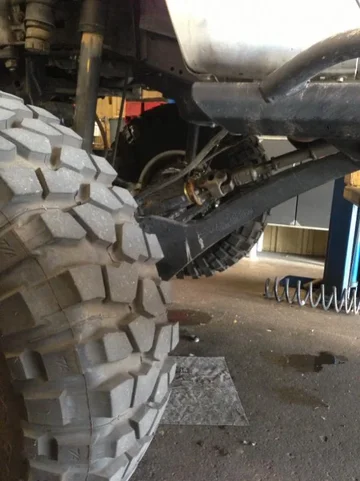

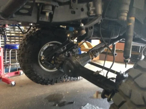

Something's bound on the front.
It's not the driveshaft, as I first thought, since it still spins, doesn't appear to be the arms, not the tie rod hitting housing (can't turn wheels, obviously) so best guess is its the steering link and pan hard.
Sound right?
yep, they are normally the limiting factor.
