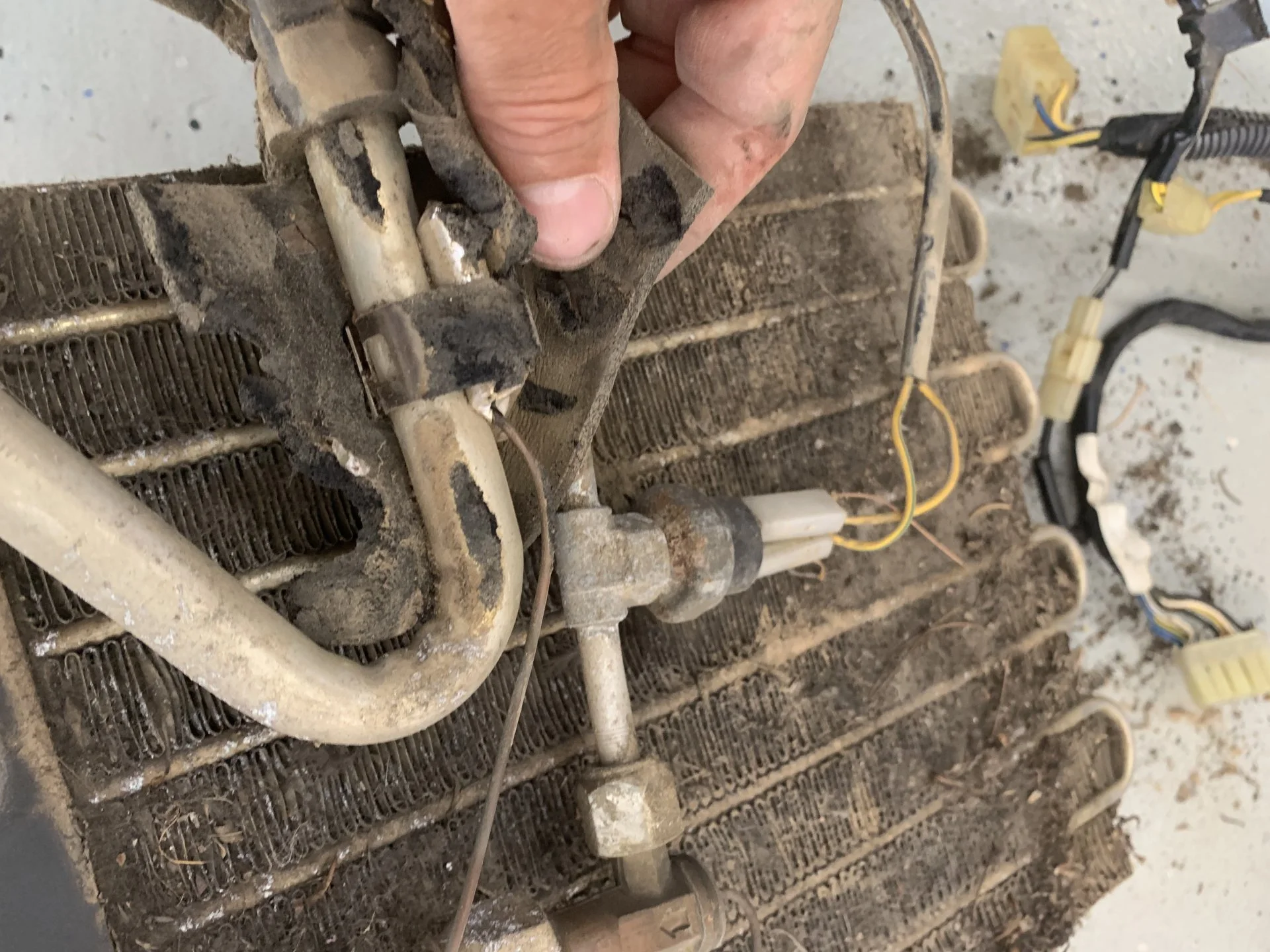

My only point is that not knowing the full history of a 30 plus year old a/c system means that if you don't fix it right the first time, there's a high likelihood of parts failing in the near future.
Of course, you could get lucky, but running 175+ psi on the high side through those old hoses can cause leaks, and there goes your labor $$ and R134A.
The green o-rings are great, but remember, there are several in the evap core you can't get to without removing the entire assemble, which is worth replacing "while in there", as is the expansion valve. The evap core is exposed to all the gunk, grime, dust and dirt and they really get quite clogged - see photo below.
