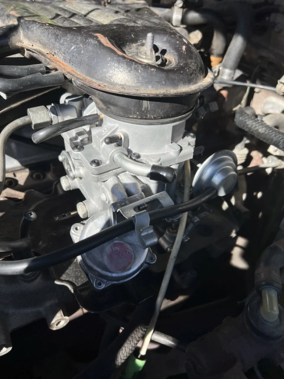

Hi all, newbie here and my first post - apologies in advance for forum learning curve. Located in St Petersburg Florida.
I recently purchased an 85 FJ60 (225kmi mostly NM and Texas driven) which was desmogged at some point by POs but sat for 2 yrs driven little.
It ran ok in test drives and very short drives after purchase. It had/has a rough idle and get worse after 20mins of driving to where it would stall at idle but at speed it had good power and acceleration. I checked the fuel filter (clean) and fuel pump (did not replace but looks newish) and gas is going to the carb.
I decided to have the carb rebuilt by Ron at Performance Carburetor in Clearwater FL. to rule out a gunked up carb. Ron said that the secondary diaphragm was in ok condition and did not replace it. Ron did replace the accelerator plunger. I reinstalled the carb which was challenge to get the linkages correct etc but I believe its installed correctly.
However now its struggles to rev past 2500rpms in neutral and drive. (The rough idle has not changed either - same symptoms but I can't test drive it due to rpm issue.)

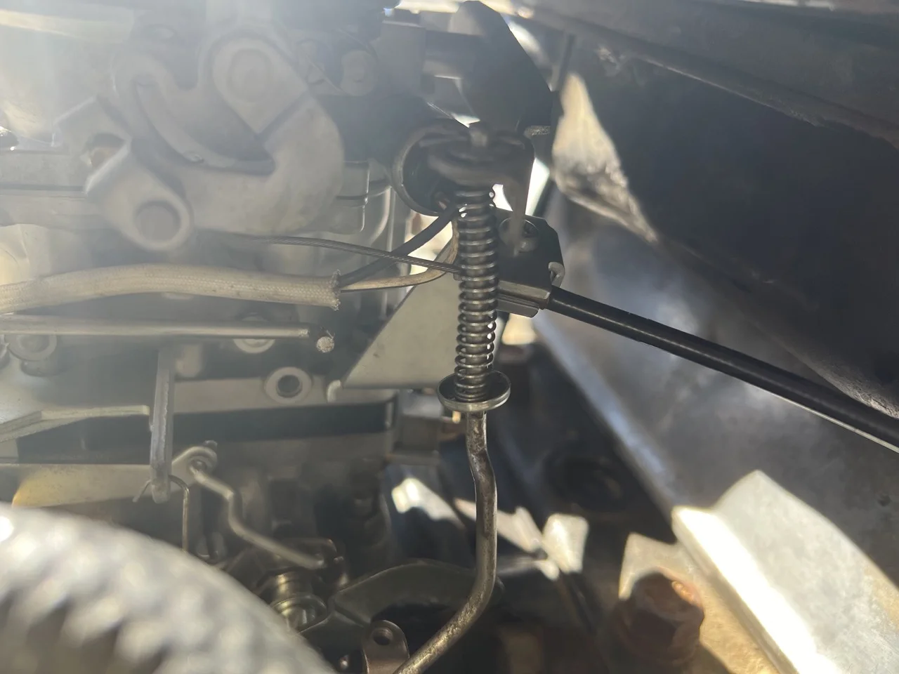

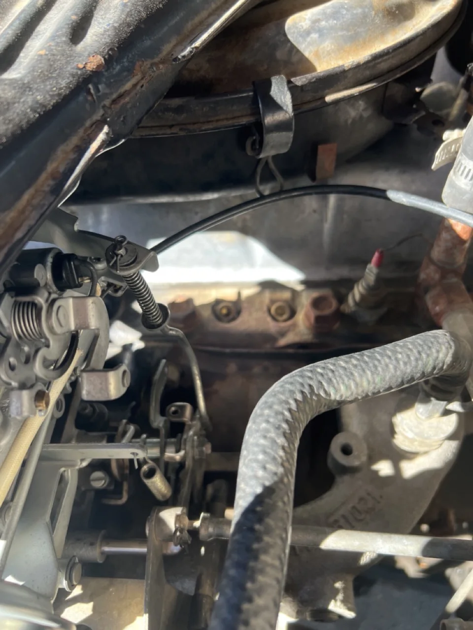

before anything, verify you have are achieving actual mechanical WOT. It is possible to swap the linkage rods with each other (they are different lengths) and only get about 60% throttle opening. Have someone depress the gas pedal while you watch (engine does not need to be running) and make sure the butterflies are fully opening

If the struggling to get over 2,500rpm started after the carb rebuild it sounds more likely the linkage may have been installed incorrectly. Also check the pedal stop bolt inside the cab (although unlikely the issue).
Rough idle in your situation shouldn’t be the carbs fault unless something was done incorrectly or it needs adjustment. To elaborate, if the rough idle was present before and after rebuild it’s probably not the carb. I will say it is interesting that the screws on the air horn are hex head black. Factory would have been JIS phillips hardware.
Another note: the wires for the fuel cut off solenoid look like they might be interfering with the throttle linkage. Factory routing ran it under the air cleaner and around to the driver front of the carb. Also make sure it is plugged in (can’t see in pics).

@cruisermatt @klinetime574 - I was thinking this too, that I reinstalled incorrectly.
re: idle solenoid circuit, I did route it the other way b/c it was hanging close to heat shield. - will put back to orgi.
Can someone post a photo of how the carb linkages should look?

This link has some pics and helped me diagnose my rig. To this day I don’t know how the rods got switched (maybe someone messed with it when it got painted but it wasn’t me). It was like night and day once fixed. However I didn’t have any of the other issues you are having nor the decel backfire. I would keep looking for a exhaust leak and vacuum leak once you verify correct rod positions.
