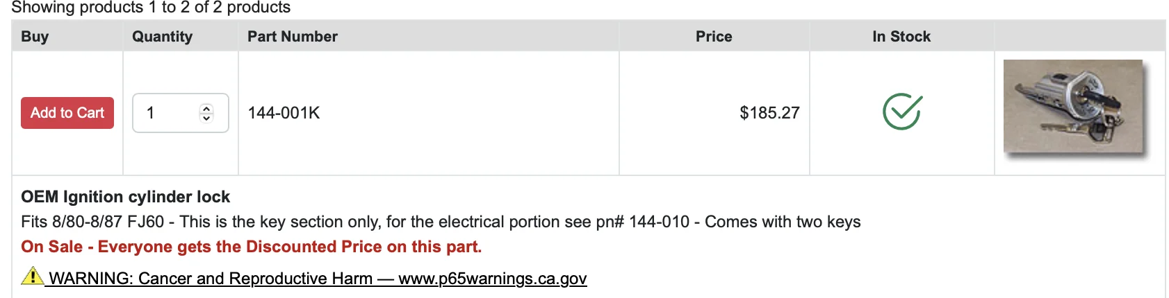

Where did you all get a new tumbler from? I am looking for a new tumbler and key for my 1983 FJ60
The Toyota one is no longer available, there are plenty of aftermarket available. Try RockAuto.
If you want a Toyota OE, www.vintageteqparts.com has them
Thank you for the reply Spike. After I checked this thread I looked on Specter Off Road. I was able to score an OEM lock cylinder with 2 keys and a key ID tag for around $200. Should be here this week!
Any of those aftermarket ignition locks, with the Grant Moore key are all from the same Taiwanese factory. They're not as polished as the OE ones, but they're fine.
